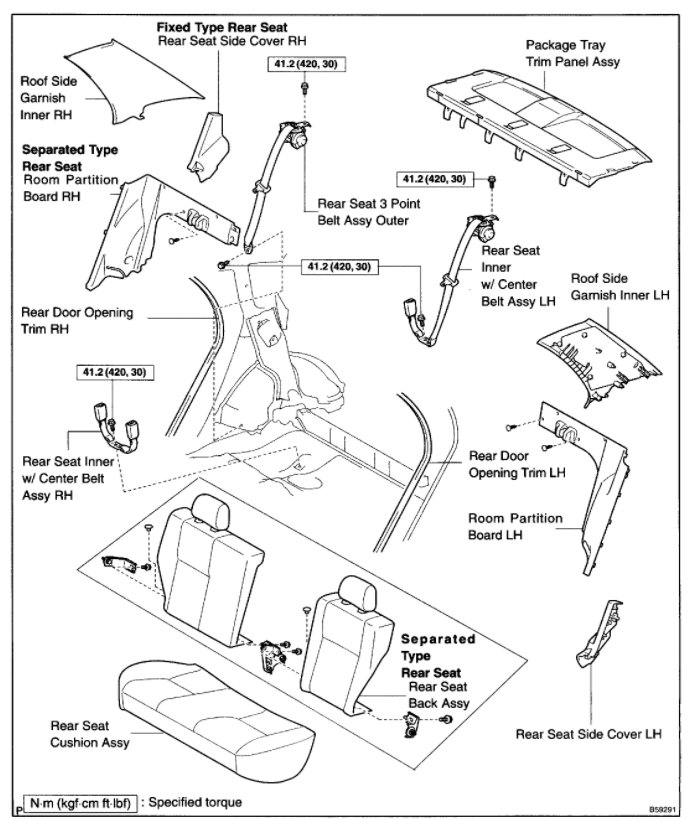

You are saying you have the actual buckle for the side and middle but not the buckle for the other side? The belts are there for all three but the buckle for that seat is missing? If that is the case then yes you should have 3. I show three on the attachment as well so someone must have removed it at some point.
Have you remove the rear seat cushion just to make sure it did not fall under the seat? Also, have you owned the vehicle since new or do you remember it being there?

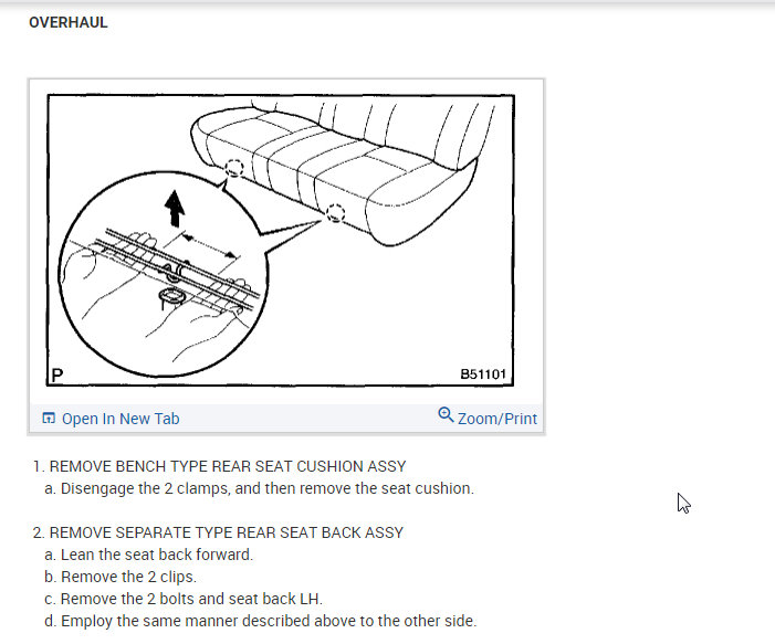

Nope. Pretty easy. You should be able to just yank up on the front of the seat cushion and it will pop the two clips loose. Take a look at this attachment. May want to wear some gloves because if that has never been off, you will have 15 years of "stuff" under there.
