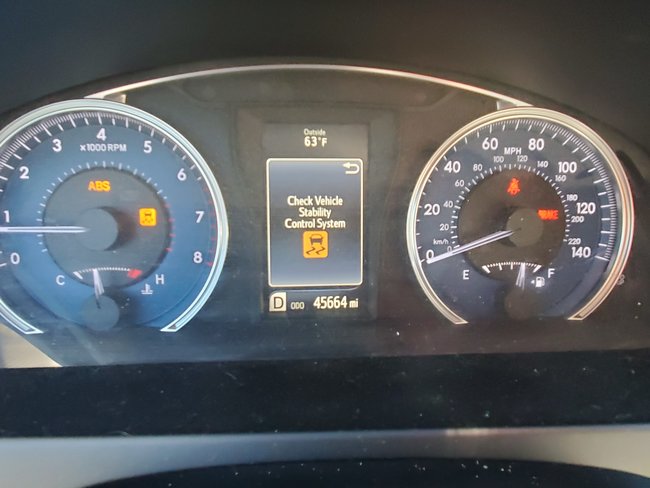

I feel a grinding when I brake sometimes not often. I have taken it to Toyota and they never had it happen while they drove it. only thing they found was the computer wasn't communicating properly. Could that be a reason why these lights come on?
Jul 7, 2020 at 1:31 AM
Good afternoon,
There is a fault in the ABS system. That fault has set a code and I need the code that is stored. The most likely failure are the wheel speed sensor but needs to be confirmed.

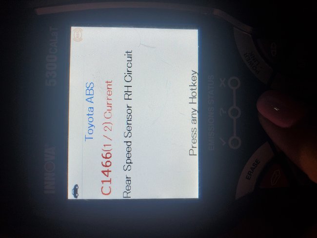

This is what popped up.
Jul 15, 2020 at 3:20 PM
NIGHT.NYX
This was both codes.
Jul 15, 2020 at 3:21 PM
This is for the rear ABS sensors. It indicates the right side but it could be the left as well.
I would replace both. You could check each one individually with a ohm meter. You disconnect the sensor and measure the resistance of the sensor. It should be 800-1600 ohms.

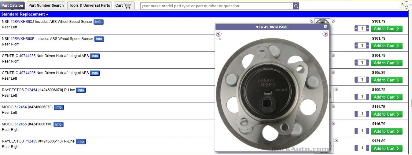

If the sensor rotor needs to be replaced, replace the rear axle hub and bearing assembly.
The rear speed sensor is a component of the rear axle hub and bearing assembly. If the rear speed sensor malfunctions, replace the rear axle hub and bearing assembly.

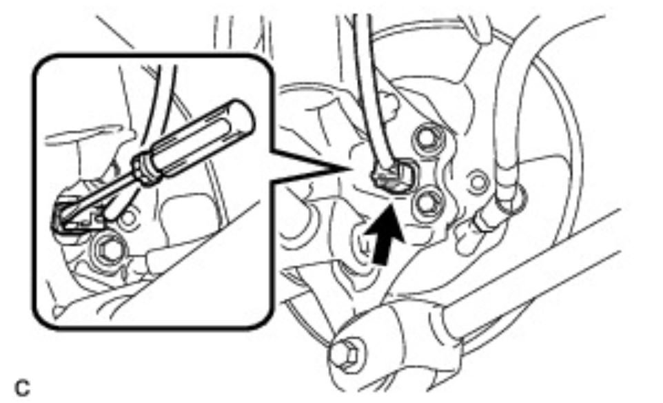

Disconnect skid control sensor wire
Using a screwdriver, disconnect the connector from the rear speed sensor.
Notice:
Be careful not to damage the rear speed sensor.

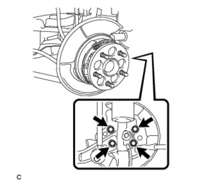

Remove rear axle hub and bearing assembly
Remove the 4 bolts and the rear axle hub and bearing assembly from the rear axle carrier sub-assembly.
Notice:
Use wire or an equivalent tool to keep the parking brake assembly from hanging down by the parking brake cable assembly.
