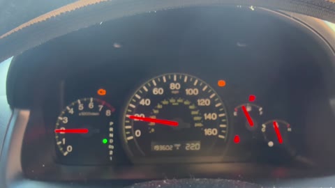

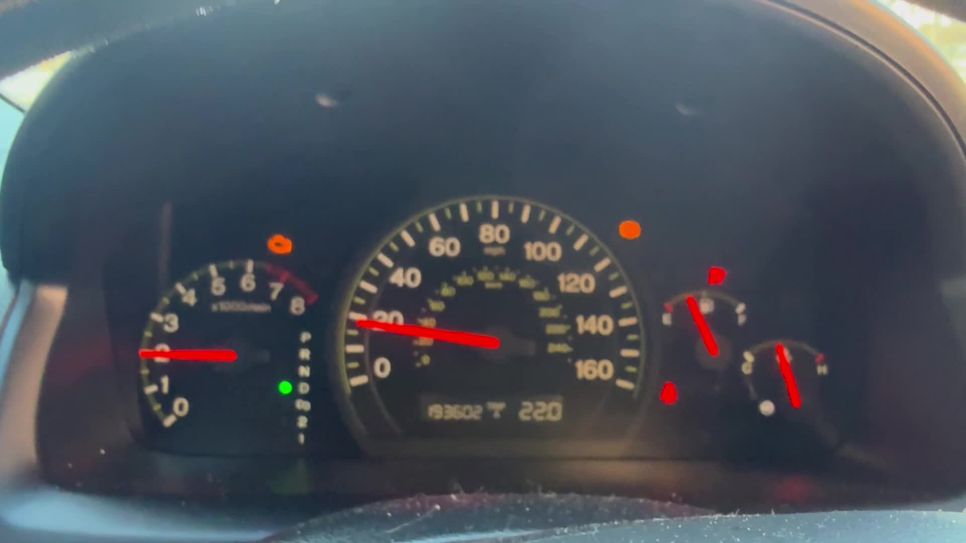

Why did my car pop up with this maintenance required?
2003 HONDA ACCORD
193,000 MILES • 2.4L • 4 CYL • 2WD • AUTOMATIC
MAKAILA ROSE
  • 16 POSTS
My car popped up with this. Why could it be? My oil? It has done it before for it but never repeatedly. It flashed like this a few times.
Mar 27, 2025 at 7:47 AM
  • 55,433 POSTS
Thanks for the video. this looks like the cluster is going bad. It could be a bad ground or faulty power supply but most of the time the cluster is at fault. I would remove the cluster, and have it checked, you can find a company that does this by searching google or eBay.
