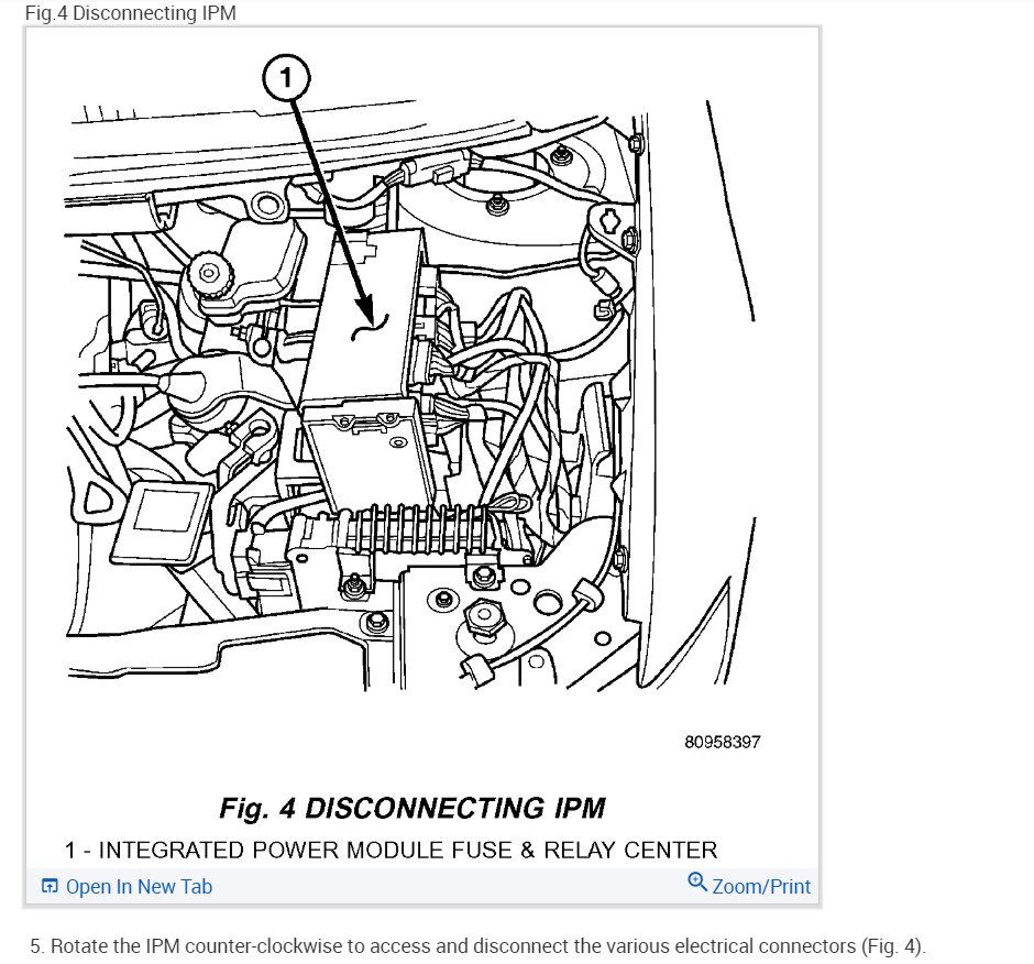

Electrical system (doors, radio, heater etc) working intermittently
2003 CHRYSLER TOWN AND COUNTRY
130,000 MILES
CATHERINE HEWITT-LONG
Random glitches ( windows, radio, locks etc). Sometimes they work. What works changes daily. What would cause this?
Apr 21, 2020 at 2:51 AM
  • 55,433 POSTS

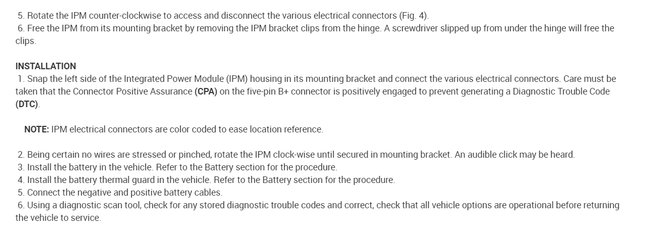

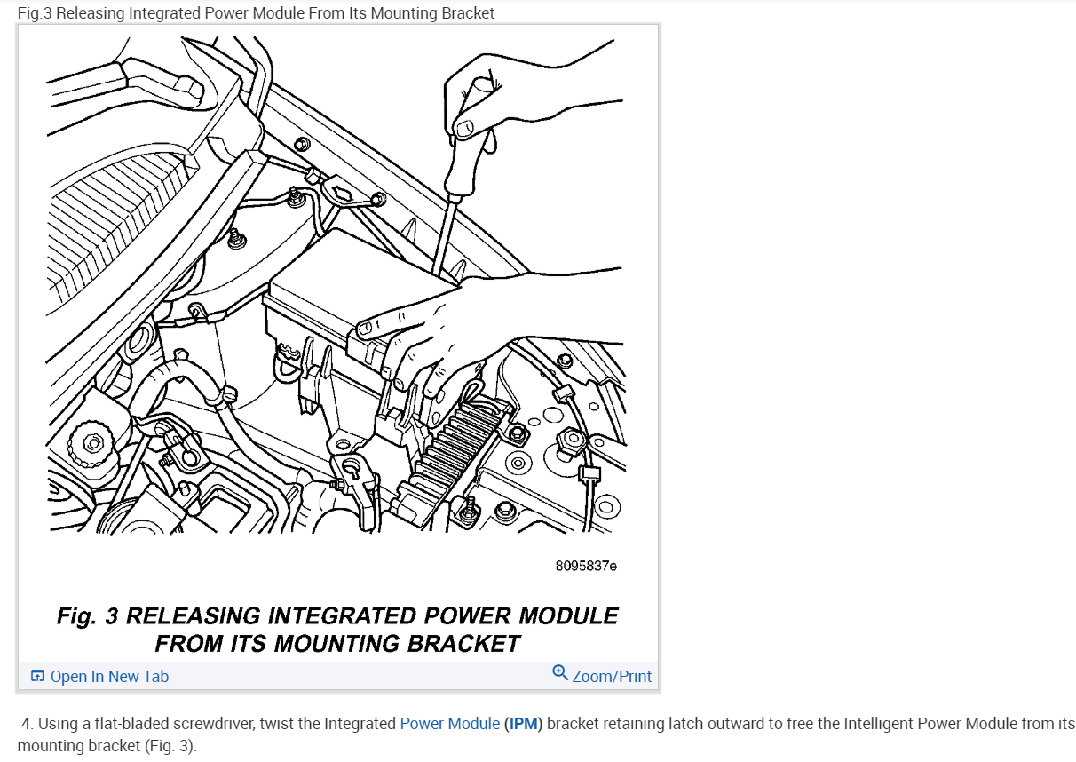

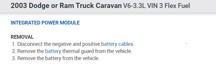

This is common when the TIPM goes out. it is easy to replace because it self initializes. here is the instructions in the diagrams below on its location and how to replace it. Check out the diagrams (below). Please let us know what happens.
Apr 21, 2020 at 5:29 AM
STEVE W.
  • 15,350 POSTS
As Ken said it is likely the TIPM. AKA the smart fuse box. What you can try before replacing it would be to remove it and check the connections on it for corrosion or other damage. Clean any you find off and apply a light coat of dielectric grease and reinstall it. Test it and see if it now works.
