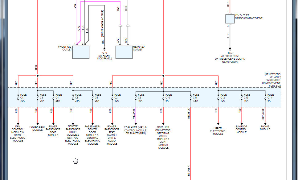

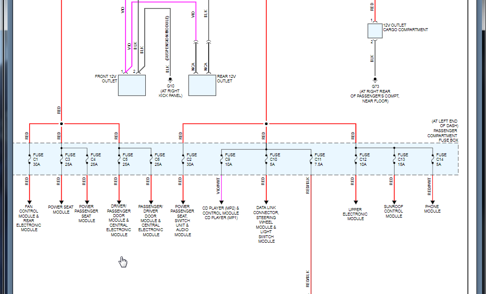

I had a local mechanic replace sunroof and windshield arrive to no digital or electronic power in side the dash, no gauges work or lights except the check engine light. other than the wipers constantly going no windows radio, A/C, interior lights etc., no power at all. car just runs exterior lights are locked on auto mode. exterior signal lights good. can't hear or see inside. help please. what did he do wrong??
Oct 31, 2020 at 3:08 PM
Let's go to the fuse box inside the dash on the driver side. Let's use a test light to check for power on all the fuses when the engine is running.
I suspect he either blew a fuse or damaged some wiring. However, we need to find out if we have power on these fuses and go from there. Thanks
