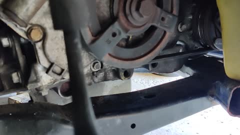

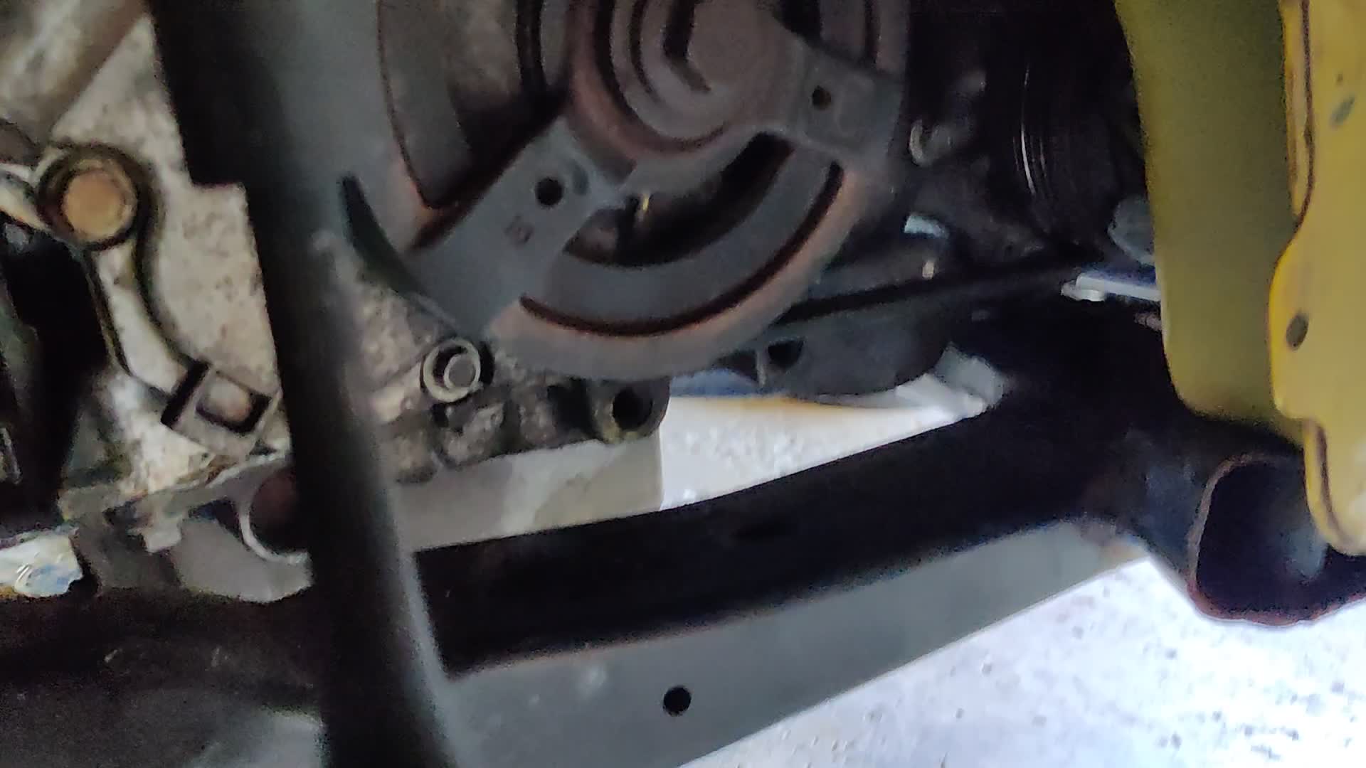

Whittling noise and will not start
2007 CHEVROLET COBALT
187,000 MILES • 2.2L • 4 CYL • 2WD • AUTOMATIC
JEFF MITCHELL
So I had the timing chain and all timing tensioners and timing gears , seals, gaskets,and sensors replaced. now when go to start car all it does is crank. the pulleys all turn with the serpentine belt, I have spark however it will not start. also had starter tested, it tested okay.

Good afternoon,
Why did you replace the belt?
https://www.2carpros.com/articles/how-a-timing-belt-works
It sounds like there is no compression. You need to test the compression.
I attached a YouTube video for you to view of the procedure.
https://www.youtube.com/watch?v=FR6yqvByUzg
