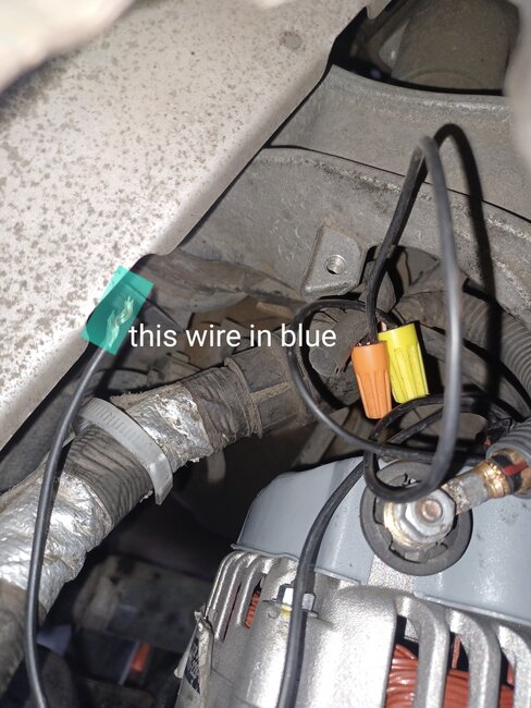

Hi, I had to replace the alternator. But the connector was damaged so I had to replace it, I sort of connect the wires except one that I can't find; it is a white that connects to the fuse, but I can't find it.

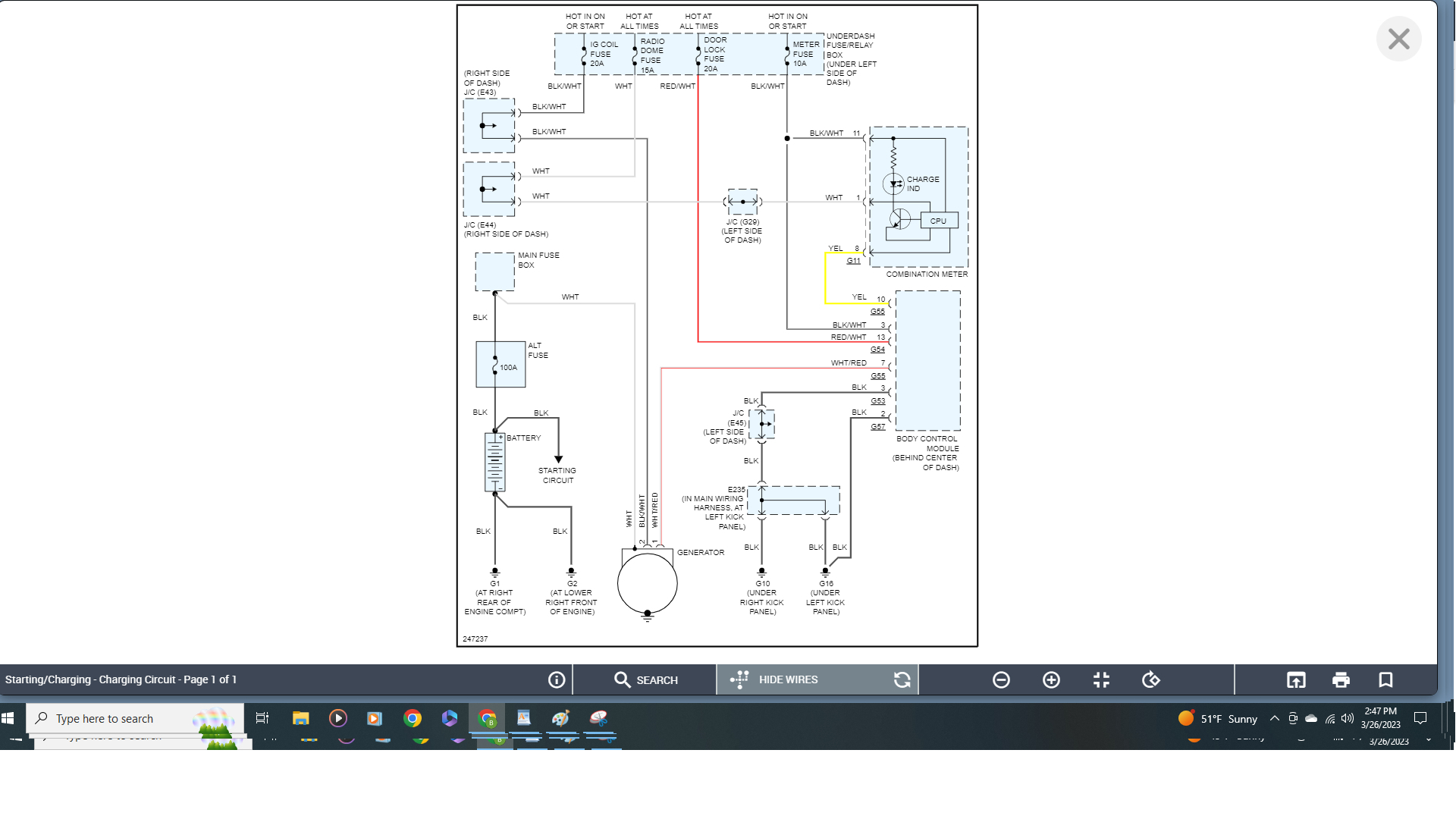

What color is the heavy gauge wire that is bolted to the alternator? The fuse the white wire goes to is a 100-amp fuse. It won't be a thin wire. If you go back to the main fuse box, can you locate the white wire?
