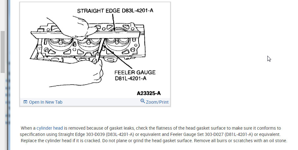

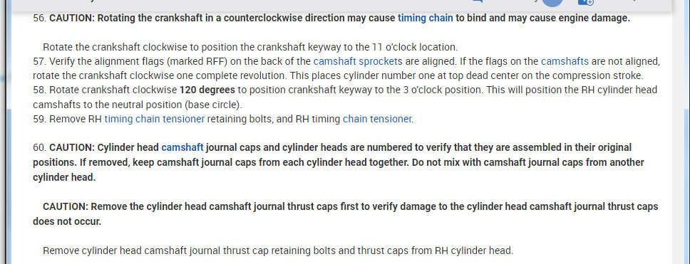

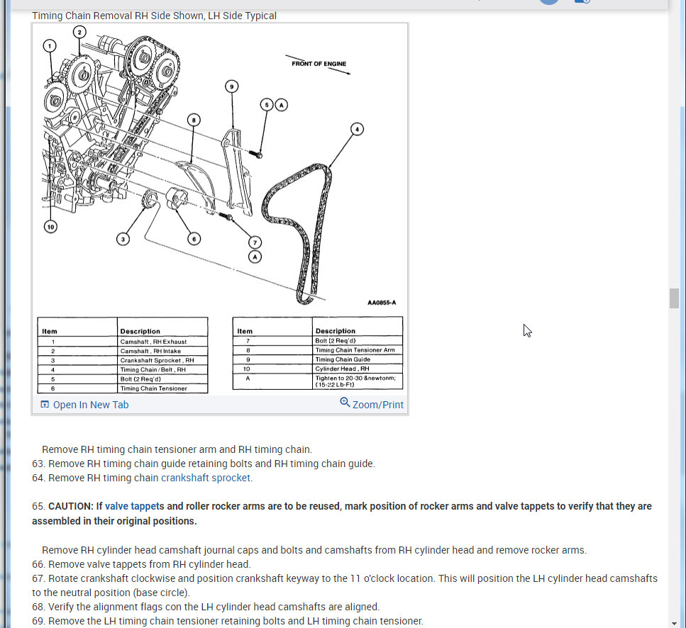

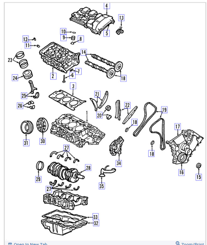

Unfortunately then that points pretty much only to a head gasket or warped head. I attached more info for this as well.
This info is for the DOHC motor as that is the more common engine but clearly this is not a fun job to do. Let us know if you need more info. Thanks

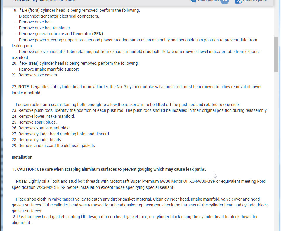

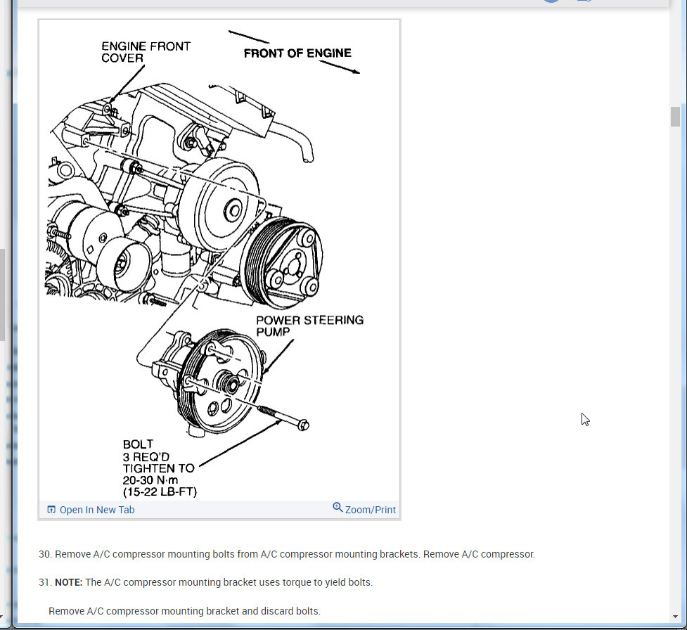

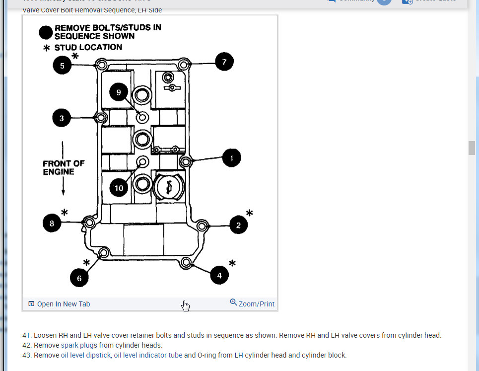

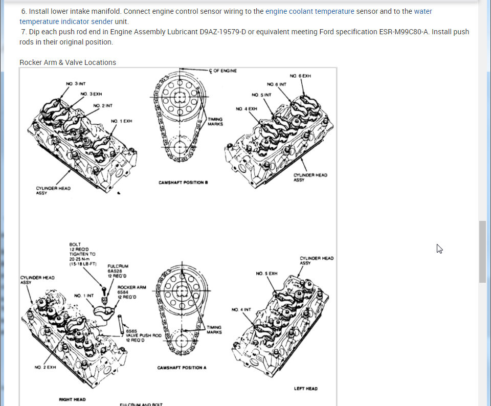

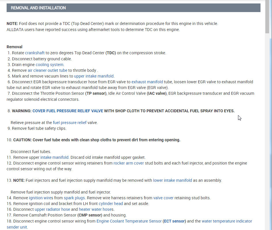

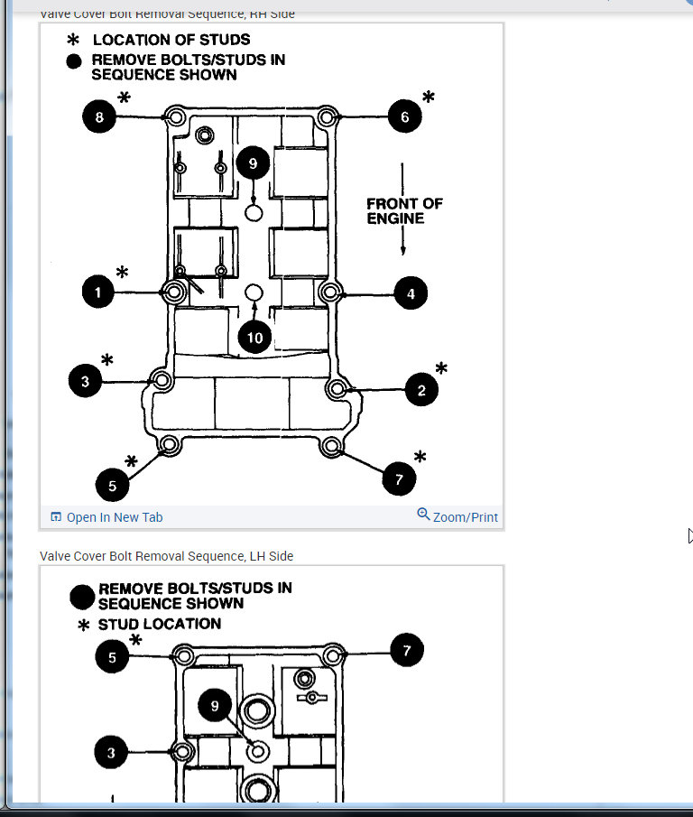

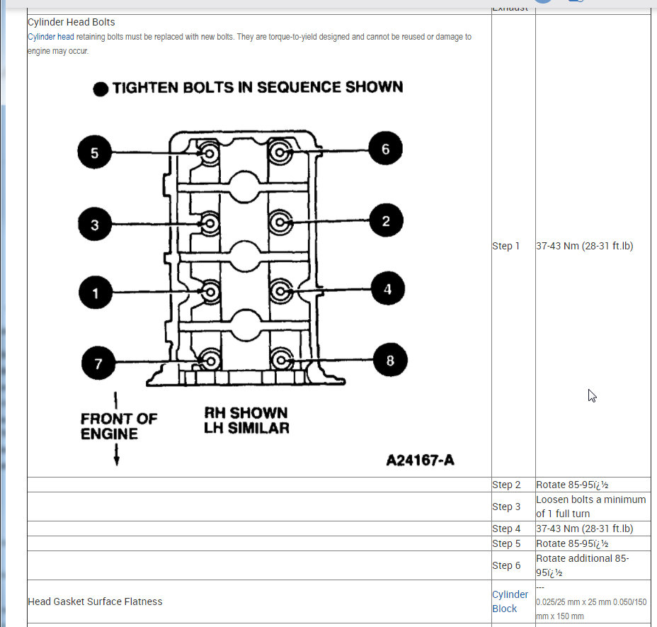

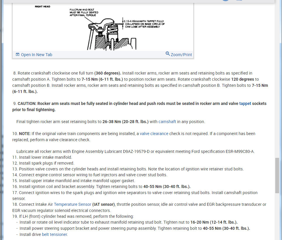

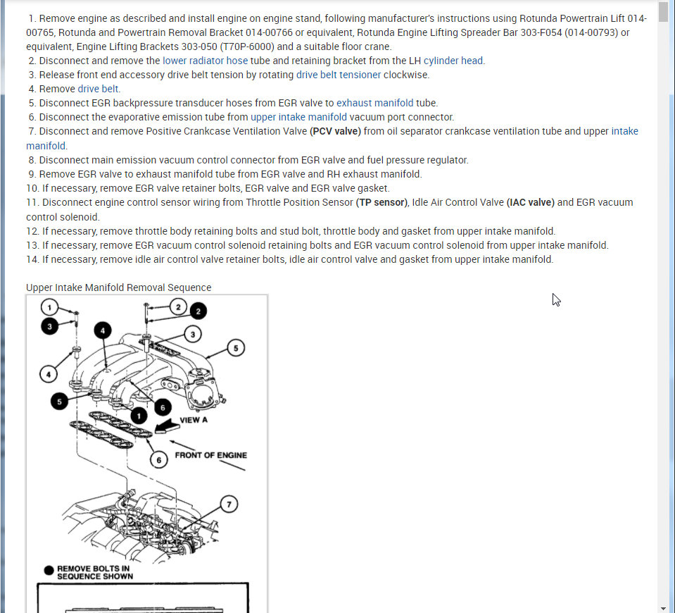

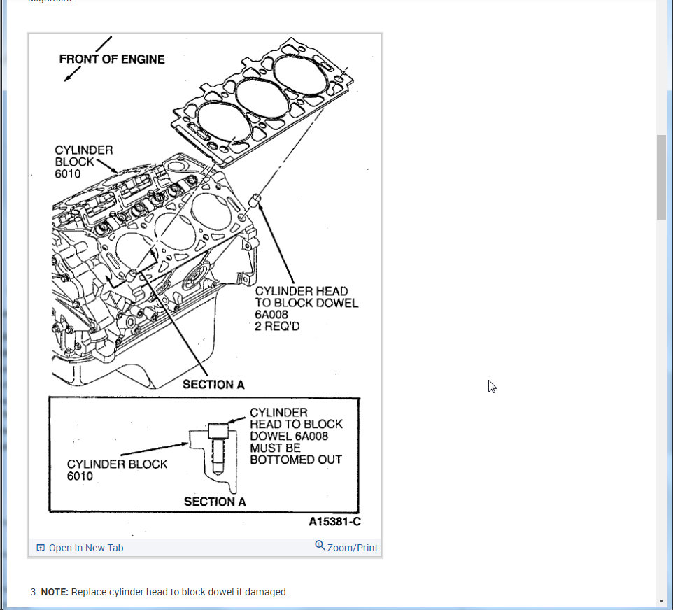

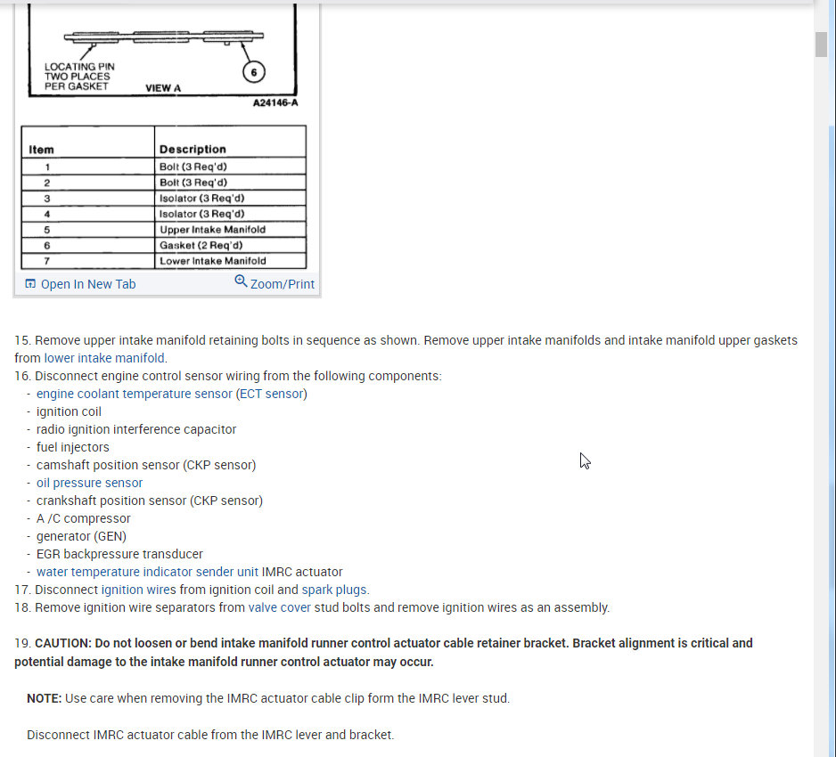

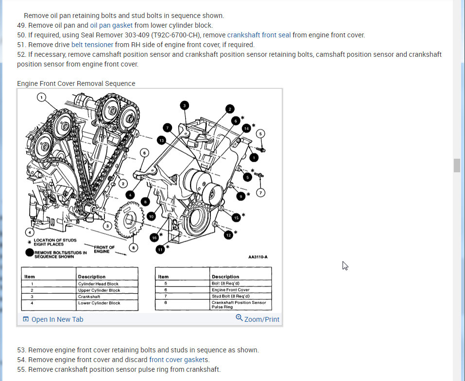

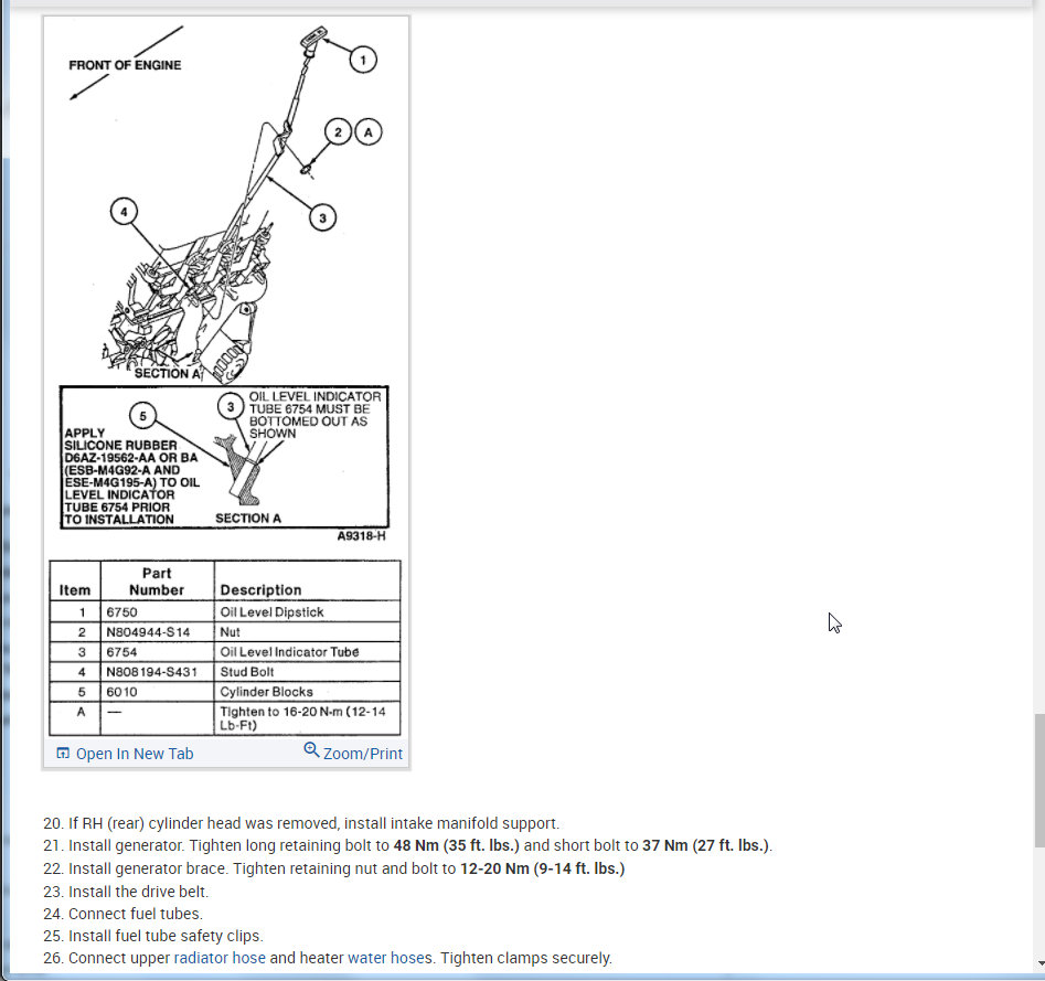

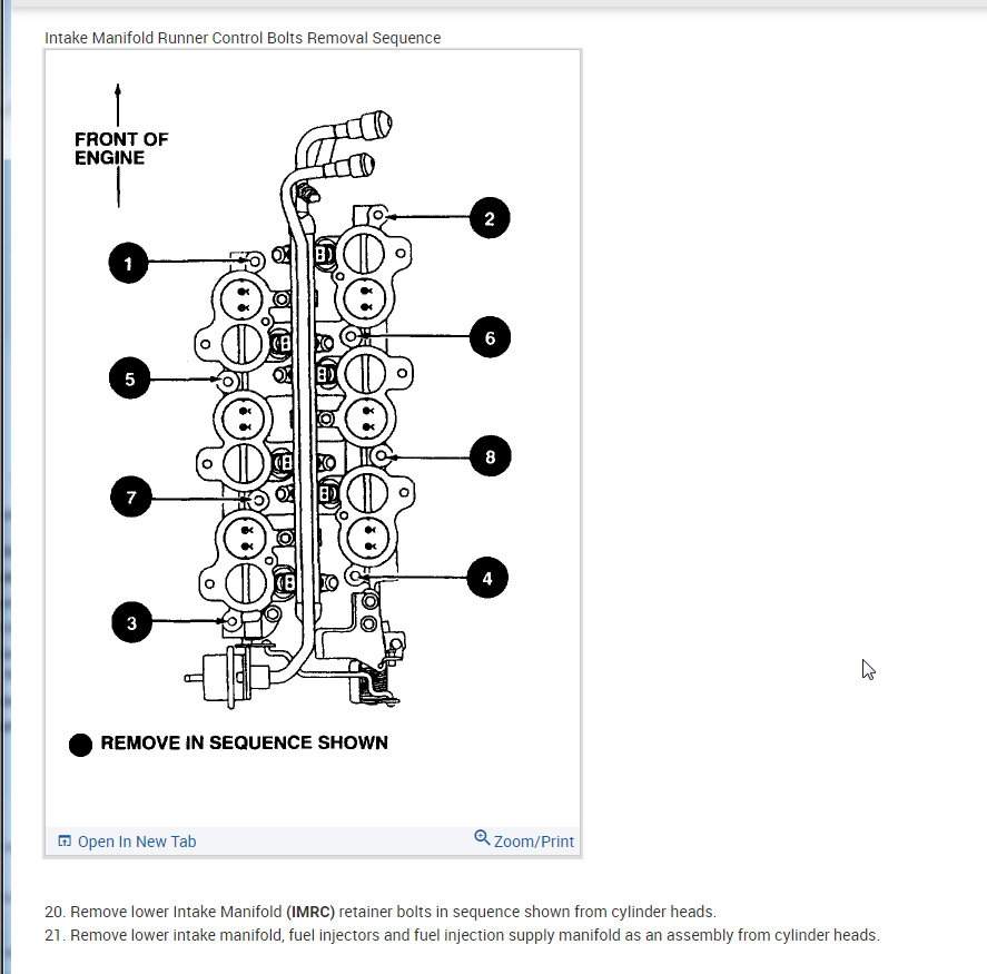

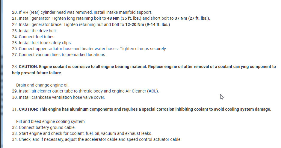

Of course you have the other engine from what I provided. :)

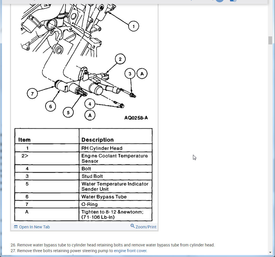

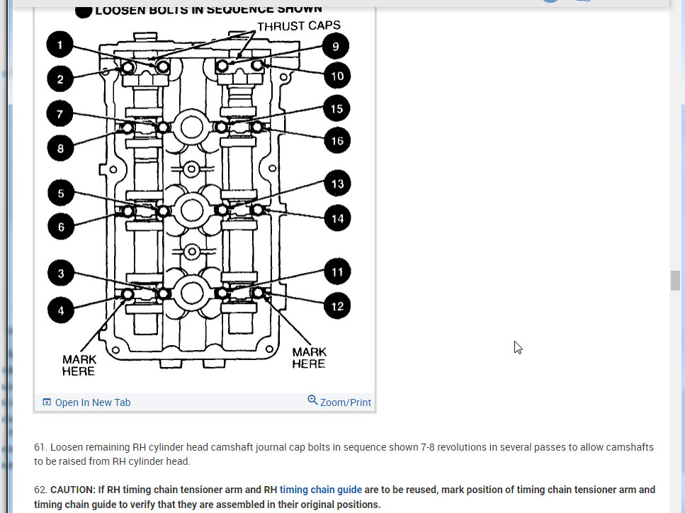

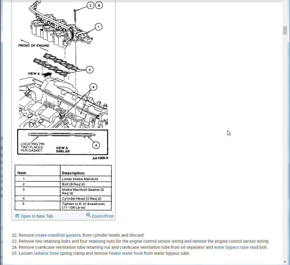

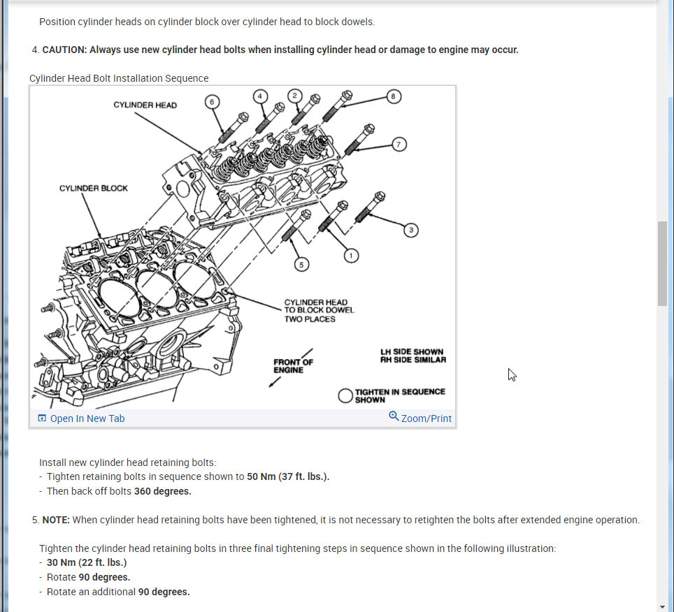

Below is the process for removing the heads.
