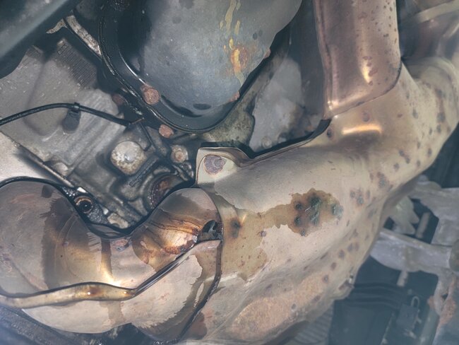

Oil probably needs to be changed; it is scheduled for 193,000 miles.
Burnt smell and eventually smoking from under the hood. The smell was seemingly oil and rubber. It looked white in color so that is odd to me for with the smell. No bubbling or foaming in radiator. Thoughts? I can't get out to look at it until the morning.
Looking for engine diagrams. Location; Front driver's side with coolant system.

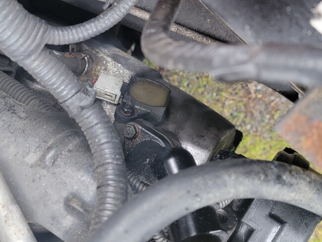

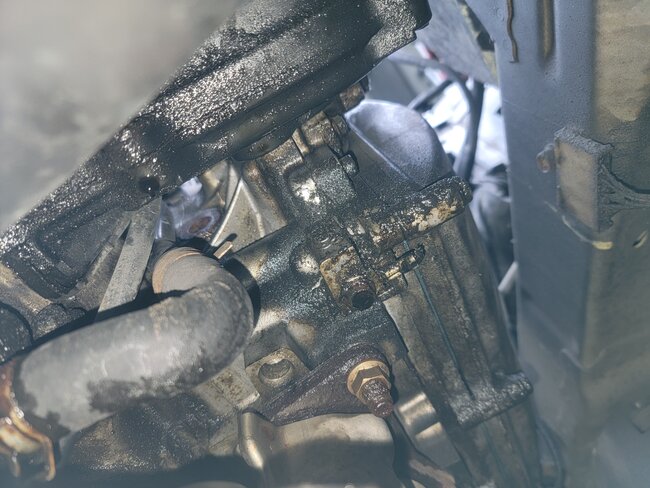

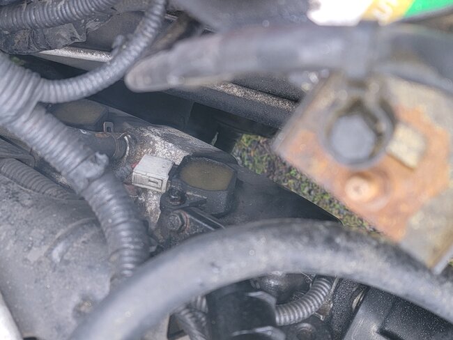

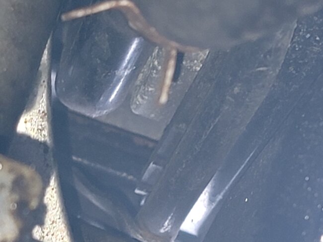

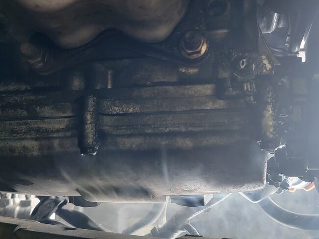

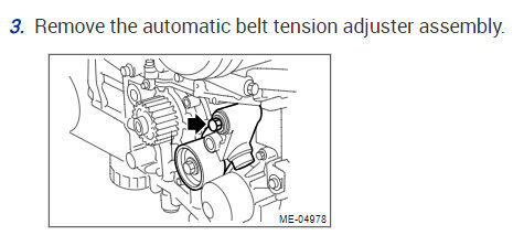

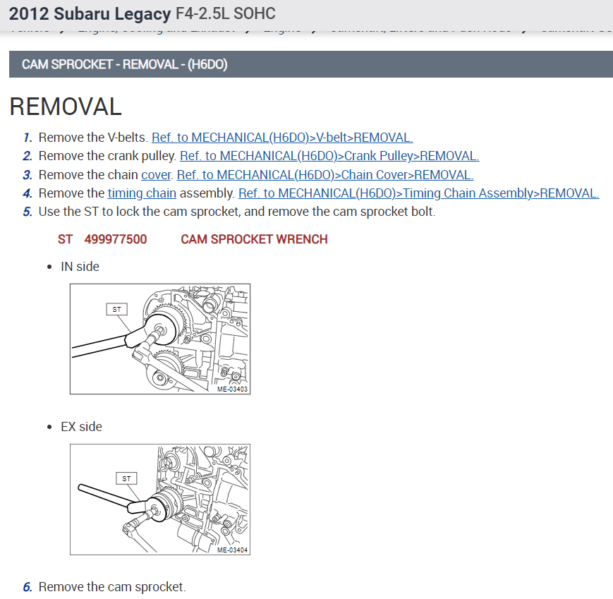

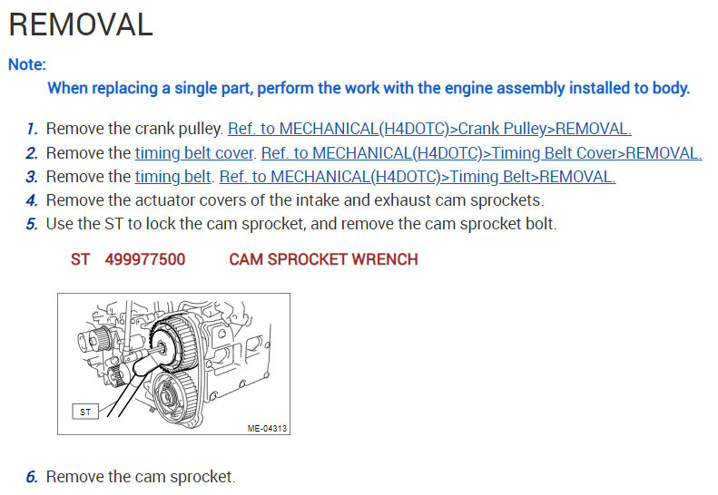

Good morning. Have daylight again. No codes to pull. Please take a look at the pictures and provide any insights. I turned the car on, and it took about 45 sec for smoke and burning smell. Couldn't get a great look so i jacked it from the driver's side to take a look from underneath. Oil dripping on exhaust from the look. Without an engine diagram I am not sure the part that is leaking the smoke as I am not very familiar with this 2.5 boxer engine. But it is clearly coming out of the right side (driver) of the engine block. Thanks for the help.
Jan 4, 2024 at 2:28 AM
  • 55,746 POSTS

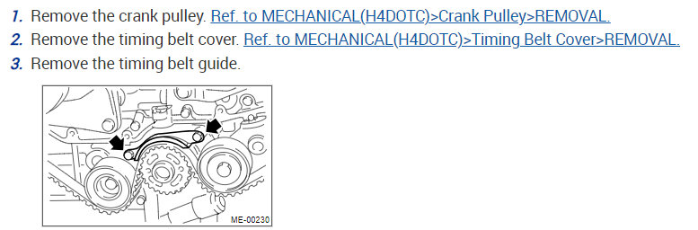

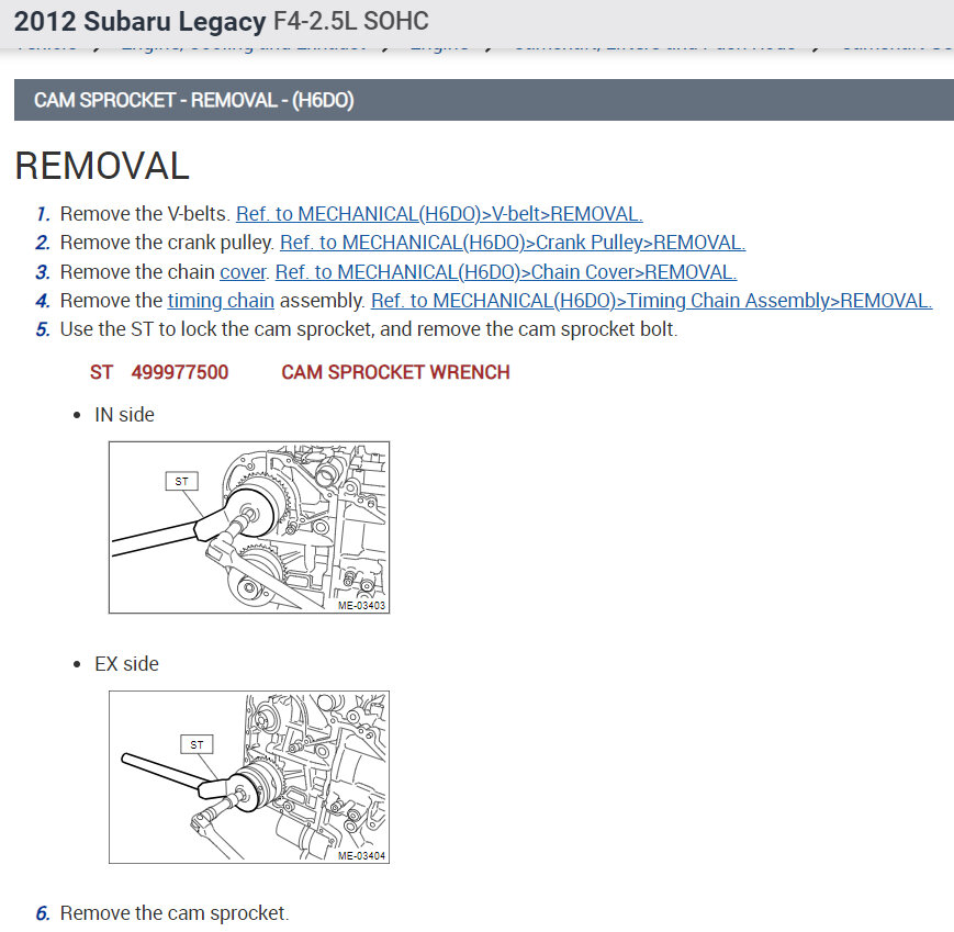

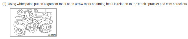

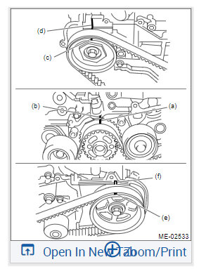

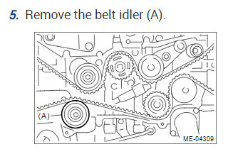

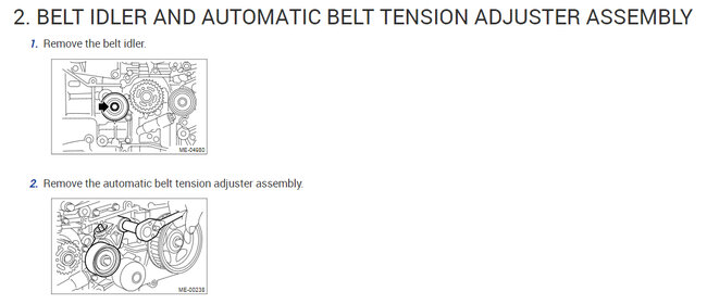

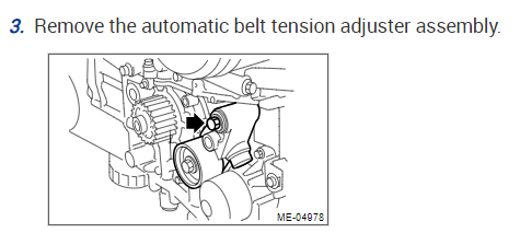

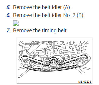

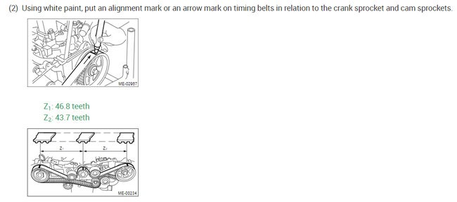

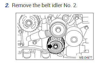

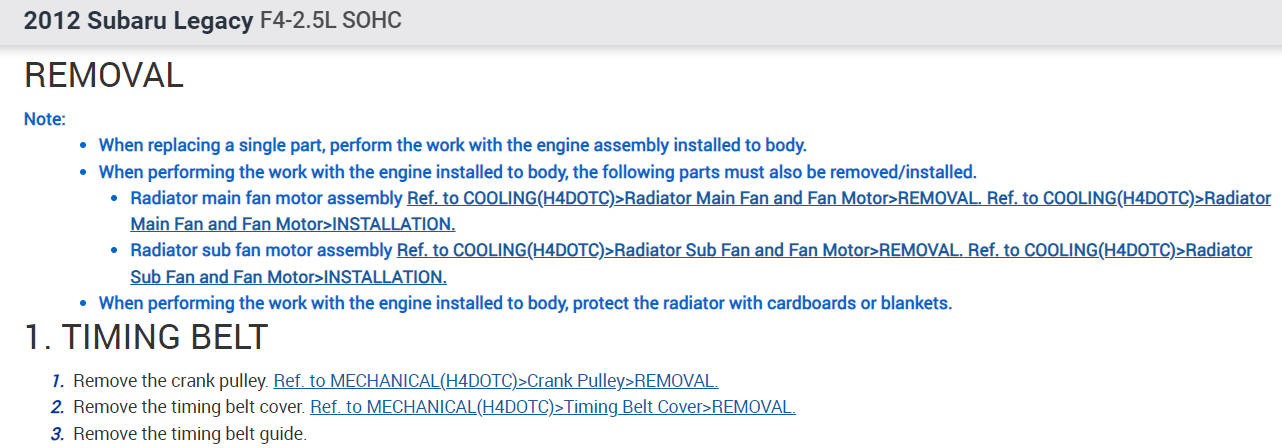

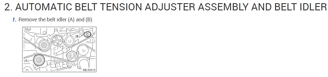

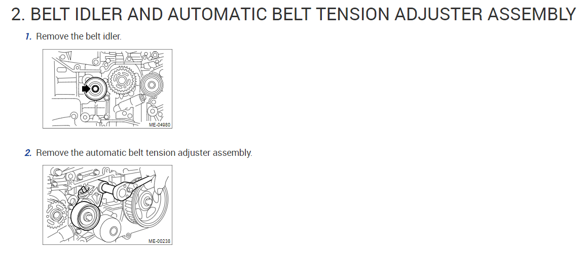

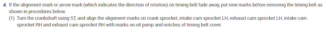

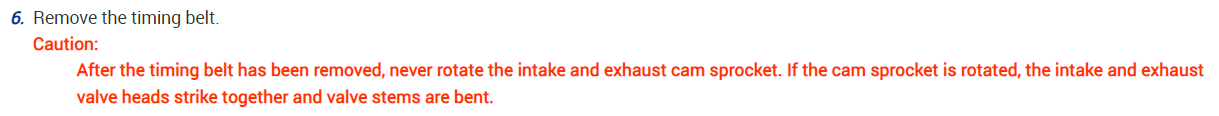

Thanks for the images. The white smoke and rubber smell will be oil leaking, from what I can tell it looks like the camshaft seals are leaking but I would check the valve cover gaskets as well.
This guide can help us understand the oil leaks:
https://www.2carpros.com/articles/engine-is-leaking-oil
I also have included how to change out the camshaft seals which you should do a timing belt as well. I have included both signal and dual overhead camshaft designs. Check out the images (below). Let us know how it goes.
