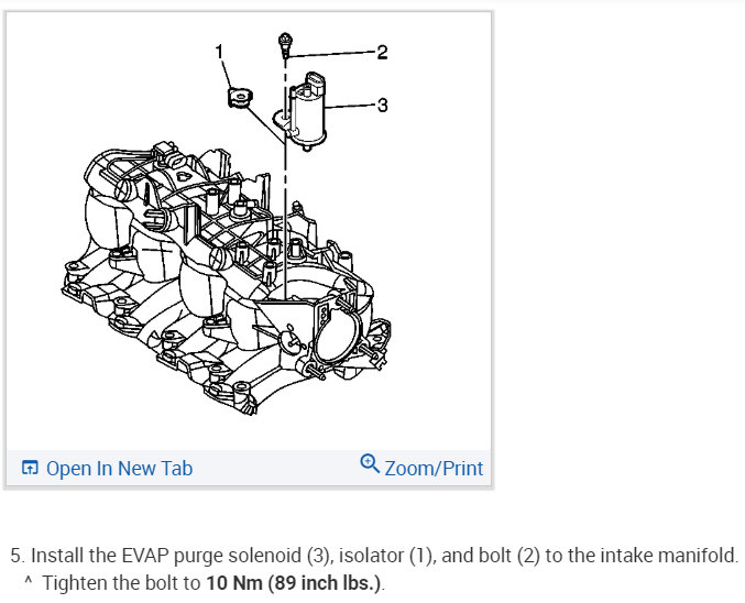

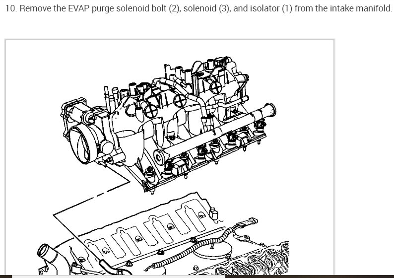

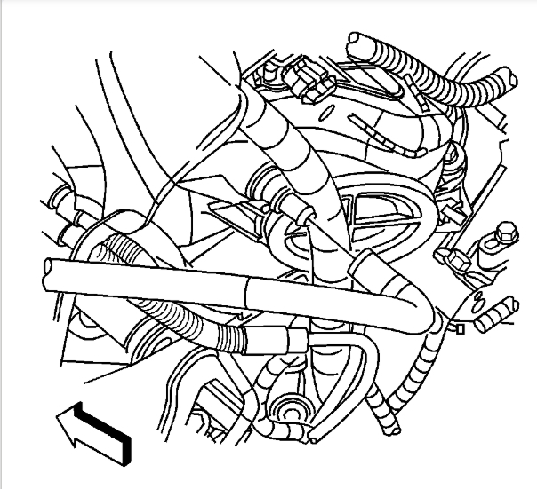

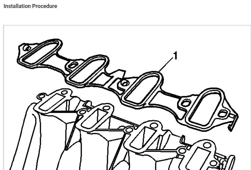

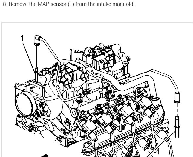

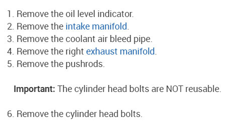

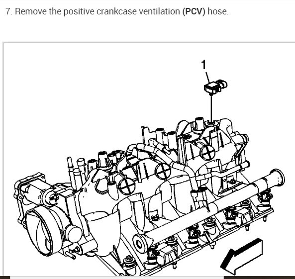

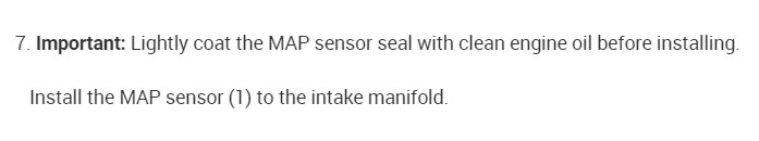

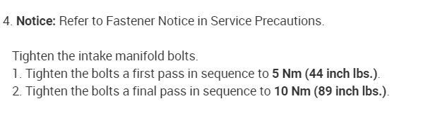

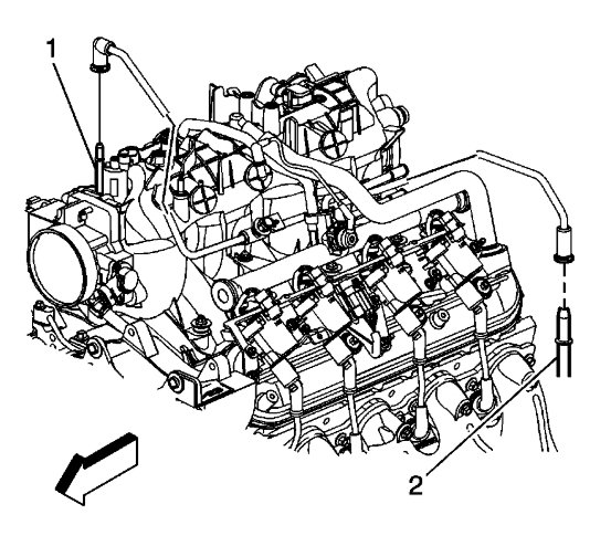

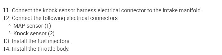

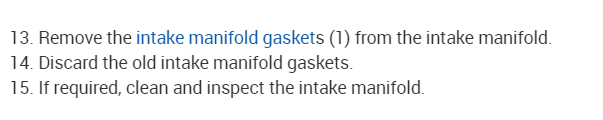

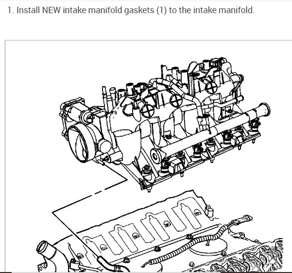

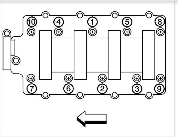

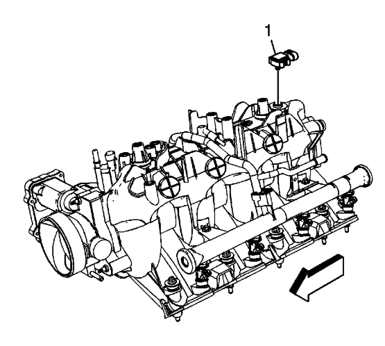

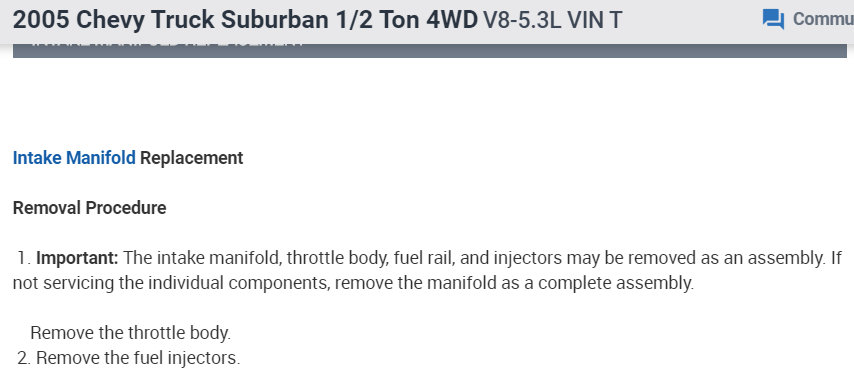

DANNY L
  • 5,648 POSTS
Hello again.

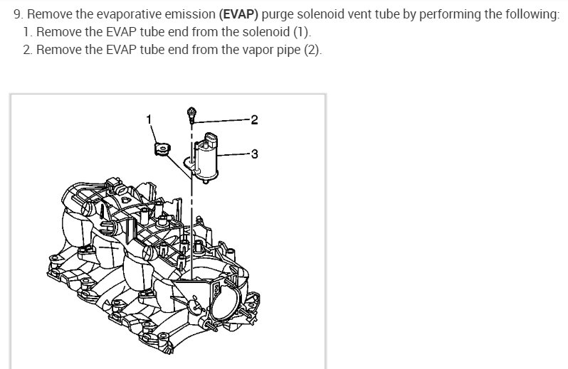

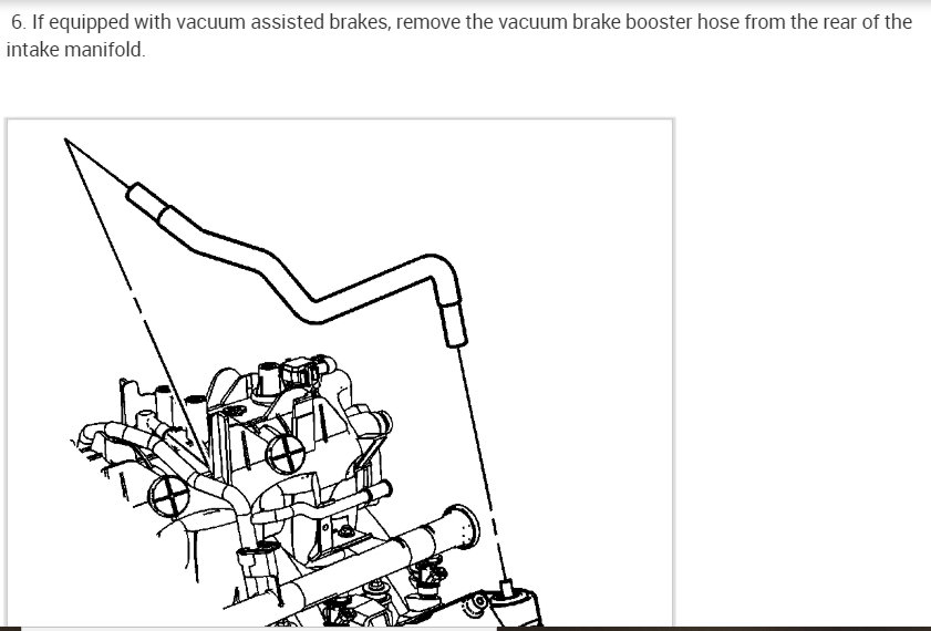

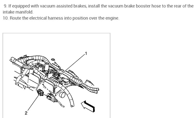

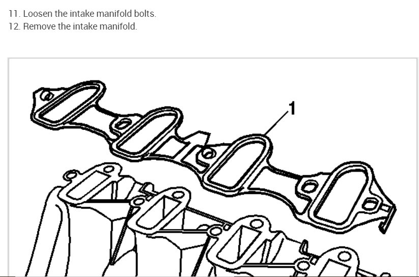

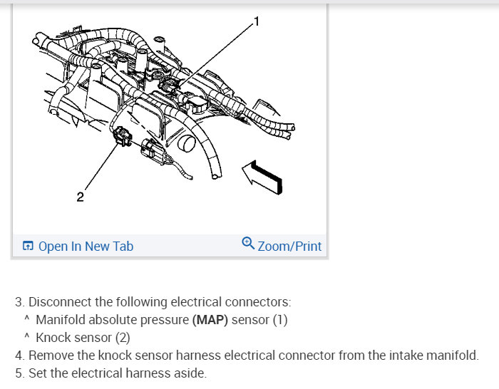

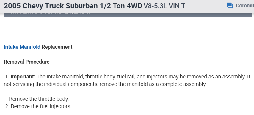

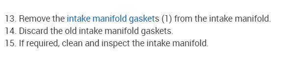

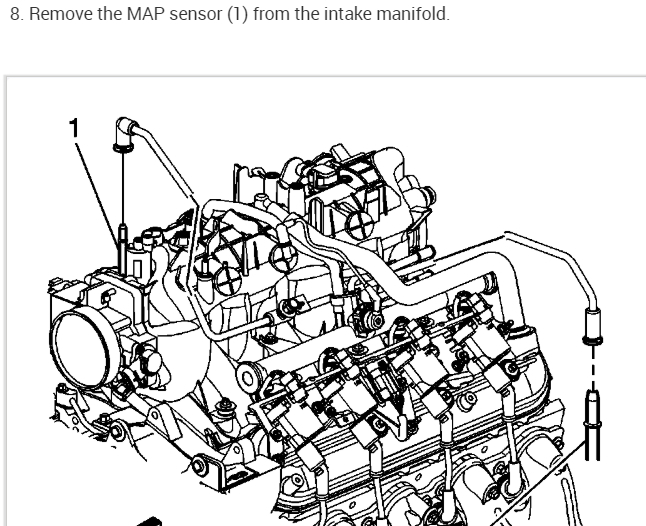

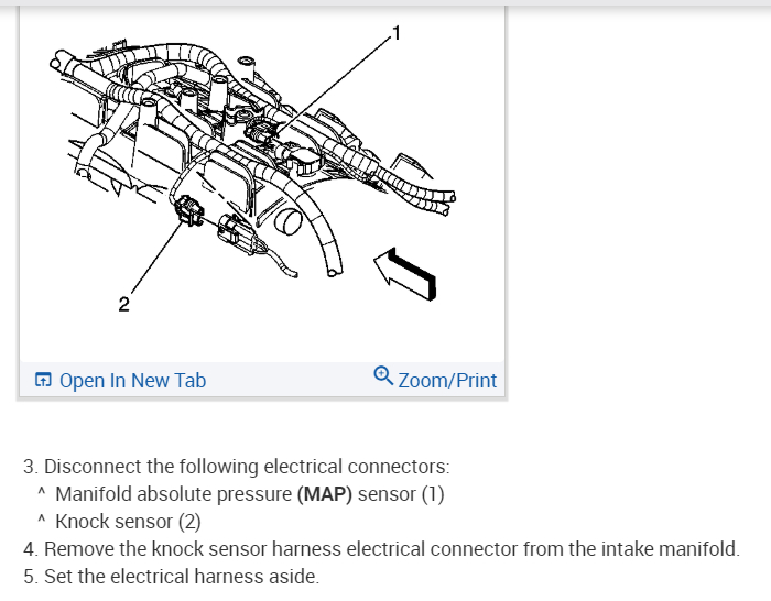

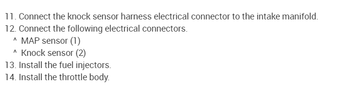

Here is part 1. I've attached picture steps below for removal and install of the intake manifold below.Here is a tutorial showing how to replace intake manifold gaskets:
https://www.2carpros.com/articles/replace-intake-manifold-gasket
Hope this helps and thanks again for using 2CarPros.

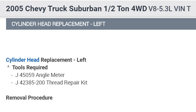

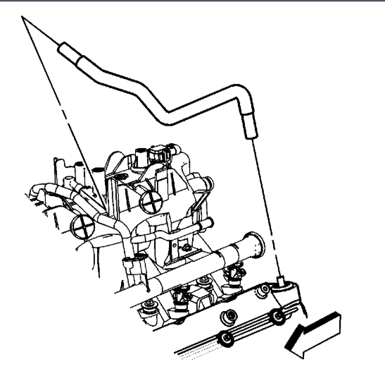

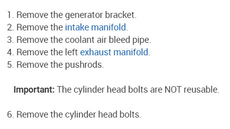

Jun 7, 2020 at 4:35 PM

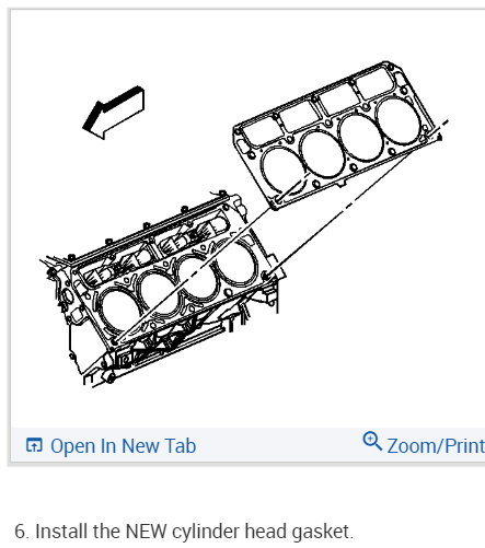

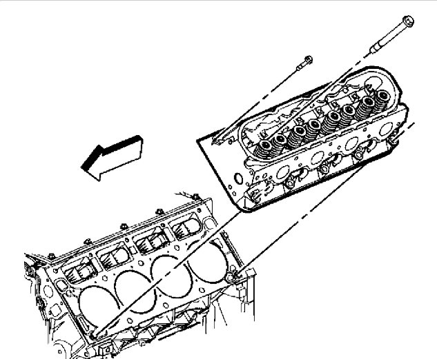

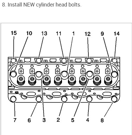

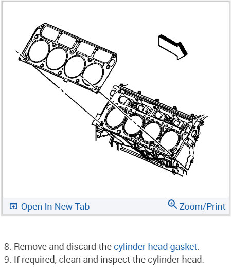

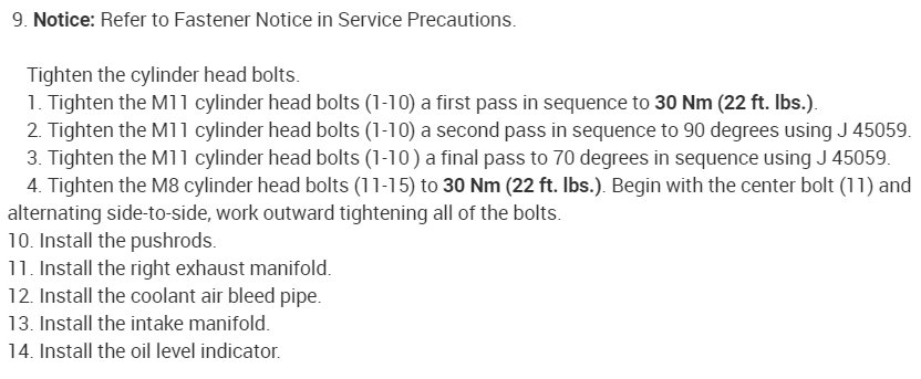

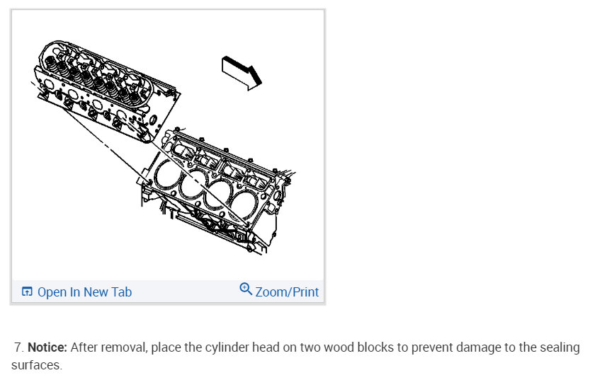

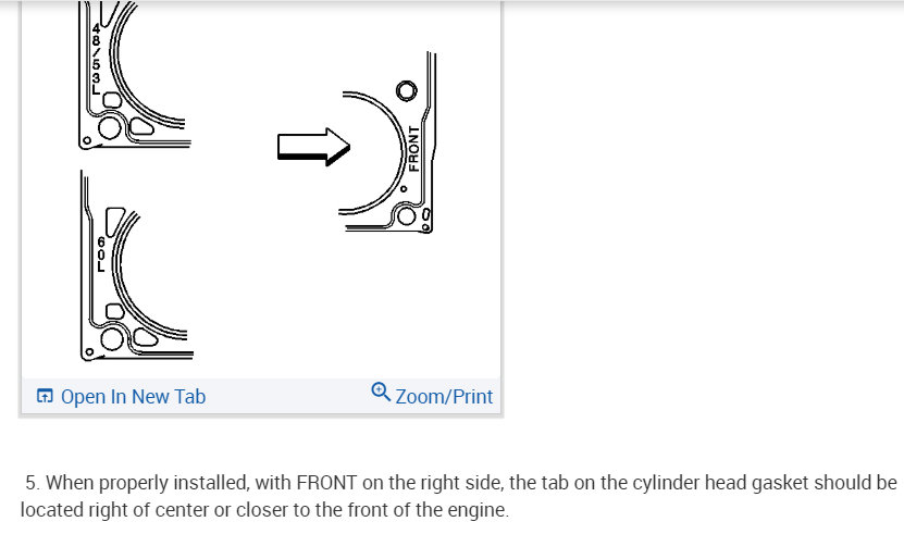

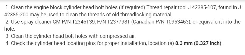

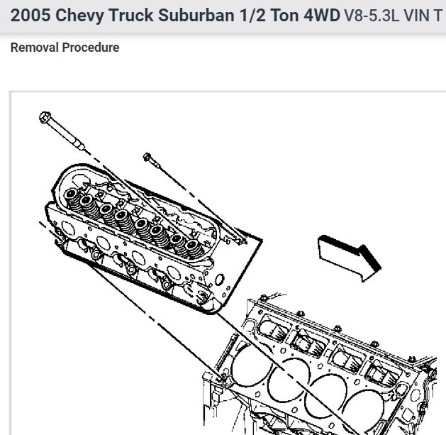

DANNY L
  • 5,648 POSTS
Hello again.

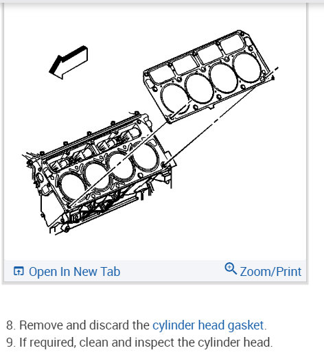

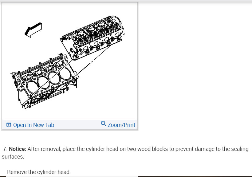

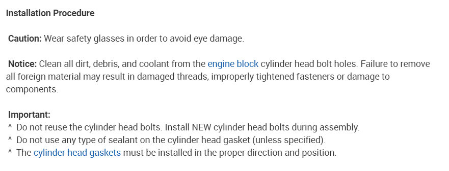

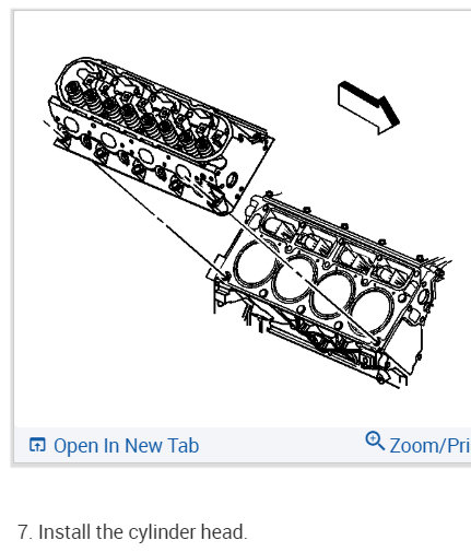

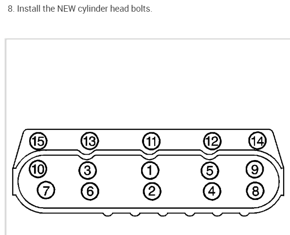

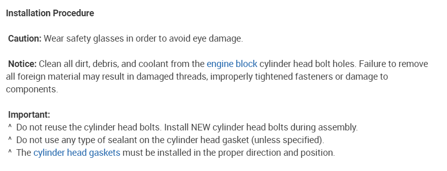

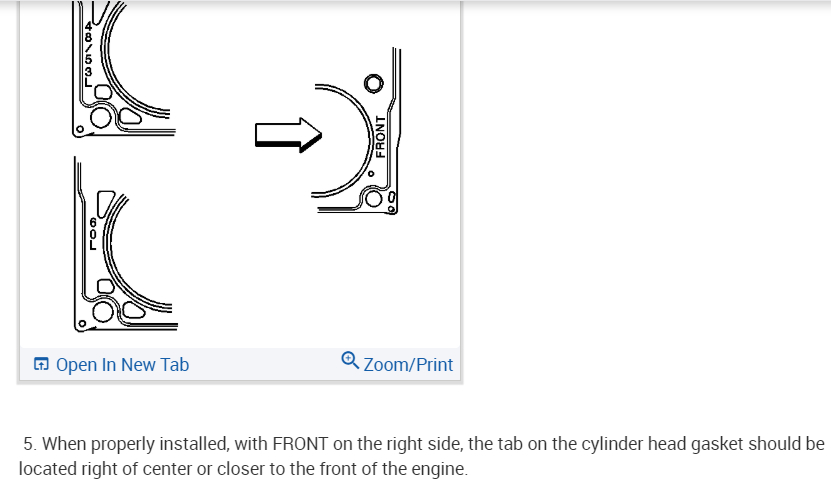

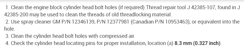

Here is part 2 left side. I've attached picture step instructions again below for the cylinder head removal and replacement for the head gaskets.Hope this all helps.

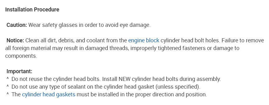

Jun 7, 2020 at 5:00 PM

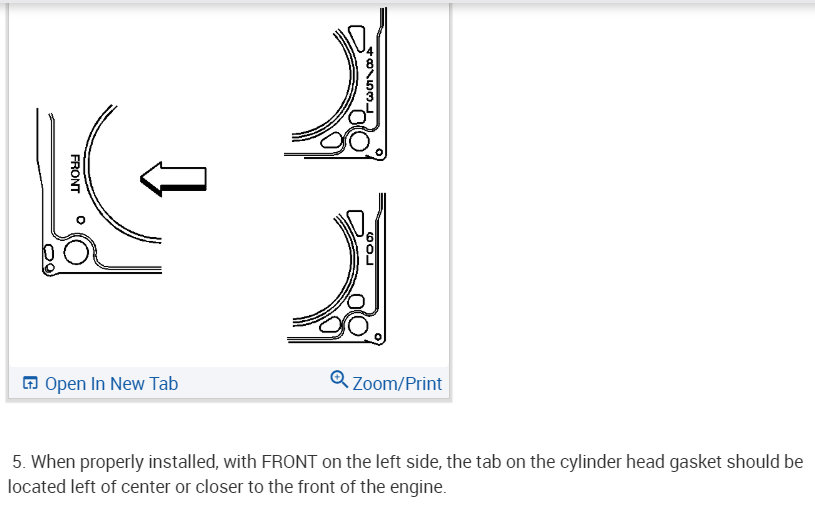

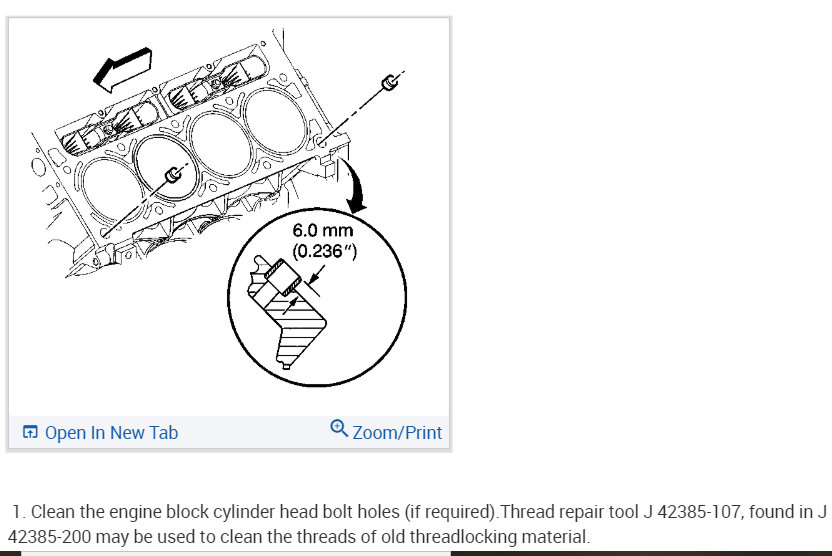

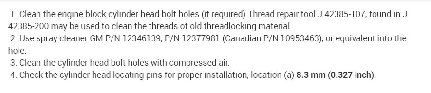

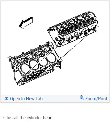

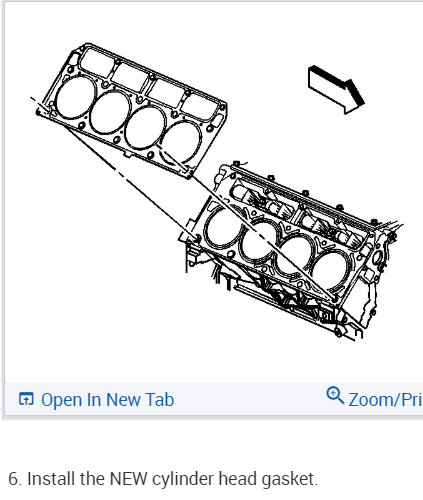

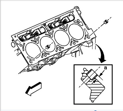

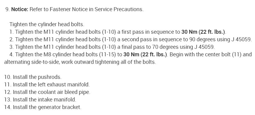

DANNY L
  • 5,648 POSTS
Hello again.

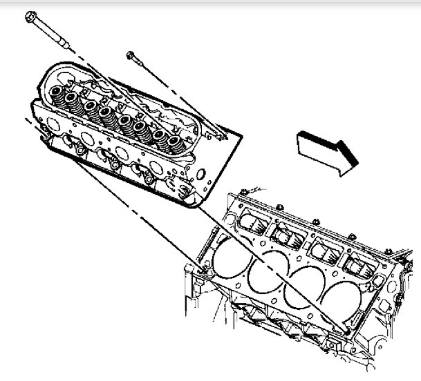

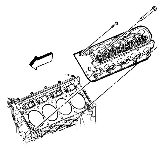

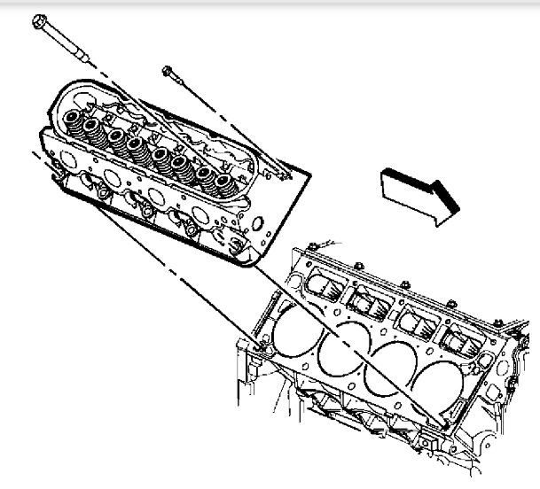

Here is the final part 3 right side. I've attached picture step instructions again below for the cylinder head removal and replacement for the head gaskets.Let me know if you have any further questions about all of this.Hope this all helps.

Do I have to change 4 head gaskets on this?
Jun 9, 2020 at 12:54 AM
DANNY L
  • 5,648 POSTS
Hello again.
No, each cylinder head has only one gasket. The intake manifold has one gasket per side as well.Let me know if you have any further questions about this considering this is a very big job.Hope this helps and thanks again for using 2CarPros.
