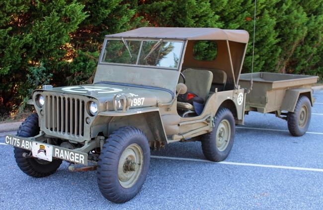

OR YOU COULD JUST GET YOU A JEEP(S) LIKE I HAVE, NOISE IS ALL PART OF THE EXPERIENCE!

Thanks for the input. Nice looking Jeeps!
