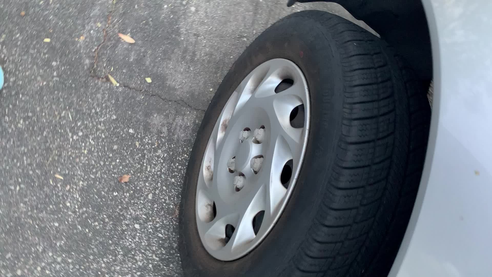

Hey, did you resolve this issue and find out what was causing this sound? Because I have a Saturn 2001, and I’m having the exact same issue now with my front wheel making the exact same sound! Just like you described it and how it behaves when driving or stopping. Any ideas? Thanks!

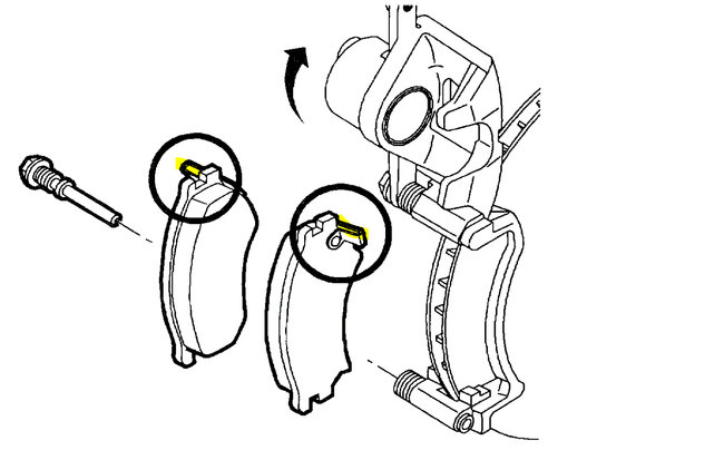

It appears the thread was never finished. Let me try to help.
First, when you apply the brakes, does the noise change pitch? If it does, first inspect the brake pads as mentioned above. They have a steel sensor on them that is designed to touch the rotor when the brakes need to be replaced. That could be the noise.
Next, check the dust shield behind the brake rotor. They can get bent or rust and touch the rotor while it's moving.
I attached a pic of the sensors I mentioned. See if they appear to be touching the rotor. You should be able to see them through the wheel.
If you look under the vehicle, you will be able to see the dust cover behind the rotor. Inspect that as well.
One last thought. If you safely lift the front wheels off the ground, turn one at a time by hand and see if you can locate where it's coming from.
See pic below.

About a week ago, when this sound started, it sounded like it was the brake pads' sensor (it actually didn't change pitch when I applied the brakes, but only with slowing down - even without the breaks - and accelerating). So, I took the car to my mechanic, and he replaced the brake pads with new ones. I thought that was it, and everything was fine driving home. But the next day, the sound all of a sudden appears again!
So, on the weekend I put the car up on the jack and rotated the front left wheel by hand. It indeed made the sound of metal scratching metal (i.e. the sensor again?). So, the next day I drove back to the mechanic, and I heard this annoying sound all the way over there (not a short drive). But then when I get to the mechanic - just as with Murphy's law - he gets into the car and drives it around (with me) to listen to the sound and it's gone! absolutely gone. He lifts the car up, inspects the wheels, and doesn't see, nor hear anything wrong! (I'm assuming he would see, or hear, if the dust shield was the culprit?). He said it might have been a stone or something that was possibly stuck between the rotor and that piece of metal next to it, but I don't know.
This is mind boggling. This Saturn (LW200, 2001) is just - something! I'm afraid to drive the car now, as I'm sure this sound will be back! Do you have a picture of the dust shield by any chance, so that I could take a look at it myself?

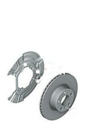

Did you check both front wheels to see if the sound was present? If not, which side made the noise?
I attached a pic below for you to see. The pic isn't specific to your vehicle, but basically, they are all the same or very similar.
The brake rotor sits directly in front of the dust shield. Take a look at it and let me know if you have questions.
See pic below.

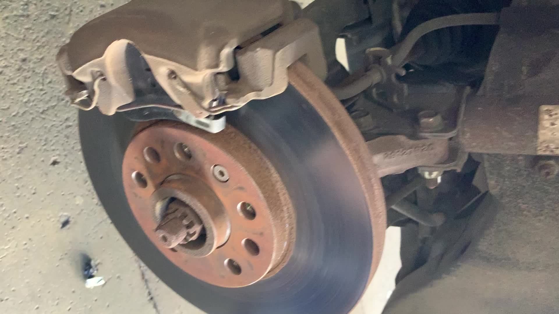

Regardless, if you want, take a few pics of the underside of the vehicle where the backing plate is located. I should be able to tell if it looks like a possibility.

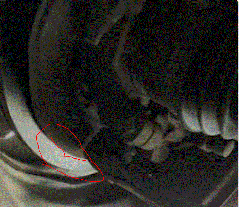

I tried to get my hand and phone in there as much as I could and took a bunch of pictures. Uploaded them all to this Google Drive folder, if you want to take a look! They might all be of the same thing, but I just snapped a bunch of them, to make sure I am not missing anything that might be an important clue!
https://drive.google.com/drive/folders/1DowiTJCoT99J4WHZhMoA5VS7rMH0rQ0D?usp=sharing
Let me know if you see anything there, and thank you again,
AJ
Feb 22, 2022 at 5:02 PM
  • 110,244 POSTS
It looks like the lower part of the dust shield is against the rotor. See the pic I attached. Check that and if it is, simply gently bend it away from the rotor and see if the sound is gone.
See pic below.

So, no luck. Turns out that was an optical illusion, and that bottom part of the dust cover wasn't touching the rotor. I could get my fingers between them. But also, there wasn't much room to move it even further from the rotor, as there's that big bolt right against it... I tried to move it a tiny bit, and took the car for a test drive, and... our favorite sound was there as usual... I think there's not much choice but to go to a shop, lift the car, and take the whole wheel apart?

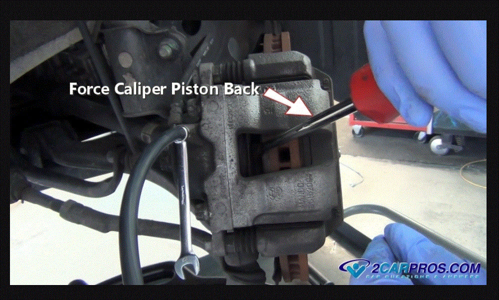

Do me a favor. Remove the wheel and push the caliper back away from the rotor so the brake pads aren't touching the rotor. See if the sound goes away. Also, when the wheel is off, go all around that backing plate and see if it is touching in a different place.
Let me know. Also, I attached a pic below showing how to release pressure from the brake pads.
Let me know what you find. I did listen to all three videos, and it sounds like one of the two.
See pic below.

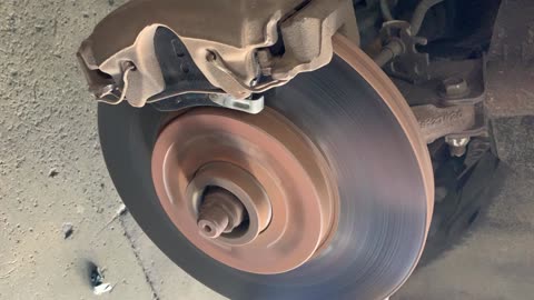

Okay, so brought the car to a mechanic near me, and of course, the sound was on all the way there, but the minute the mechanic got in my car for a test drive, it was gone!! But, when they put the car on the lift, and took the wheel off and one of them stepped on the gas, we finally heard the sound! Hallelujah! See the video attached (it's actually cropped here, so I've uploaded the video also to that same Google Drive folder). So, they said it didn't sound like it was coming from the brakes at all, and not related to the pads touching the rotor, but from something behind the brakes (the wheel bearing?). What do you think?
Thanks,
AJ
Mar 2, 2022 at 6:33 AM
  • 110,244 POSTS
It sounds much different in the video. Just to eliminate a possibility with the brakes, I would try to remove pressure from the pads. However, not that I heard the video, it does sound like something different. At this point, the next step would require the removal of the hub and CV axle for inspection.
Interestingly, even though it could be the bearing, it doesn't have a traditional bearing sound.

So, he diagnosed that it must be the wheel bearing. Even though he said that he had never heard such a sound coming from a wheel bearing, he pin-pointed the sound to be coming from it, and so he went ahead and repealed it. So far, that seems to have taken care of the problem! But guess what, all of a sudden today, I have no back lights (other than the brake light) and no dashboard light! Ah! There is no way on earth these could be related, right? must a fuse or something? This car is haunted!
