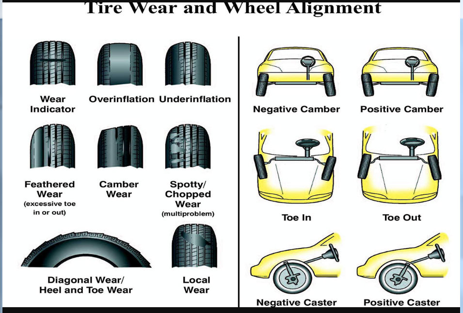

Okay. Then here is my suspicion as to what has happened: Granted I have not seen the vehicle and only basing this on what you are telling me, but I think the noise you are hearing is due to the new pads and may get better as they wear down a little. It may not but it is not a problem but if it is annoying then you would have to have them changed again.
The vibration that you are feeling is most likely a tire issue. Did they happen to rotate the tires when they did the brakes? If so, the front tires may have a wear pattern on them that you are now feeling but because they were on the rear of the vehicle, you didn't feel it.
Here is a guide of what to look for on tire wear:
https://www.2carpros.com/articles/how-car-tires-work
Below is a chart that talks about the same thing.
I may be way off, but I have a feeling this is the issue.
Mar 27, 2022 at 12:49 PM

If they did rotate the tires, they didn't charge me for it. A friend of mine suggested something similar when he took a glance at it yesterday, though, so I'm guessing that's the issue. Thanks so much for all your help!
