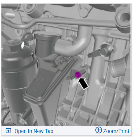

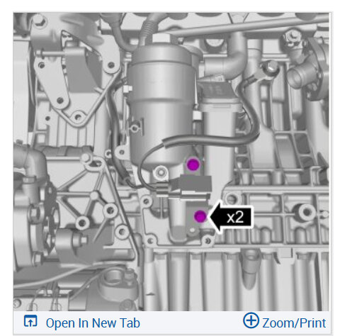

removed oil cap has a lot of suction, where is the PCV located?
98,000 MILES • 5 CYL • TURBO • 2WD • AUTOMATIC
BHAMDOC1973
  • 2,007 POSTS
I removed the engine oil cap, and it has a lot of suction. I was wondering where the PCV is on these cars.
Feb 25, 2025 at 7:58 AM
  • 55,711 POSTS

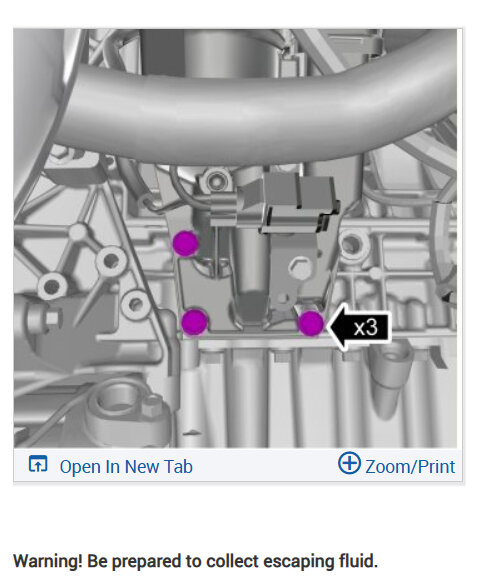

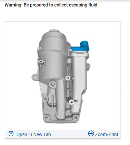

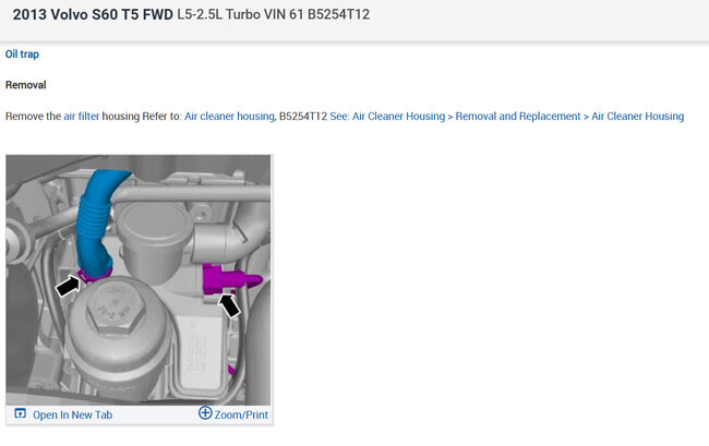

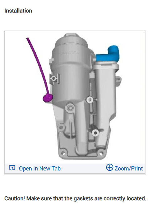

Nope there is no PCV on this car, but there is an oil separator which sounds like it has gone bad. here is the location so you can check it out. Check out the images (below). Please let us know what happens.
