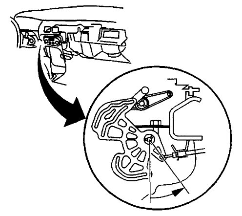

Mode Control Cable Adjustment:
Remove the knee bolster.
Remove the mode control cable from the clip at the heater case.
Set the mode dial to defrost.
Hold the door lever fully forward (counterclockwise).
Install the cable to the clip.
Test the cable for smooth operation.
Test that the door opens fully in both directions.
Install the knee bolster.
