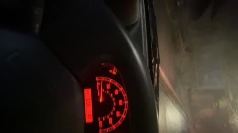

Hi. When the car moves from cold between 1st and 2nd gear up to 15-30 MPH speeds, I can hear a squeal from left side which sometimes goes away quick and seldom stays until I rev a bit and speed up. Help

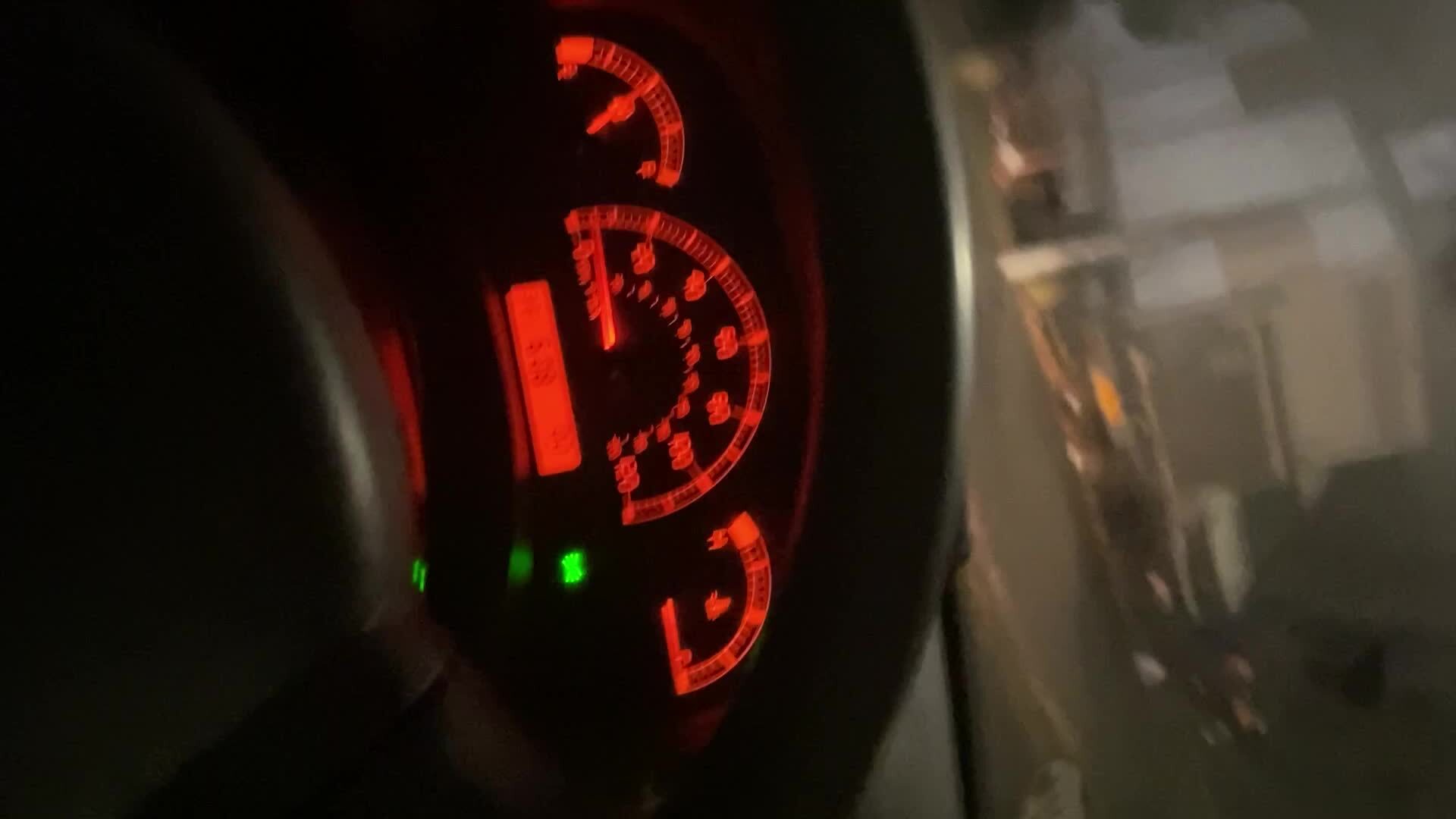

Here you go. It only makes the sound while driving slow.

That sounds like a wheel bearing. When you speed up, does it stop or change? Also, when making turns, is there one direction that makes it louder? Does the sound change if you press the brakes?
It isn't a belt. It sounds like either metal to metal on the brakes or a wheel bearing.

It goes away after I drive more than 15 MPH. No turns or anything makes a difference, that's why I'm confused.
