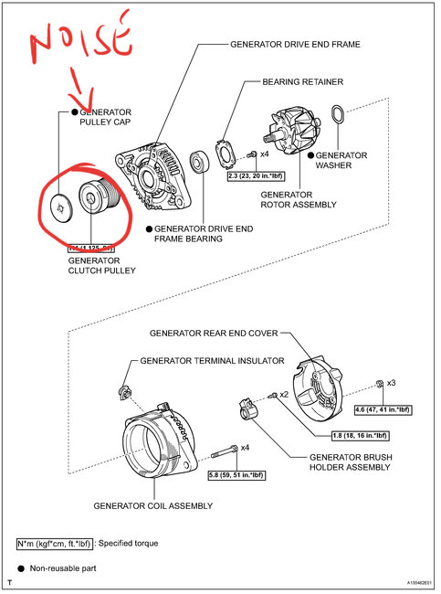

I can hear some whirring noise coming from under the car after driving it for a while. I put the transmission into parking and turned off A/C and I could still hear the noise, sitting inside the cabin or standing outside. The only thing I'm kind of certain is that sound is not coming from the engine compartment. What parts of my car do I need to further investigate?

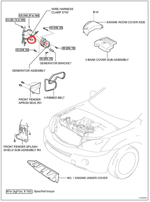

There really isn't anything on the driver side but the transmission. I would suspect 2 things. Either a bad alternator or water pump. If you open the hood up can you still hear the sound? If you do can you record near the alternator on the passenger side. While the sound present unplug the electrical connector at the alternator. If it goes away then the clutch in the pulley is bad. Very common problem.
If okay then check the water pump pulley for play. Use a pry bar and gently put pressure from behind to push outward. If the pulley moves then the water pump bearings are going bad and will also cause that whirling sound. Let us know on those 2 tests.
