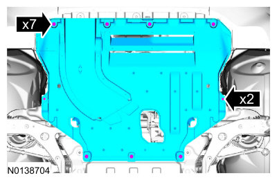

With the vehicle in NEUTRAL, position it on a hoist.
Refer to: Jacking and Lifting - Overview (100-02 Jacking and Lifting, Description and Operation) .
Remove the retainers and the engine front undershield.
pic 1

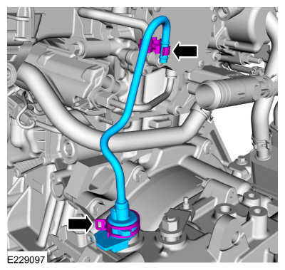

Start the engine and slowly select each gear position, stopping in each position and allowing the transmission to engage.
With the engine running in PARK on a level hoist make sure the transmission is at normal operating temperature 85-93° C (185-200° F). Check the transmission fluid is even with the oil leveling plug hole.
pic 2

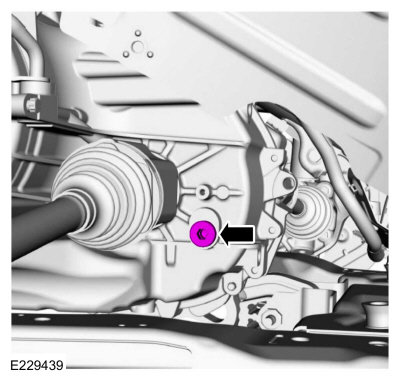

If the transmission fluid is not even with the oil leveling plug hole, add clean transmission fluid in increments of 0.25L (0.5 pt) until the transmission fluid is even with the oil leveling plug hole.
Material : Motorcraft® MERCON® LV Automatic Transmission Fluid / XT-10-QLVC (MERCON® LV ) (WSS-M2C938-A)
Pic 3
Install the oil leveling plug.
Torque : 26 lb.ft (35 Nm)

I want you to do one thing before checking fluid. Take a rubber mallet and tap on the exhaust to see if anything vibrates. If there is a rattle, check for a loose heat shield or try to locate where it is coming from.
Let me know,

Updating this in case others have similar issues.
I went back to the dealer for other service and mentioned the issue. Their transmission expert tried to replicate the noise over two days and was unsuccessful. He did mention that the transmission fluid was low, so he topped it off. Ever since the fluid was topped off I haven't had any issues.
Since I began having the issue immediately after the transmission fluid was initially changed, I'll chalk it up to the fluid not being filled all the way at that point. It's too bad this vehicle doesn't have a fluid dipstick making the process to check the fluid not too quick or easy. But I'm glad it was a quick/cheap fix.
