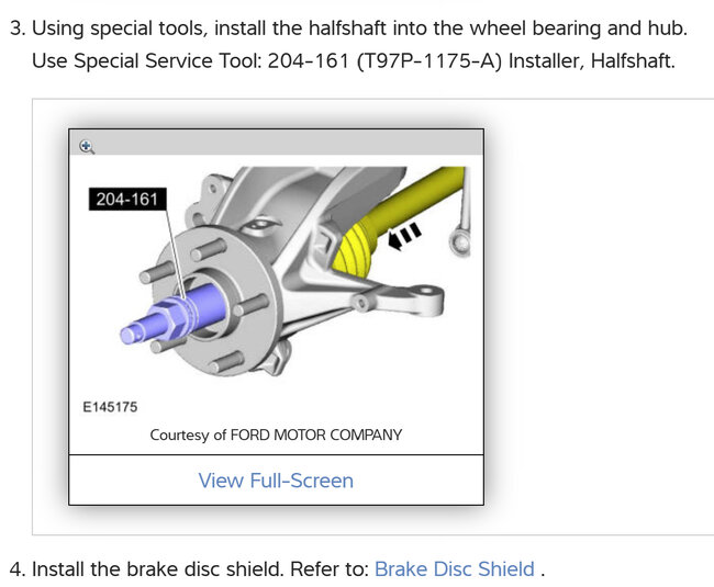

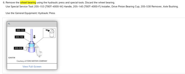

Hello CSKONTHEGOYO,
It sounds to me that Asher needs a wheel bearing. You may have other noises but with a noise starting after 15 MPH that is howling and increases with speed it is normally wheel bearing or tire related.
Here is an article with a few other things that might cause it:
https://www.2carpros.com/articles/car-howling-noise
If the noise is worse when turning right, then it is usually the left bearing that is bad. If it's worse turning left, then it could be the right bearing.
The reason is the weight of the car is being put on that bearing more as the weight of the vehicle shifts when turning.

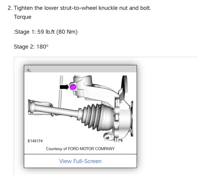

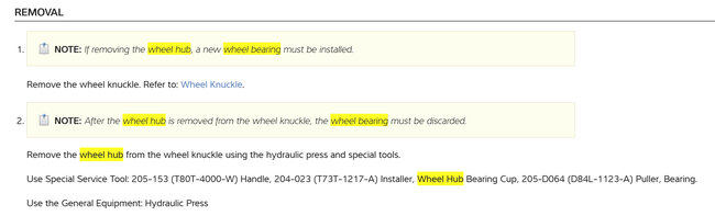

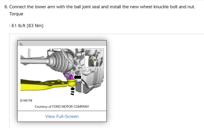

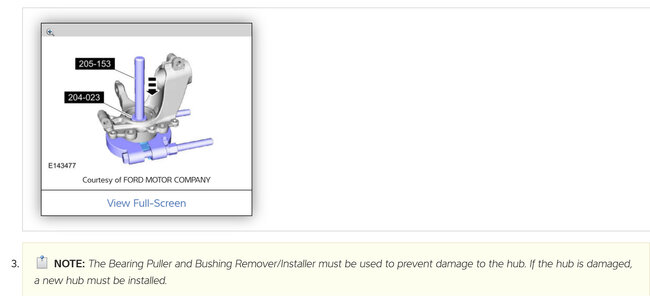

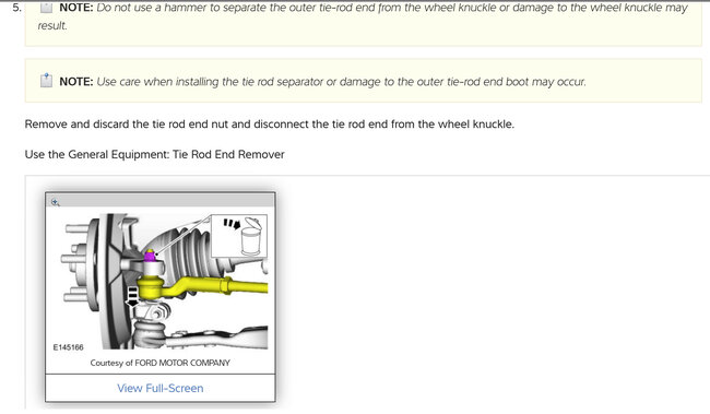

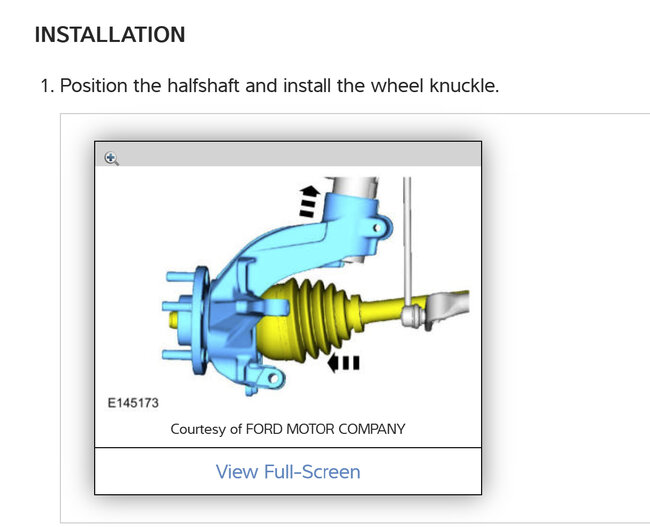

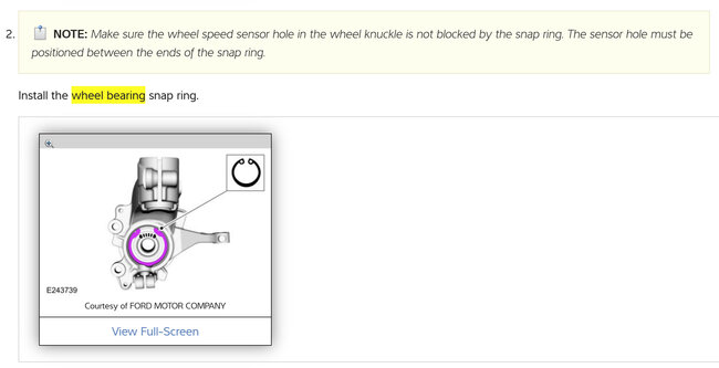

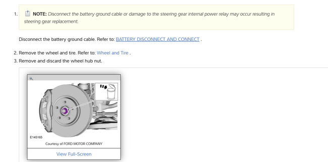

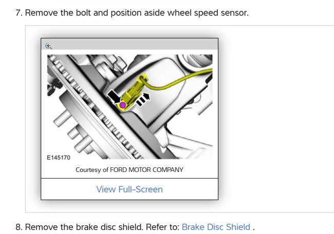

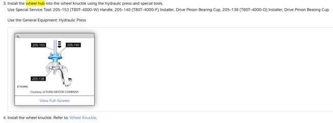

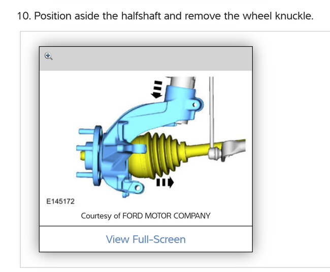

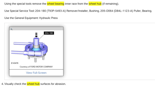

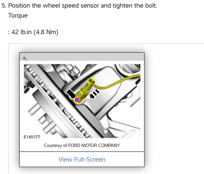

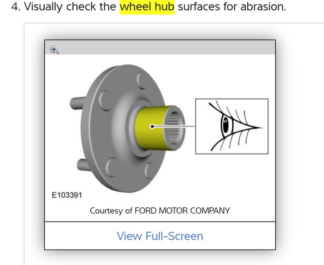

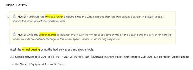

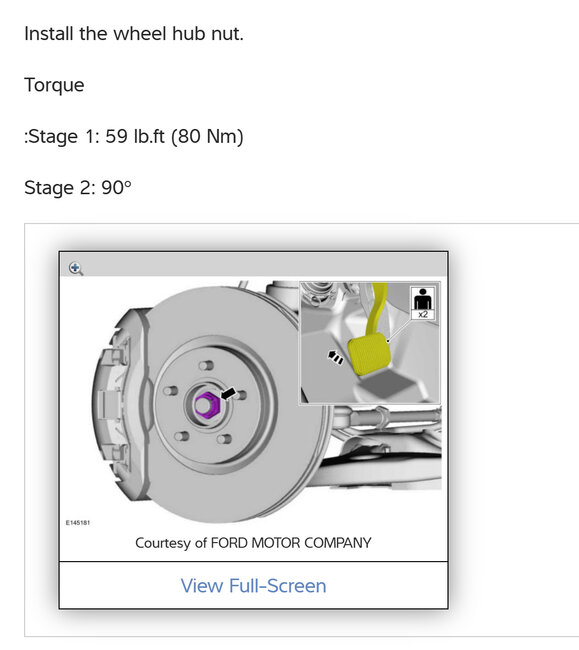

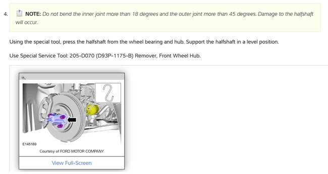

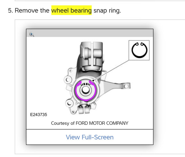

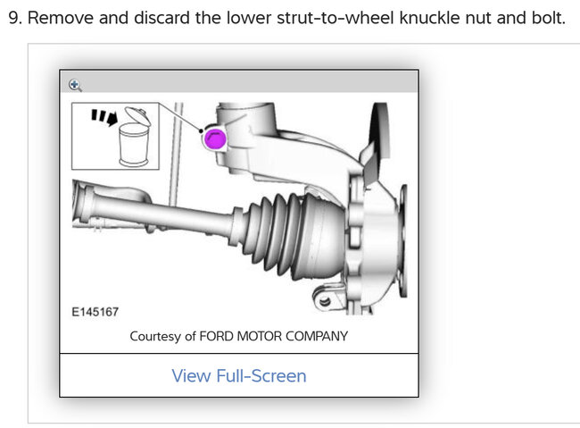

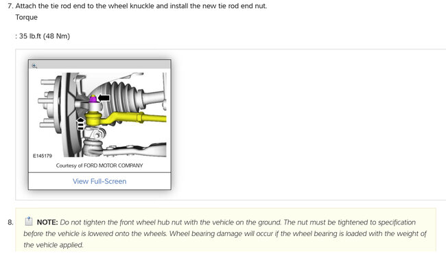

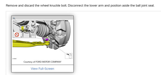

This bearing, according to my information, is pressed into the steering knuckle and will need to be pressed out and a new one pressed in. The steering knuckle will need to be removed from the vehicle to do this.
I have added removal and installation procedures for you for both the steering knuckle and the bearing if you wanted to do it yourself.
You will need to bring it to a shop for them to press it in for you though if you don't have one.
