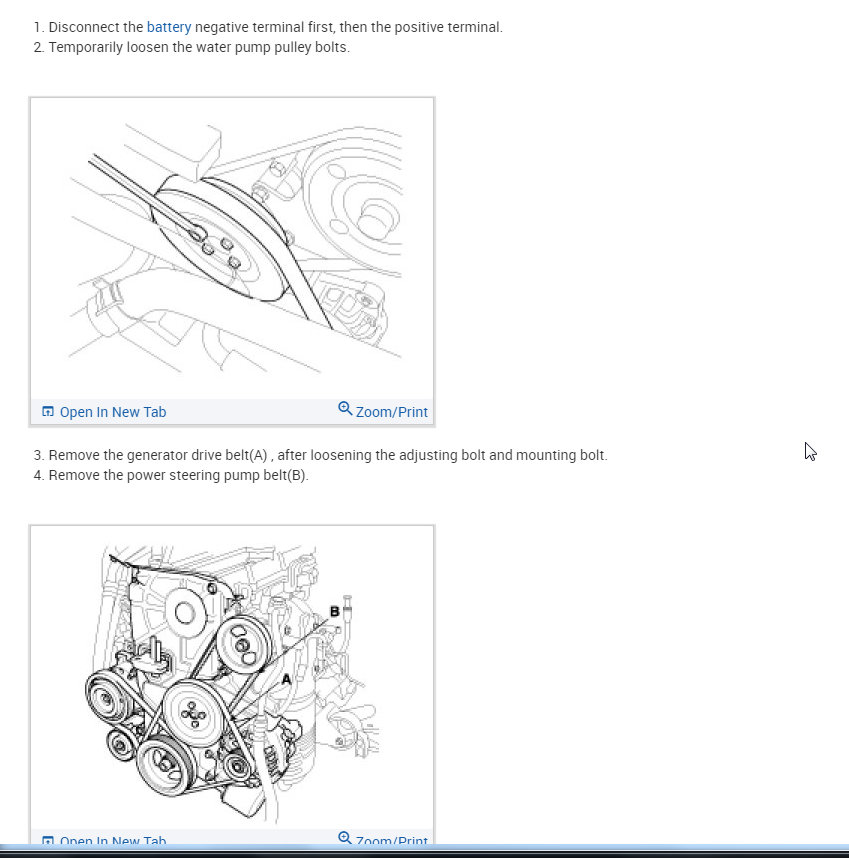

Okay, removing the drive belts will tell us if we may need to take it back. I attached the process on how to remove them. You actually have two. Let me know if you have questions. Thanks
Jul 16, 2020 at 10:58 AM

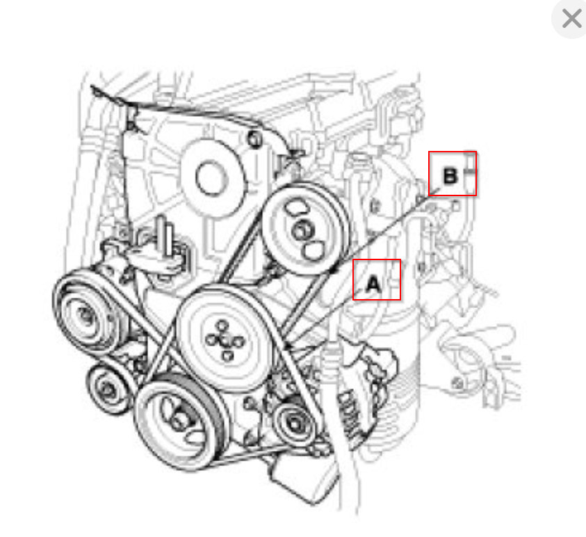

What is the serpentine belt? I had a mechanic check my belts but stated nothing wrong. I'm still not understanding what could be the issue my car sounds very loud when driving.
Jul 30, 2020 at 11:49 AM
That is the drive belt. You actually have two of them. A is pointing to the alternator belt. B is pointing to the power steering belt.
If you remove these and run the engine and it still does it then these belts are not the issue.
Jul 31, 2020 at 10:39 AM

Okay, I never change the power steering belt.
Aug 1, 2020 at 12:13 PM
Okay. So if that was never changed then it may not be the issue. However, if you remove the other and it still does it, then it is worth while to remove this one as well as any belt can cause a noise and this may just be a coincidence. I am speaking from experience that we don't want to make assumptions on these as they will most likely be the issue and we assumed it was fine.
