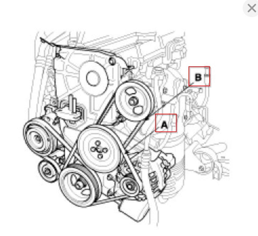

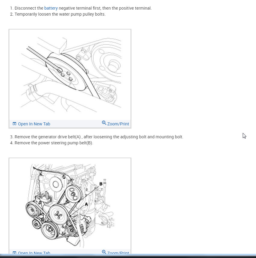

Okay, removing the drive belts will tell us if we may need to take it back. I attached the process on how to remove them. You actually have two. Let me know if you have questions. Thanks
Jul 16, 2020 at 10:58 AM

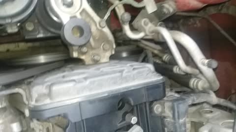

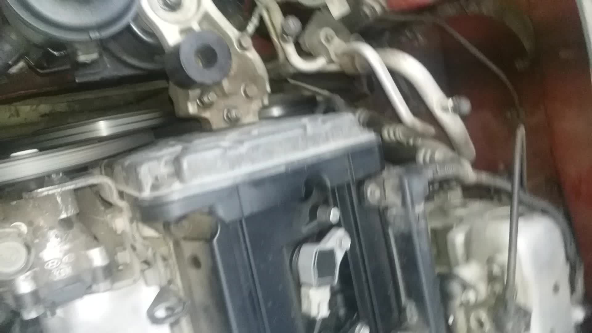

This the best I could get.
Jul 16, 2020 at 11:12 AM
Okay. Looks like the belt was still on there so it would be a good comparison to run it without the belt. However, that whining when you are hitting the gas that seems to come and go is normal. That is actually the rotating components that make that whining but I am not sure that is the noise you are hearing. Let's compare that to it running with the belt off and go from there.

That is the drive belt. You actually have two of them. A is pointing to the alternator belt. B is pointing to the power steering belt.
If you remove these and run the engine and it still does it then these belts are not the issue.
Jul 31, 2020 at 10:39 AM
