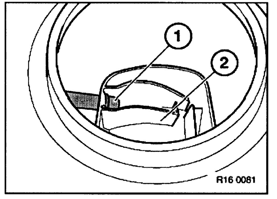

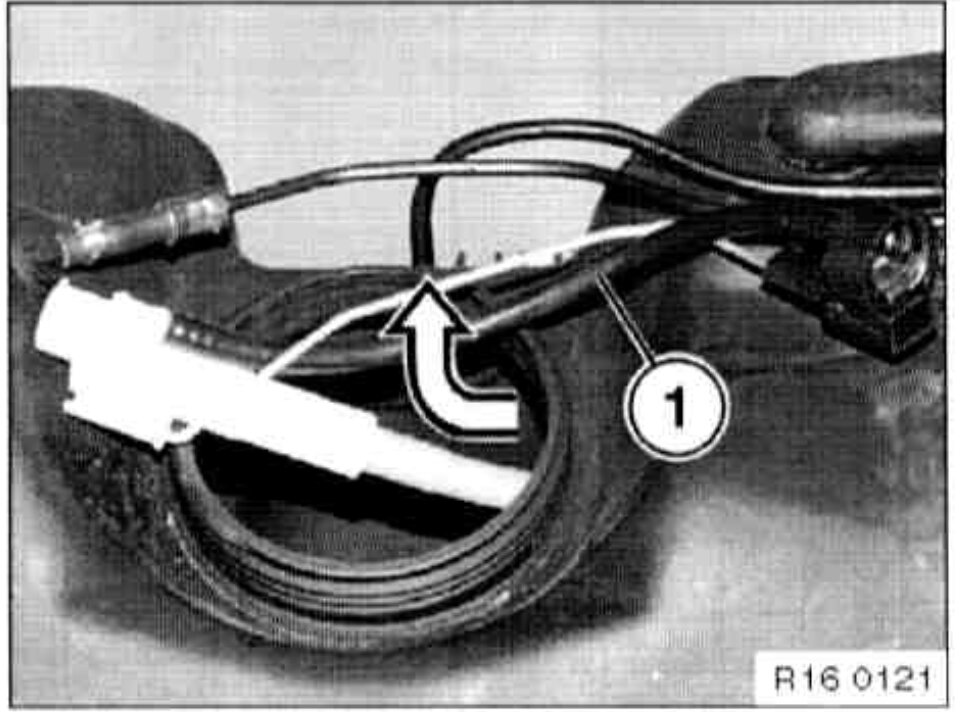

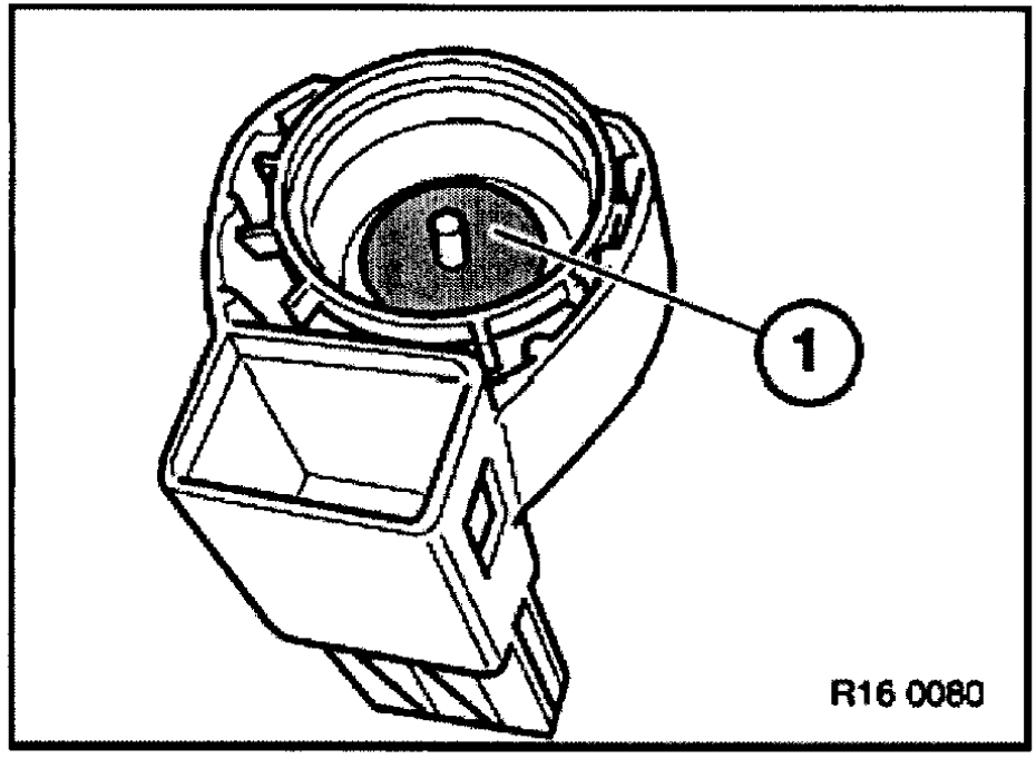

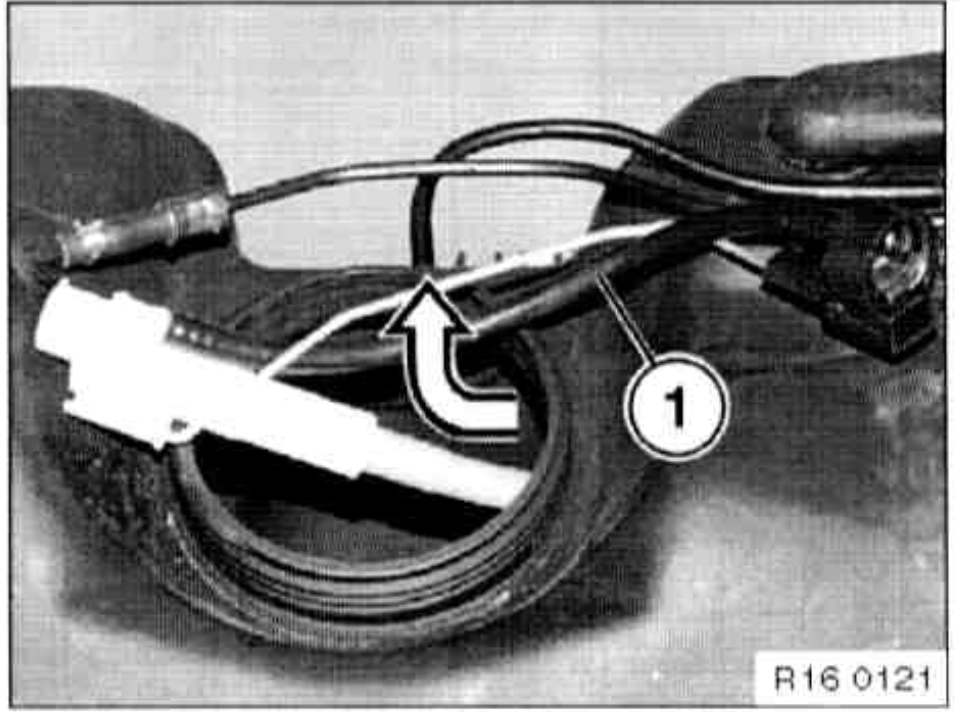

Yes, it sounds like the pump is going out. I will attach the instructions to replace below with pictures. Take note that there are two "pumps", a left and right. The left side being for the fuel level and the right side being what is providing fuel to the engine. Please let us know how it turns out.
- Suck the fuel out of the fuel tank.
- Remove fuel level sensor (right).
- Remove fuel level sensor (left).
LEFT SIDE:
- Pull tank expansion line (1) on fuel baffle (2) out of locking fixture.
Installation Note:
- Ensure that tank expansion line is perfectly connected in fuel baffle.
RIGHT SIDE:
- Remove tank expansion line from fuel tank.
Installation Note:
- Tank expansion line must not be bent when it is being removed.
Installation Note:
- Ensure that non-return valve (1) is fitted in tank expansion line.
