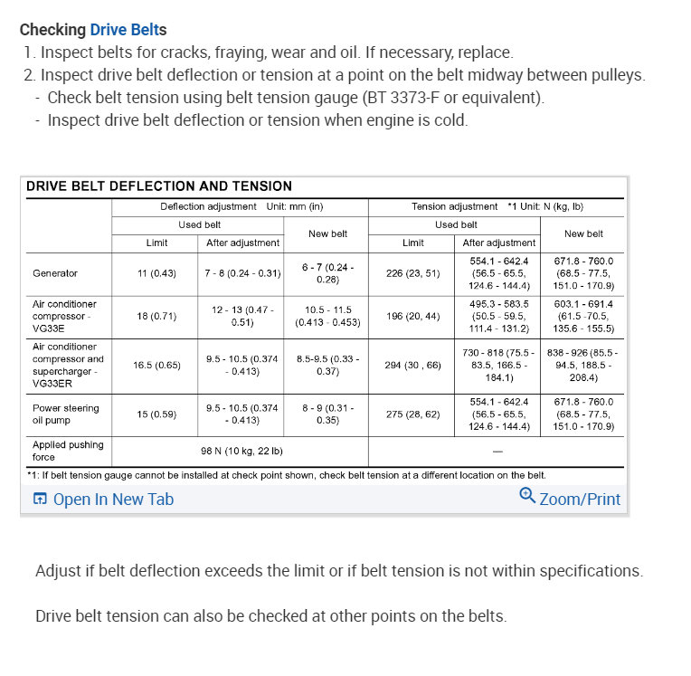

The car is heaving, like huff, huff, huff. Whining squealing when accelerator is pressed
May 29, 2022 at 7:54 PM
  • 55,732 POSTS

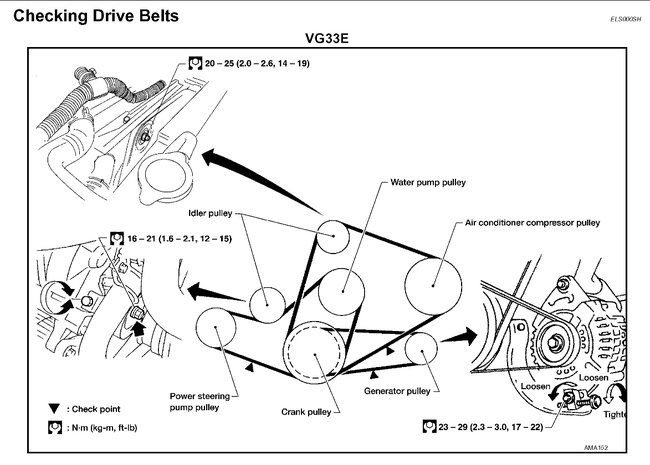

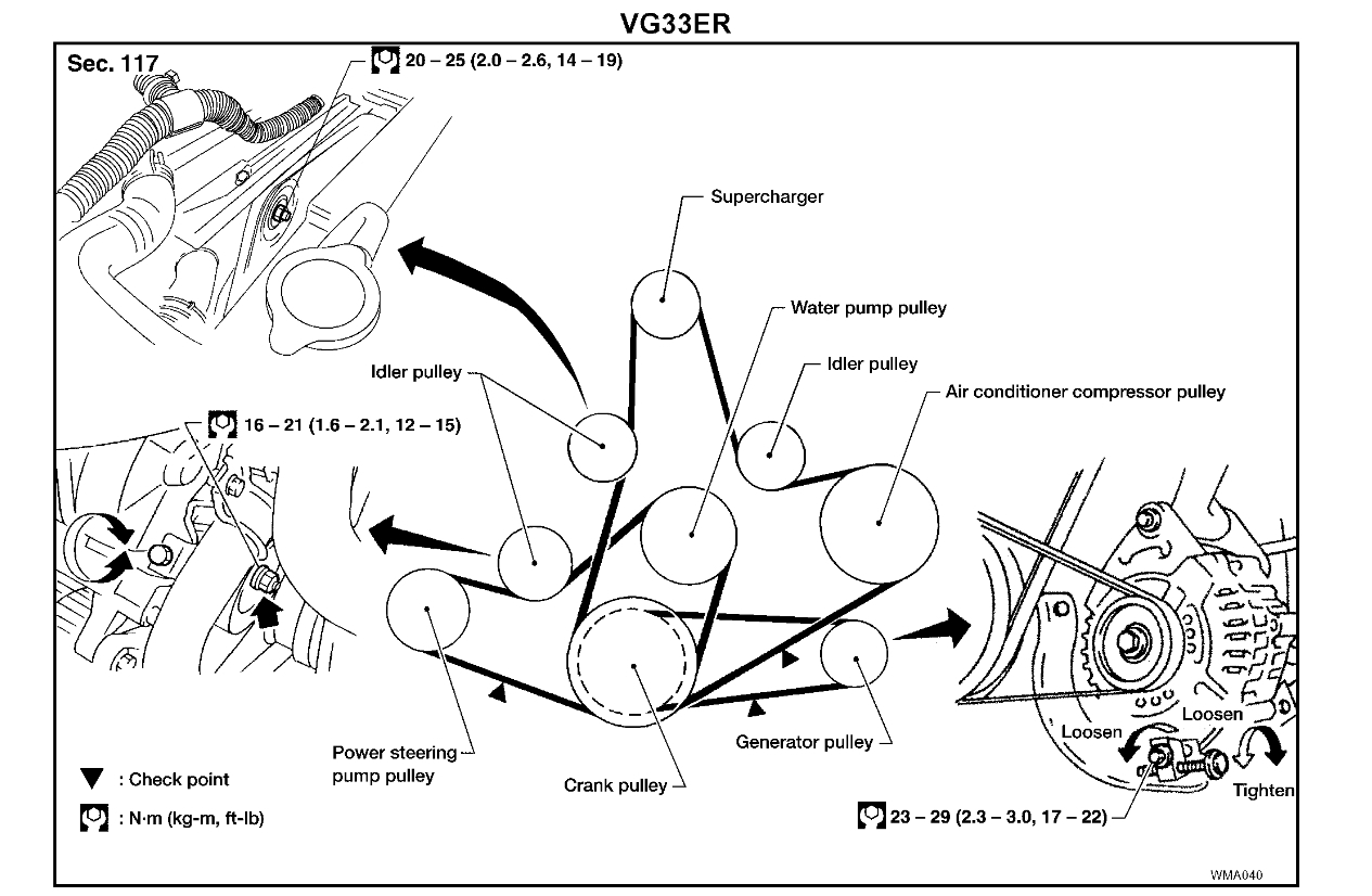

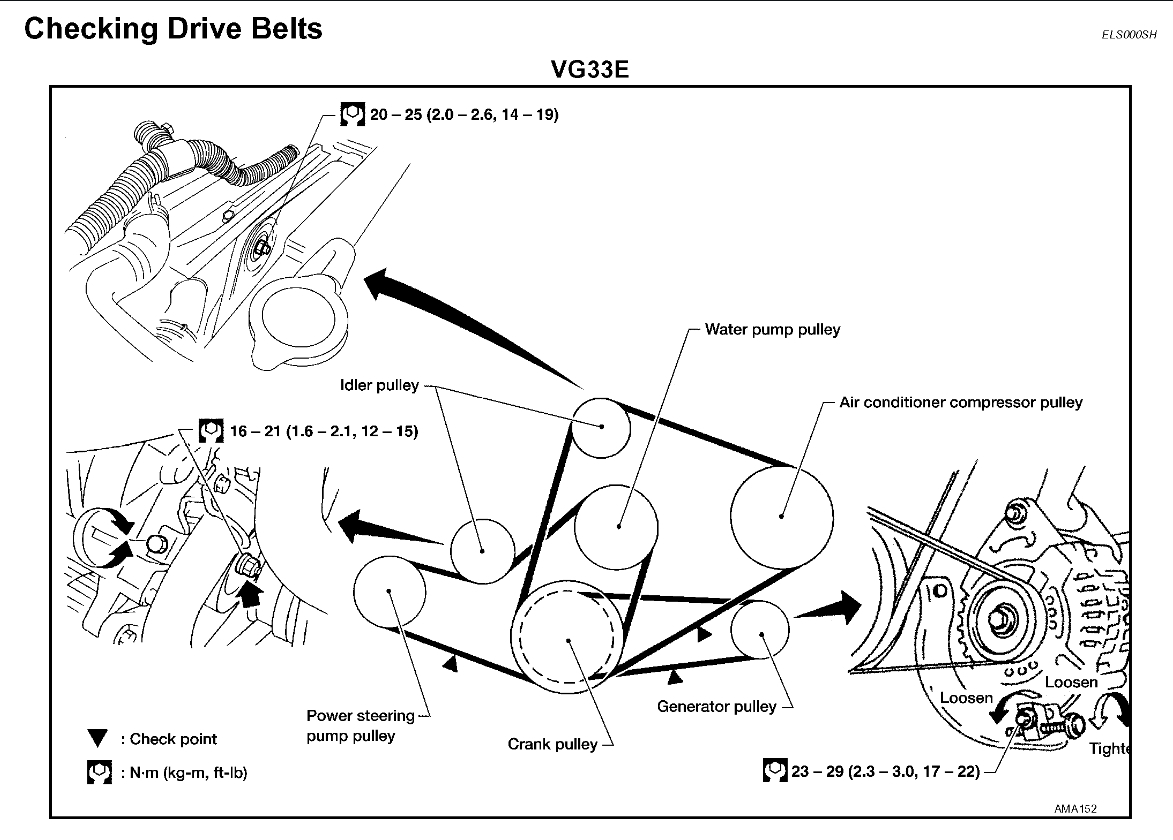

This is common when the engine's serpentine belt is loose or worn out but to be sure can you upload a video of the engine making the noise in the meantime here is a generic guide on how to replace the belt with specific instructions for your car in the diagrams below.
and
