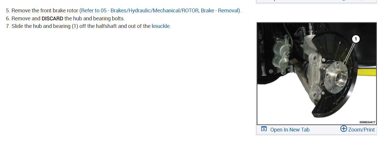

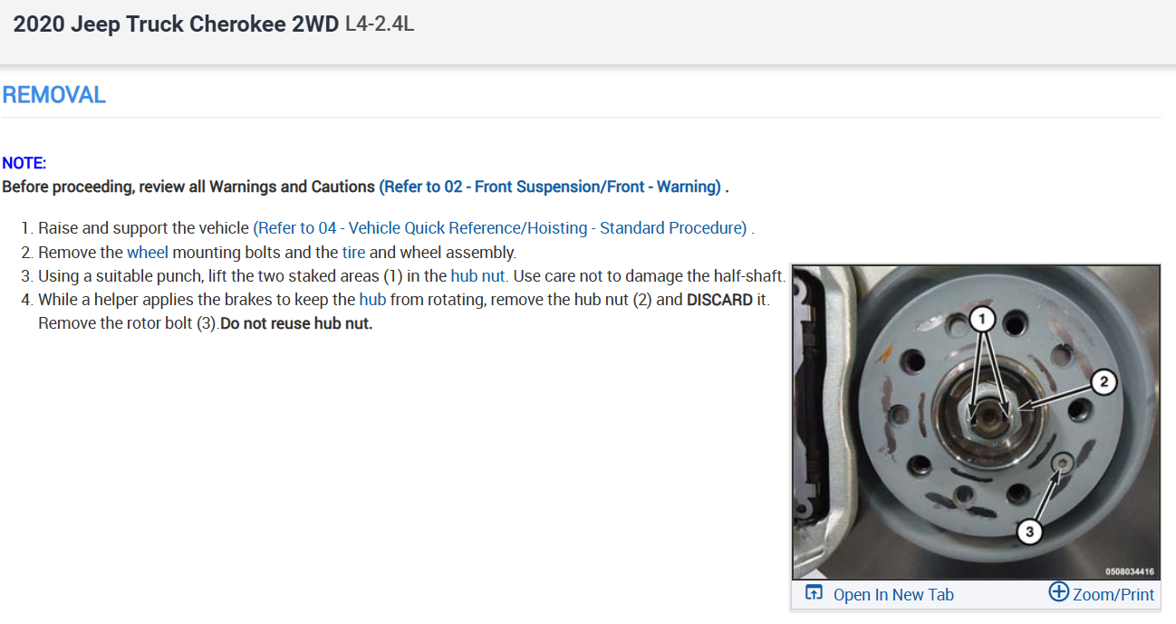

Is the noise coming from the front or rear also does it follow the engine speed? I would check the front tires for scallops and then rotate them to the rear. Also, you may be able to steer the car slightly one way or the other to help change the noise to confirm the bear hub failure.
Here is a guide that can help:
https://www.2carpros.com/articles/7-common-symptoms-of-a-bad-automotive-bearing-hub
The front bearing hub does not look that hard to change out. Check out the images (below). Please upload pictures or videos in your response of any problems so we can see what to help you with.
