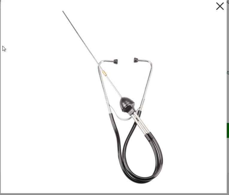

Okay, based on that, it may be the transmission oil pump. That is spinning at a constant speed pretty much all the time and would fit this scenario. However, this is not enough to go on yet to go that route because that requires removing the transmission. Take a look at the picture attached. This is a mechanics stethoscope. They are less than $5 in most cases and the way they work is you put it on your ears and then touch the end to each component around the noise where you hear the noise the loudest and see where the noise is the loudest using this. Basically, it helps you narrow down where the noise is coming from. Let me know where you hear it the loudest with this tool and we can go the next step. Thanks
