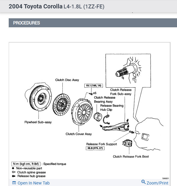

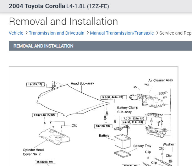

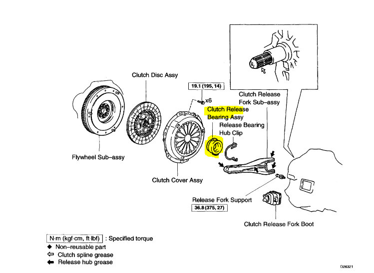

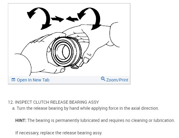

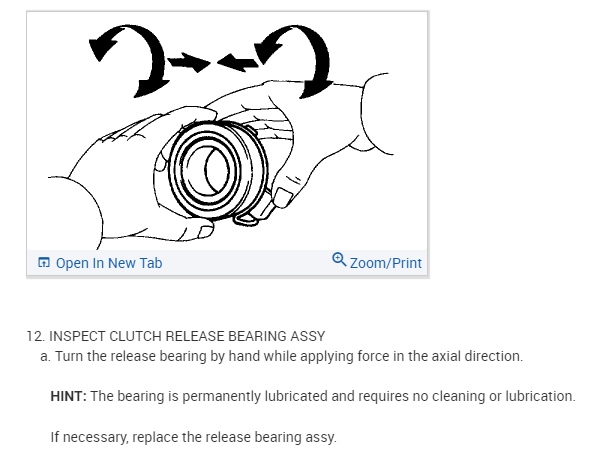

Is it loud enough for you to record and upload for me to hear? To me, your description sounds like it may be the release-bearing, but that shouldn't cause the clutch itself to overheat. See pic below.
Was the clutch slipping when you noticed the odor?

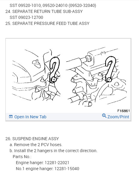

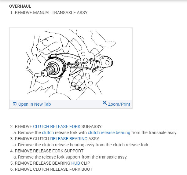

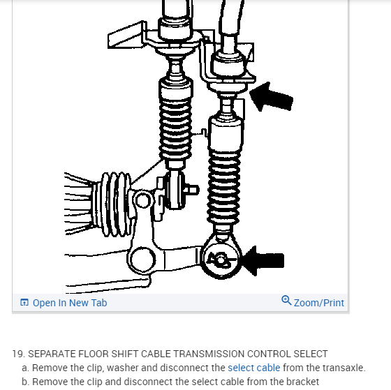

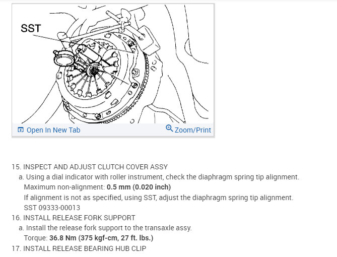

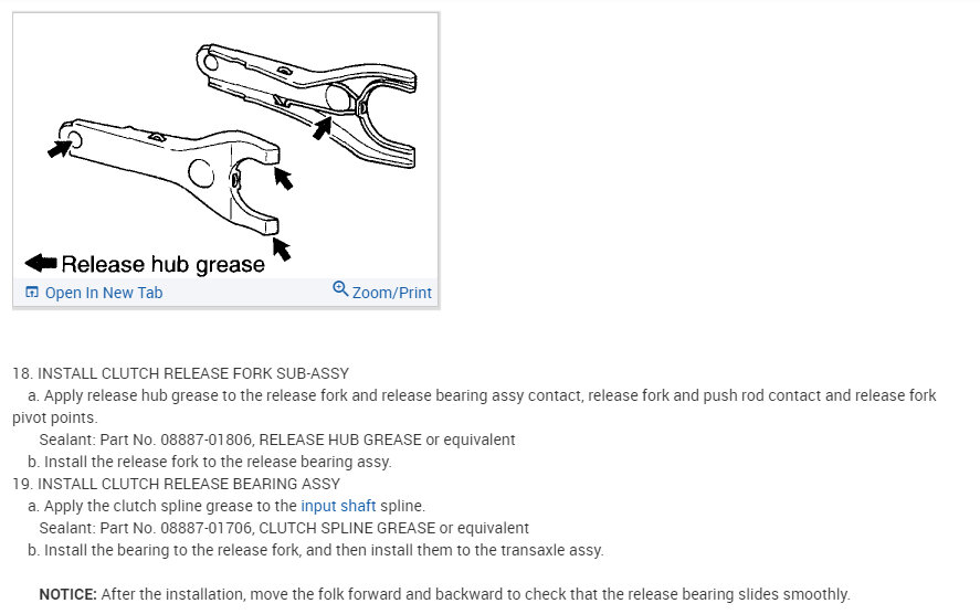

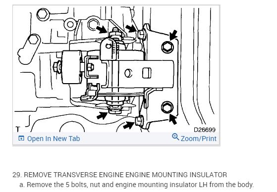

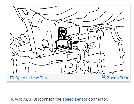

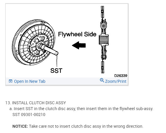

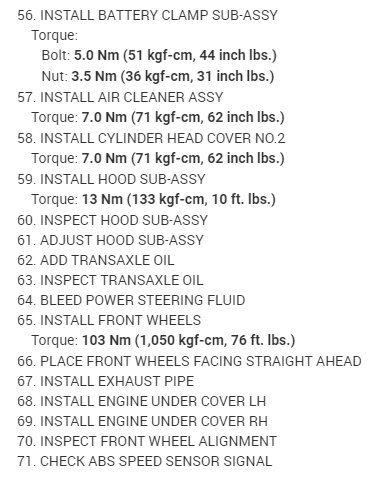

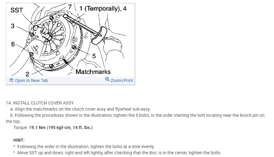

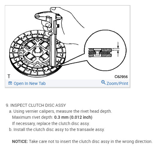

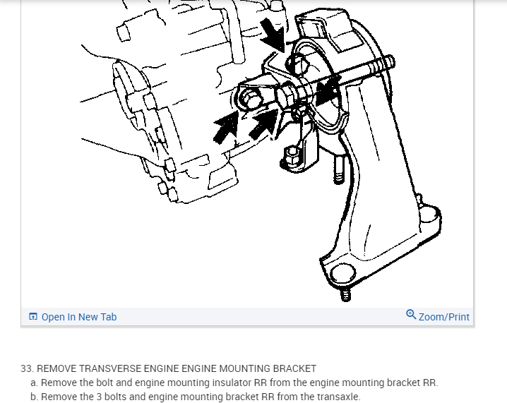

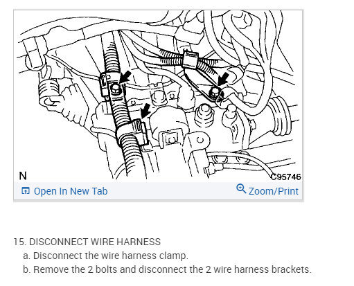

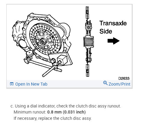

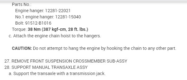

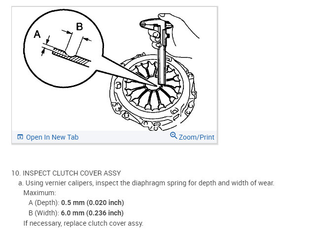

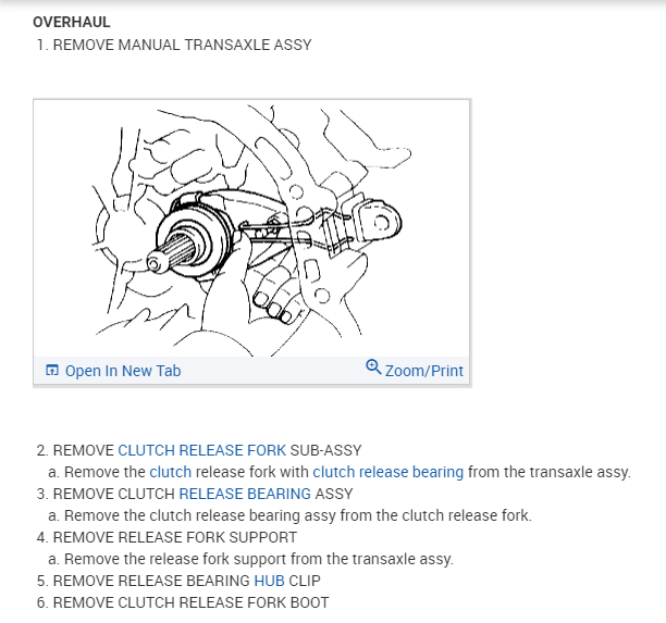

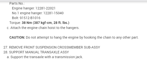

I listened to the noise. It does sound like a bearing issue. If the clutch is worn, this may be the time to replace it.

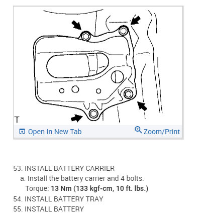

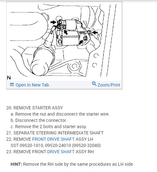

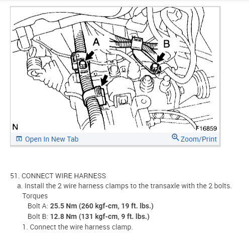

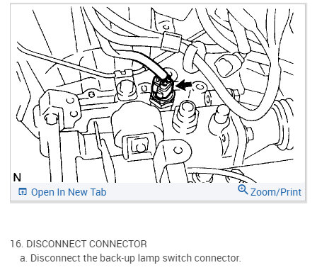

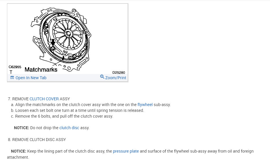

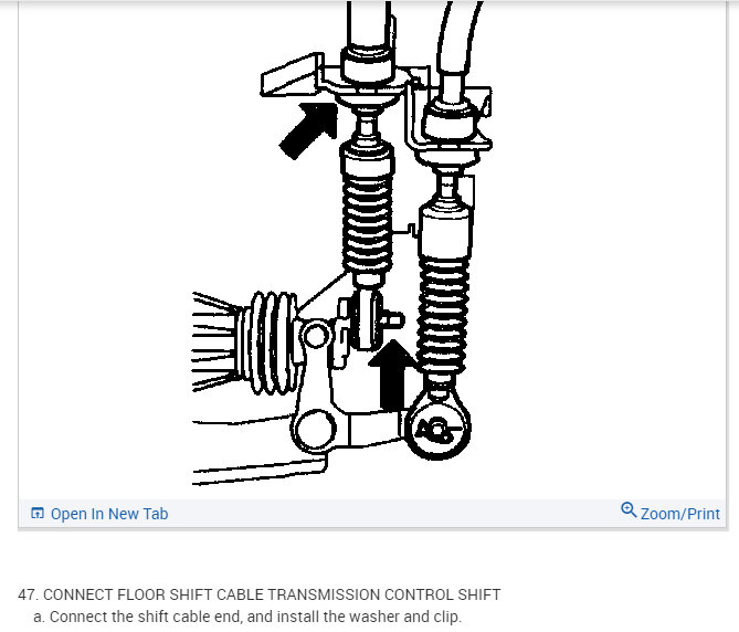

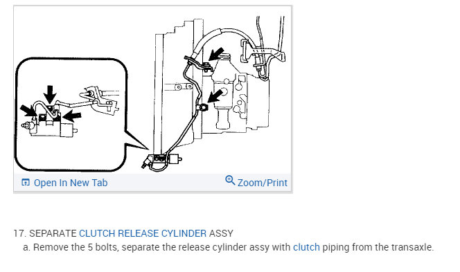

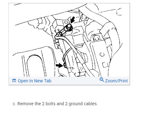

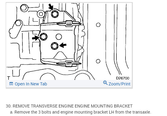

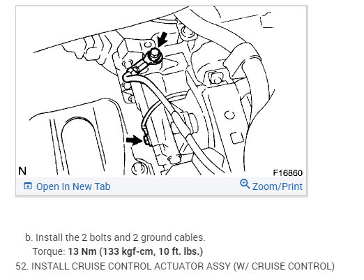

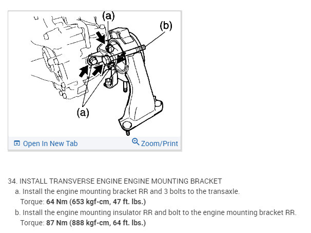

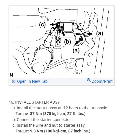

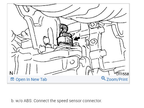

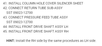

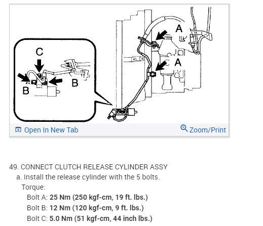

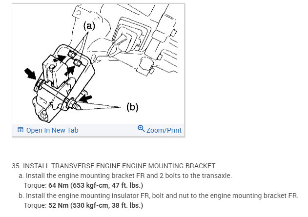

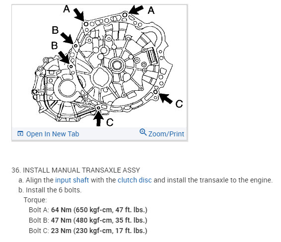

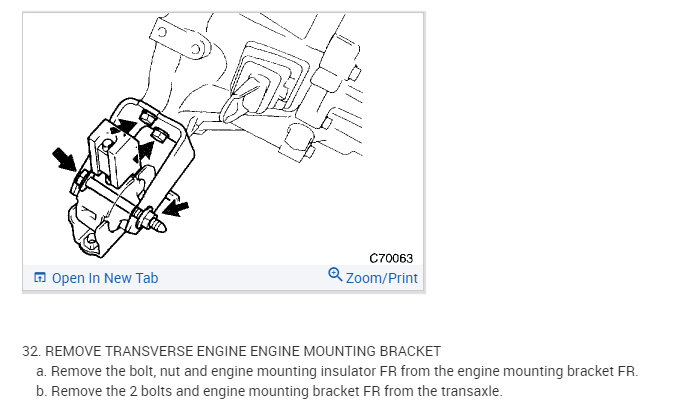

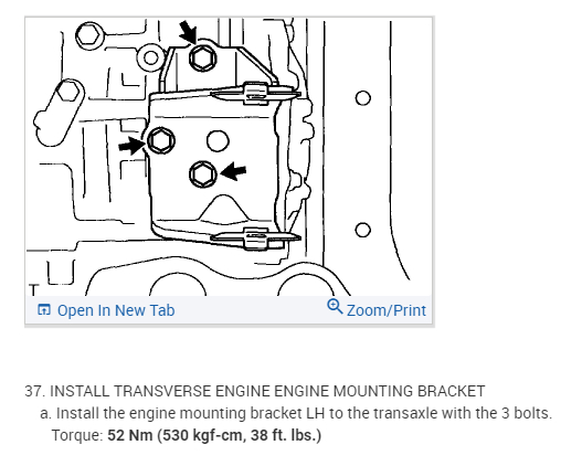

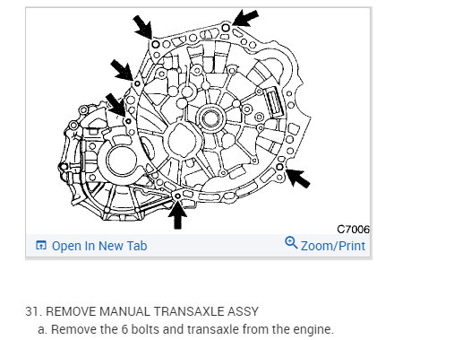

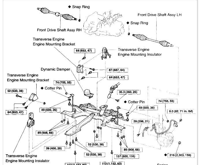

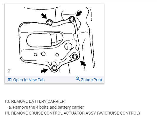

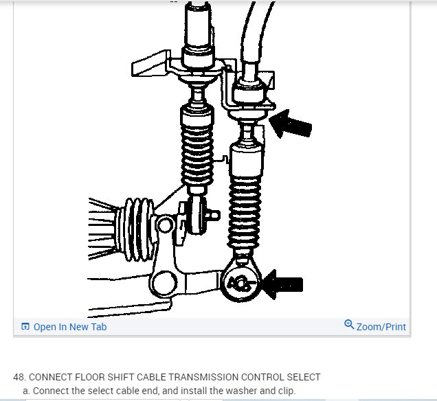

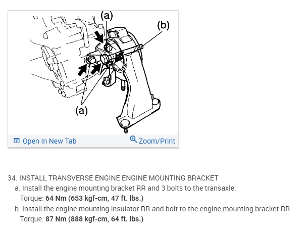

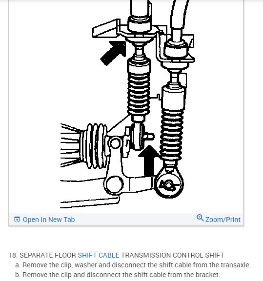

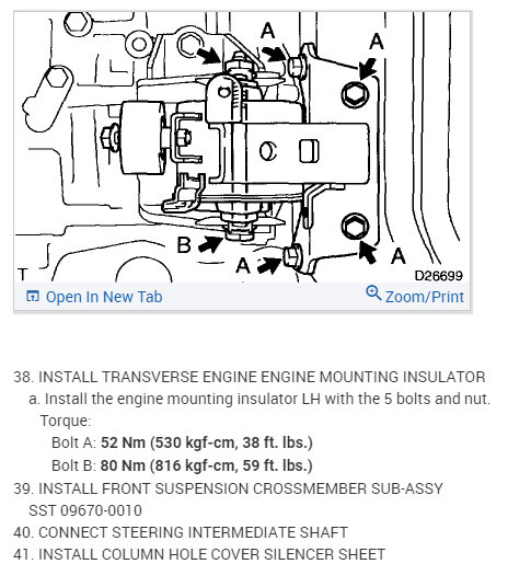

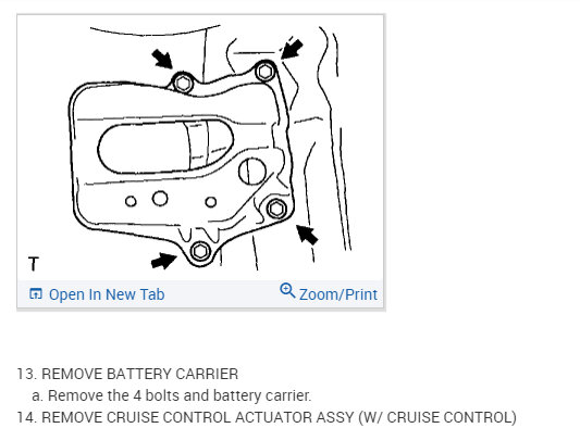

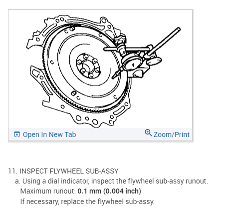

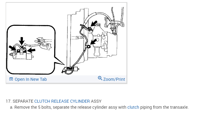

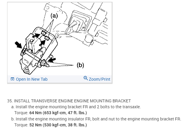

I'm not sure if you want to do it yourself or not, but I attached the directions for the removal and installation of the transmission first. After those directions, I included the directions for inspecting and replacing the clutch assembly.
Let me know if that helps or if you have questions.

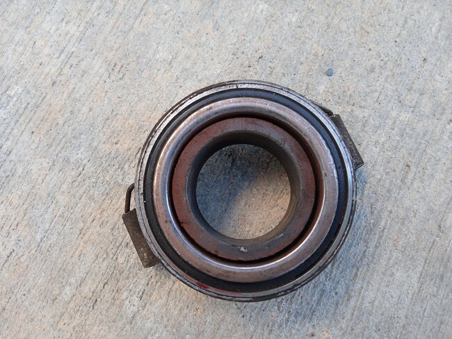

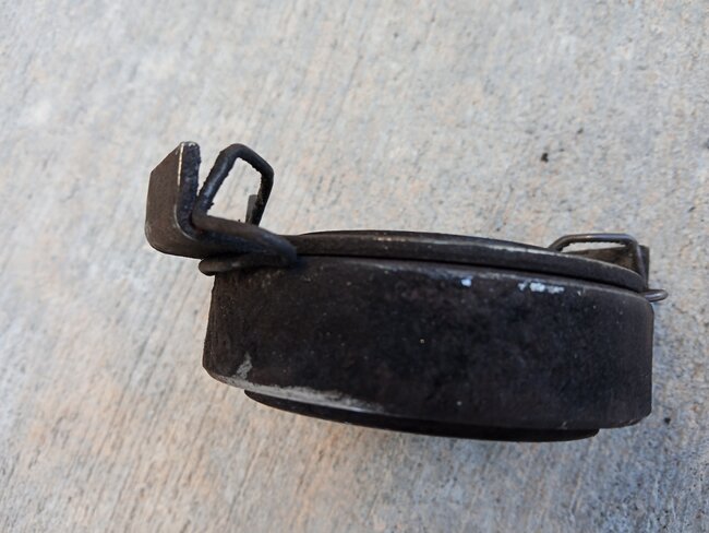

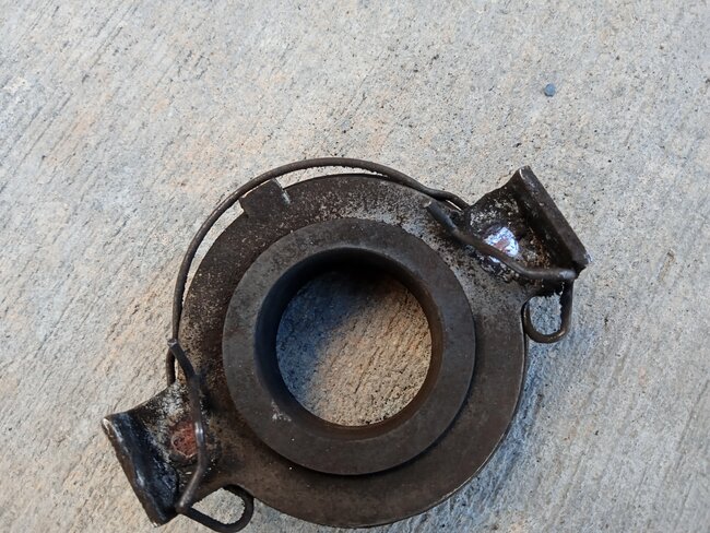

I dropped the transmission today. There is no damage to the clutch plate (normal wear the clutch is almost at the rivets) and to the pressure plate. However, the throw out bearing does not spin. So how to make sure that is the throw out bearing that is making noise and not an internal bearing in the transmission aka shaft bearing, gear bearing or others.

  • 109,885 POSTS
If the release bearing doesn't turn, I suspect that is the issue. When you depress the clutch, it doesn't change the pressure on any of the bearings in the transmission itself. Since it can't be turned, that is the most likely cause.
Do me a favor. If possible, take a couple of pics of the release bearing and upload it for me to see.
Sunday, October 29th, 2023 AT 9:03 PM

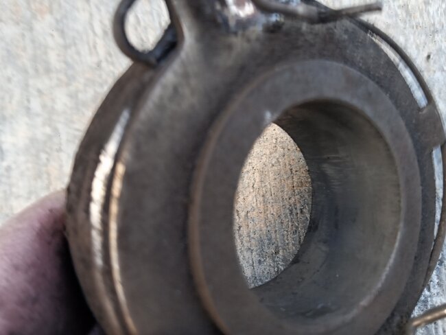

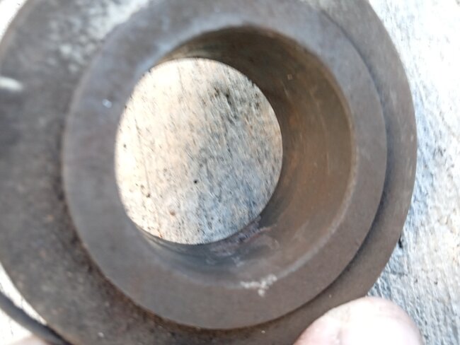

YAZIDAN
  • 107 POSTS
These are the pics. If you need more let me know.
Monday, October 30th, 2023 AT 4:21 PM
  • 109,885 POSTS
It looks like it has been there for some time. If that bearing is seized and won't turn, I suspect that is the cause. I wish I could guarantee it, but not being there, is not a good idea for me to do. However, this is certainly my first suspect. (I hope you understand)

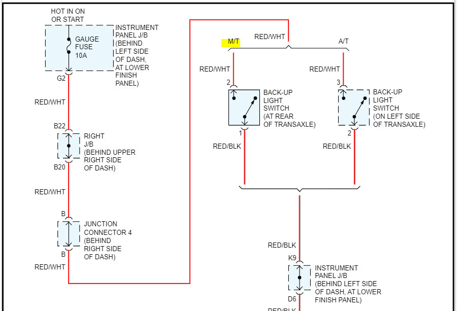

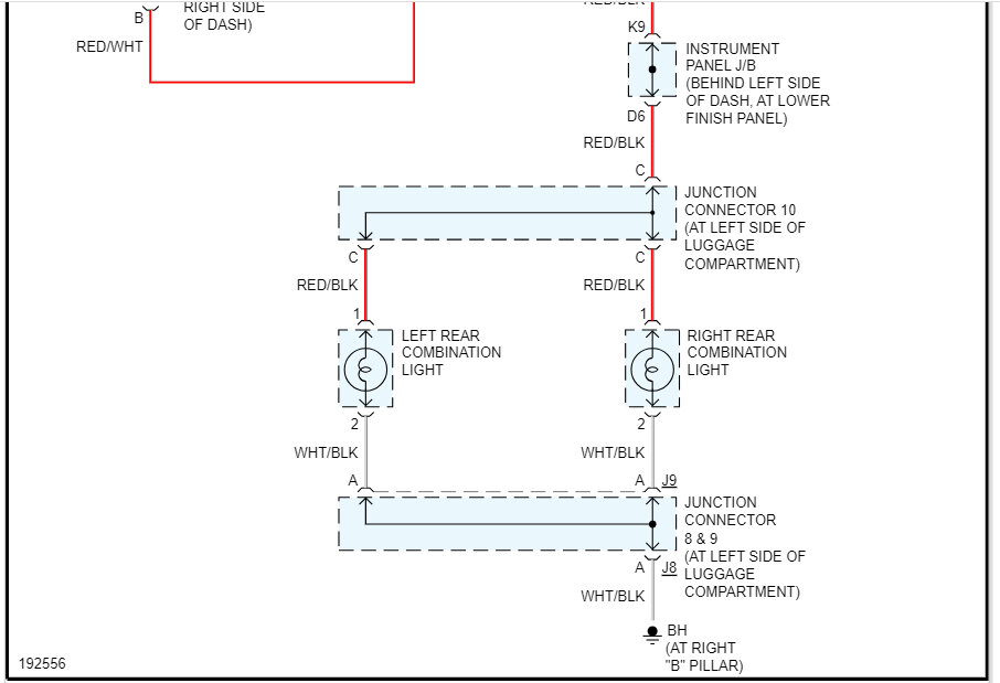

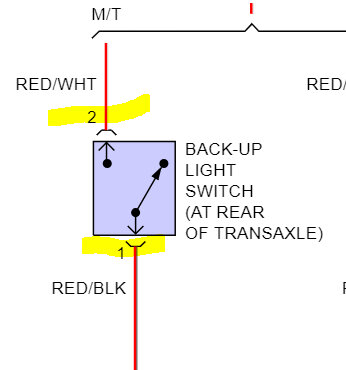

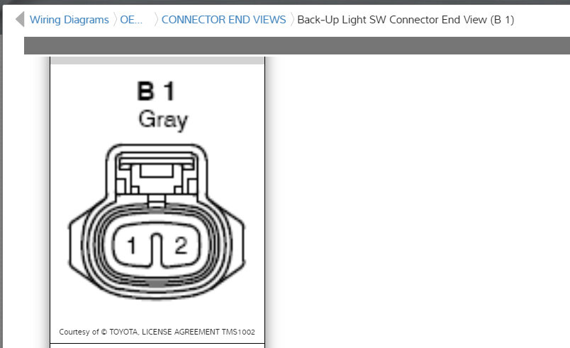

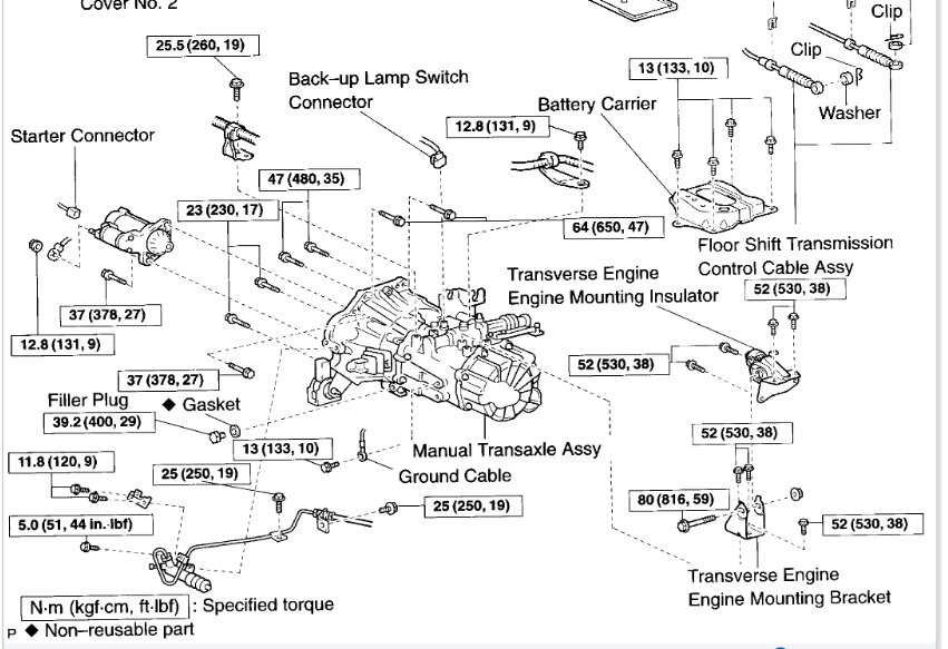

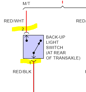

There is a gray connector that connects to the transmission, it's a 2-wire connector. I think is for the backup light. The wire got De-pined when I was trying to put the transmission. Can you give me a diagram of the connector?
Thank you for your help.
Wednesday, November 8th, 2023 AT 8:12 PM
  • 109,885 POSTS
If one wire is red with a white tracer and the other is red with a black tracer, the connector is for the backup lights.
With the key in the run position, the red/white wire is the power supply. When the vehicle is placed in reverse, the switch closes and power travels through the red/black wire to the backup lights.
I attached the schematic below for you. Let me know if this helps.
joe
See pics below. Note: I had to cut the pic in half to make it readable. I did overlap the two so you can follow from one to the next.

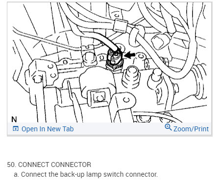

I need to picture of the connector female. I need to know those two wire where they go on the female connector.
Thank you
Wednesday, November 8th, 2023 AT 10:59 PM
  • 109,885 POSTS
If the wire colors I mentioned above are correct, take a look at pic 1. It should be the correct female connector. In pic 2, it shows what color wire goes to which pin.
Let me know if that helps.
+1
Thursday, November 9th, 2023 AT 7:48 PM
YAZIDAN
  • 107 POSTS
is pic 1 shows the front or the back of the connector?
Thursday, November 9th, 2023 AT 8:03 PM
  • 109,885 POSTS
That is from the front. That is the section that connects to the male end. Orient the connector in the position shown and the wire colors will match from the rear.
