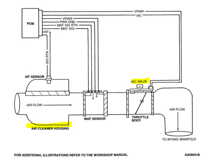

Do me a favor. Remove the lid from the air filter box and see if the sound stops or changes. I have a feeling the cause is a failing idle air control valve (IAC). There is a spring in them that gets weak, and the IAC resonates and makes that hooting noise. It will stop when you press the throttle or remove the air box lid.
So, you have a reference, I attached a pic below that shows the airflow from the air box, past the IAC, and then to the intake.

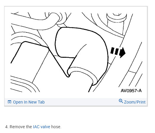

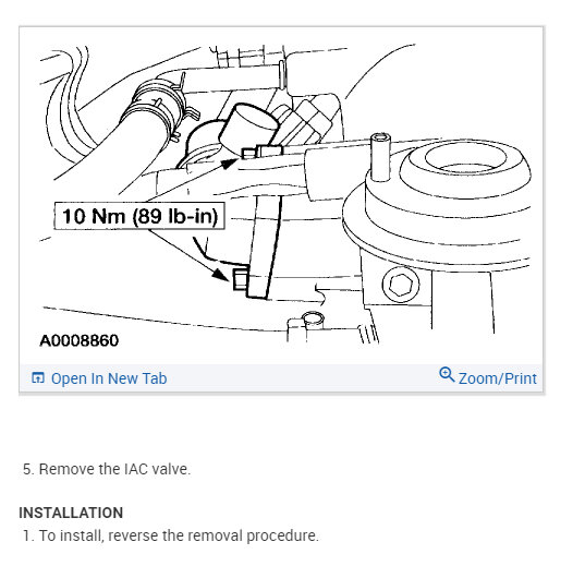

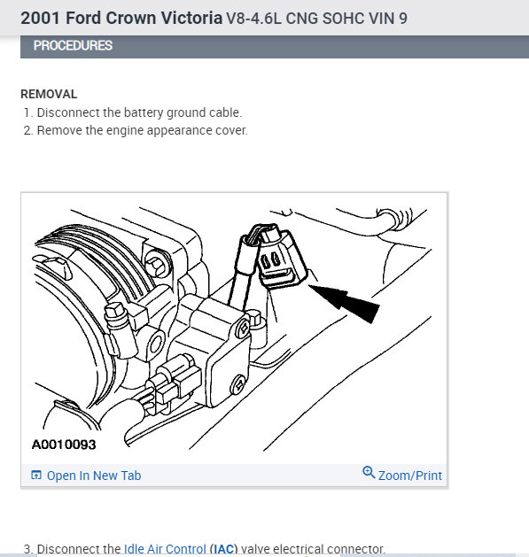

I don't know if you need them, but I attached the directions for the removal and replacement below.
Take care and let me know if that takes care of the noise.
