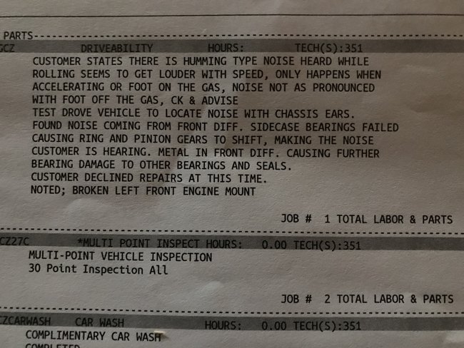

So here is the estimate of what is wrong $3,300.00!
Nov 30, 2018 at 9:31 AM
That is very, very high.
All the parts at rock auto are around $300.00 minus the fluid.
$3,000.00 for labor is a joke. It is about a six hour job. That is about $750.00. That means the job is worth around $1,000.00 to $1,100.00.

ANDY1103
  • 13 POSTS
This is what dealership explained to me. Photo did not attach before. Just wanted to add to the original question thread.
Dec 1, 2018 at 6:05 AM
Okay, thanks.
Still way overpriced.

In your option is the vehicle okay to drive long distances? Dealership said yes but little leary.
Thanks!
Dec 5, 2018 at 1:04 AM
Not in my opinion. You have bad bearings and those shavings are making the issue worse. Over time they will cause much more damage.
I would go the safe route and rent a car.
