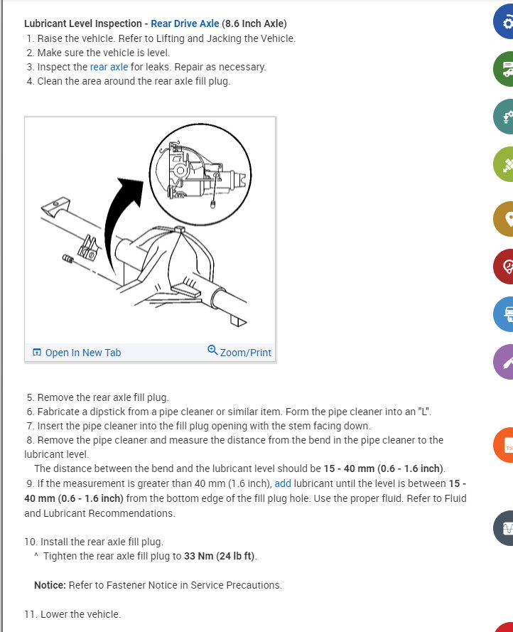

Here is a guide that will help with this:
https://www.2carpros.com/articles/whirring-sound
What I would suggest is to check the rear end fluid to see if it is low and then I would suggest draining it and checking for metal.
https://www.2carpros.com/articles/differential-gear-oil-fluid-check
https://www.2carpros.com/articles/differential-service
I attached the info below on how to check the fluid level. Let us know what you find with this, and we can go from there.
