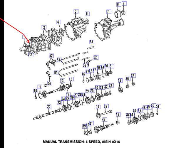

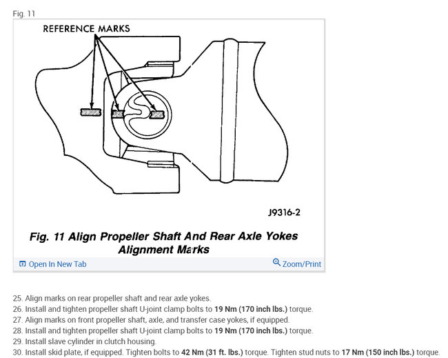

It is common for the front input shaft bearing to go out on these cars but to be sure can you please shoot a quick video with your phone so I can hear the noise? That way I can tell for sure what's going on. You can upload it here with your response. Also, I would check the transmission fluid level and change it out if it is dirty. This video will show you how, it is on a different car, but the procedure is the same.
https://youtu.be/WqDixYeqslI

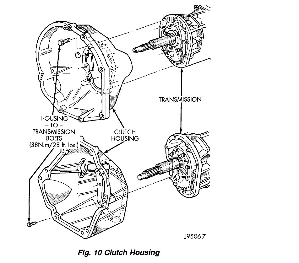

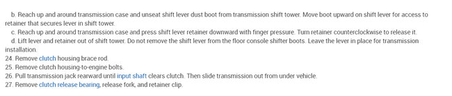

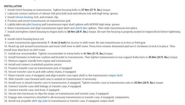

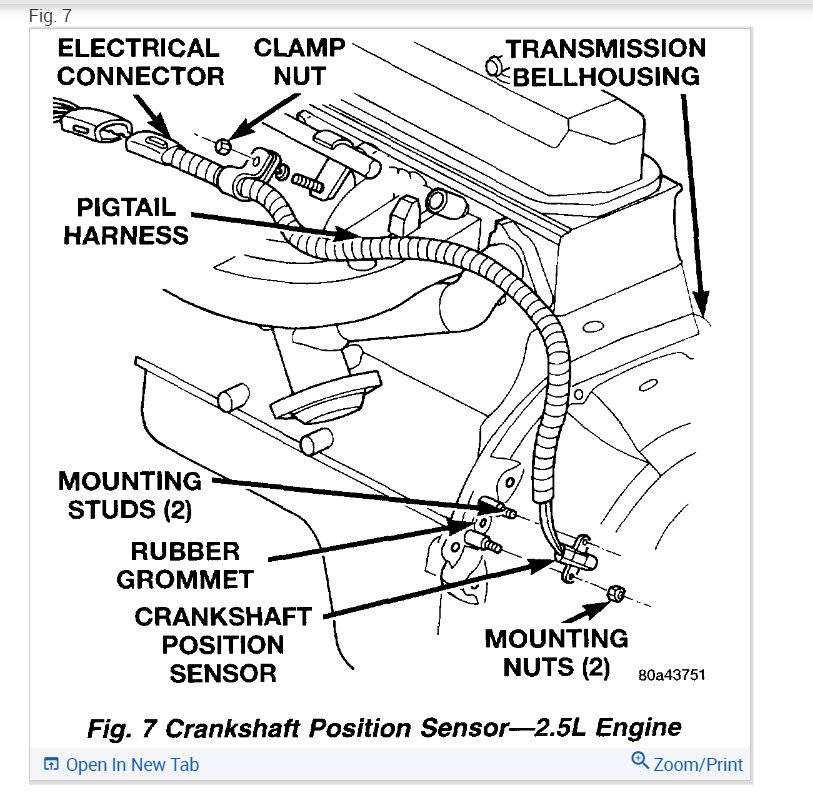

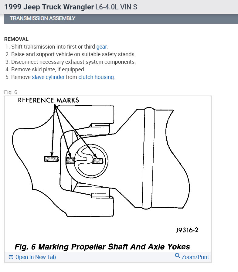

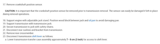

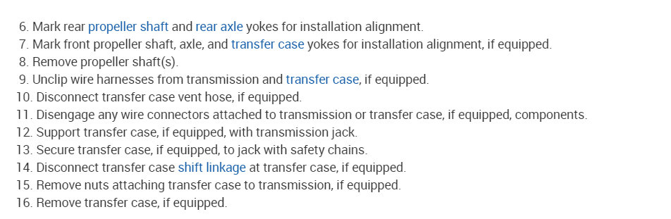

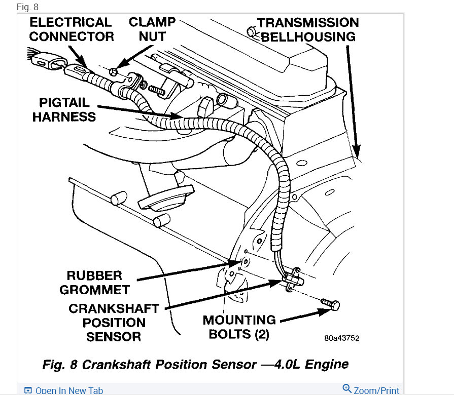

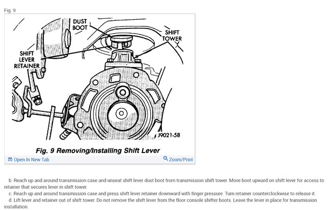

Here is how to remove the transmission and replace the bearing in the images below if after the fluid service the noise is still there. Check out the diagrams (below). Let us know what happens and please upload pictures or videos of the problem.

Thanks for the videos. Yep, I hear it, that sounds like a bearing is going out. The transmission must be removed, and the bearings replaced.
