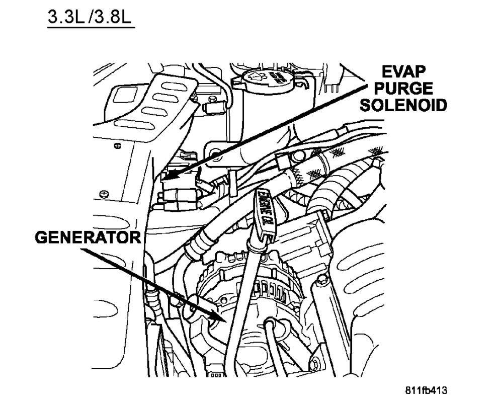

I thought the idler arm pulley was bad and then I broke a belt. I was told I needed a new alternator. so, I replaced both. Then I was told I only had one bolt holding in alternator. But I have this whining and belt grabbing. At first it quit after a few minutes, but now I keep feeling the steering belt grab when I turn the wheel. Is it because the alternator is moving out of place or something else?
Dec 23, 2021 at 2:01 PM
Good morning,
First, the alternator must have all bolts installed and torqued for the belt system to work properly.

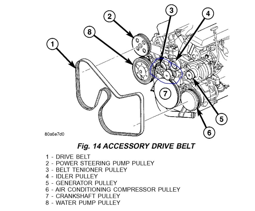

I attached the routing diagram for you below.
https://www.2carpros.com/articles/how-a-serpentine-belt-works

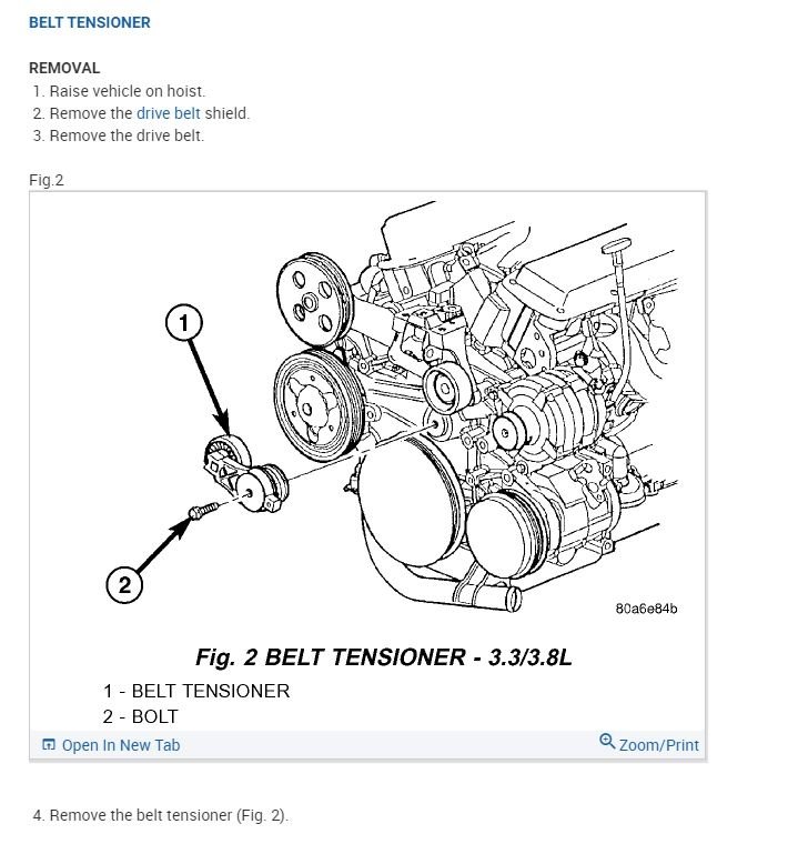

I would also replace the automatic tensioner, not just the pulley.
https://www.2carpros.com/articles/serpentine-belt-tensioner-replacement
