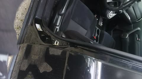

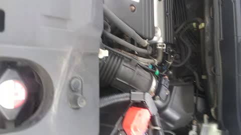

I had just put a new starter on my car and it drove fine for about 3 days. Then my husband came home one night turned it off and removed the key but the engine was still running, so he turned it back on and it made a loud grinding noise. Now when I try to start it it make a high pitched whine won't click or turn over.

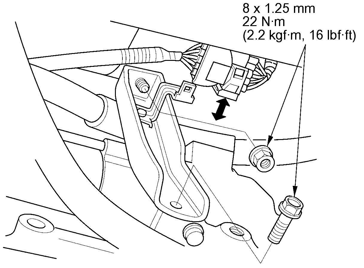

1. Do the battery terminal disconnection procedure .
2. Remove the front splash shield See: Splash Guard > Removal and Replacement > Front Splash Shield Replacement.

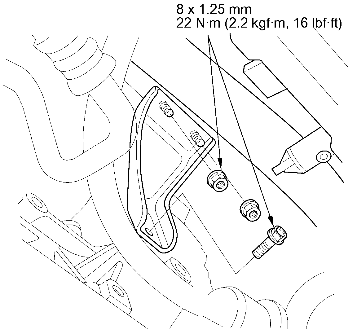

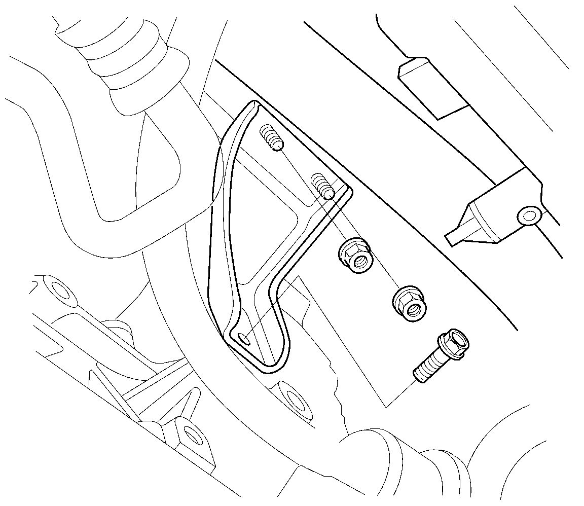

3. Remove the intake manifold bracket.
K24Z1 engine
pic 1

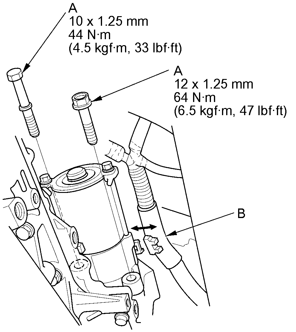

K24Z6 engine
pic 2
4. Disconnect the knock sensor connector.
- K24Z6 engine See: Knock Sensor > Removal and Replacement

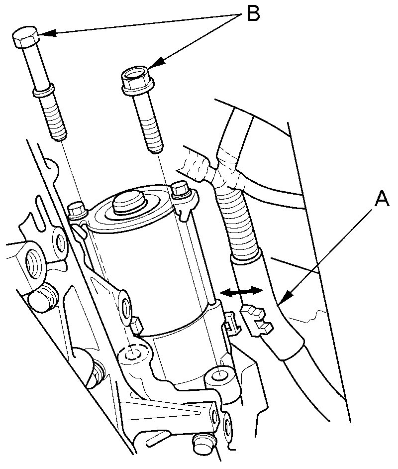

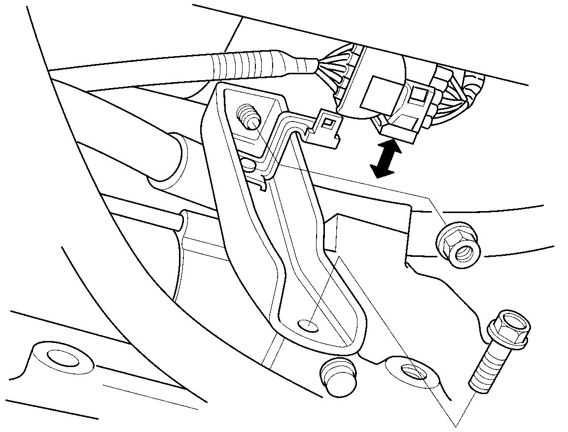

5. Remove the harness clamp (A), and remove the two bolts (B) securing the starter, then remove the starter from the engine.
pic 3

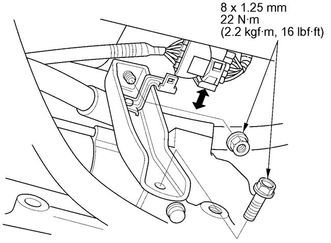

6. Disconnect the positive starter cable (A) from the B terminal, then disconnect the S terminal connector (B).
pic 4
7. Remove the harness clamp (C), then remove the starter.

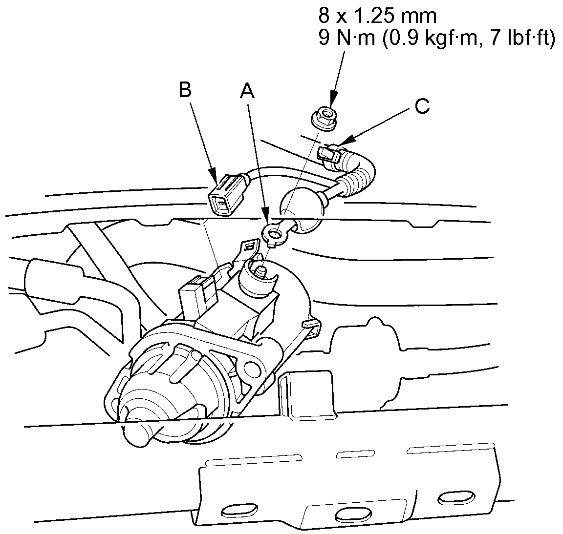

Installation

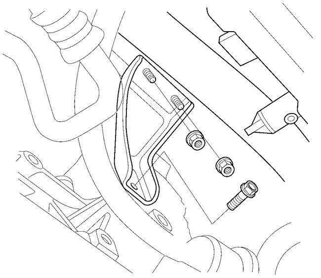

1. Connect the positive starter cable (A) and the S terminal connector (B). Make sure the positive starter cable crimped side of the ring terminal faces away from the starter when you connect it.
pic 5

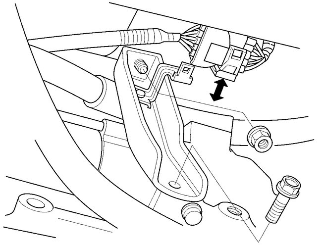

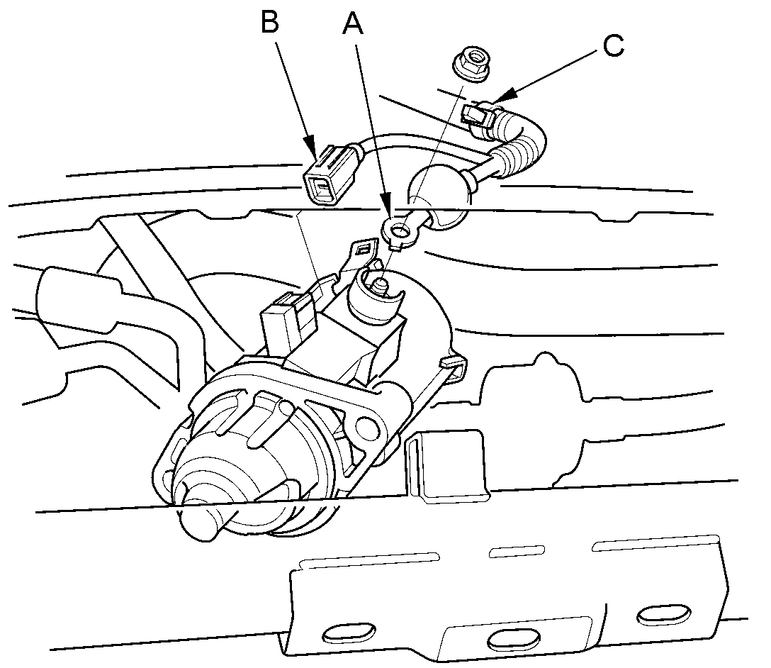

3. Install the starter, then tighten the two bolts (A), and then install the harness clamp (B).
pic 6
