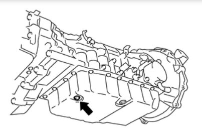

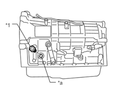

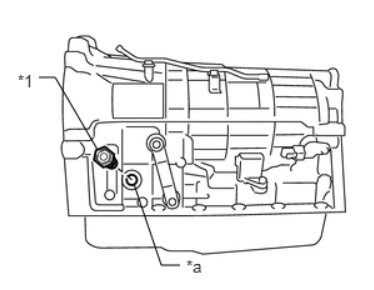

Unfortunately the car would only drive straight with this shaft out. If you turn it will barely move so i cant drive it at any speeds now. I saw evidence of some leak from the front case. I want to change the front case fluid. Am guessing that is called the front diff? And i wabt to change the transfer case by the transmission, so basically whatever the shafts connects to on both ends. Any instructions on drain and fill on these and the type of fluid plZ
Dec 20, 2025 at 6:06 AM
  • 55,065 POSTS
The transfer case does use ATF because it has clutches inside, I would change the fluid out. The transfer case does not have a separate stand-alone drain/fill procedure like a typical transfer case it shares the automatic transmission fluid (ATF) with the transmission itself. So service the transmission at the same time. ATF capacity for the AWD model is about 10 quarts. There is no separate drain/fill plug labeled specifically “transfer case.” Here are the drain and fill. Check out the images (below). Let us know how it goes

DIVIDES
  • 903 POSTS
Oh ok, I won't need to do it then, I would need to change the front diff fluid
Dec 21, 2025 at 5:21 AM
  • 55,065 POSTS
I would do the transmission fluid and diff fluid.
