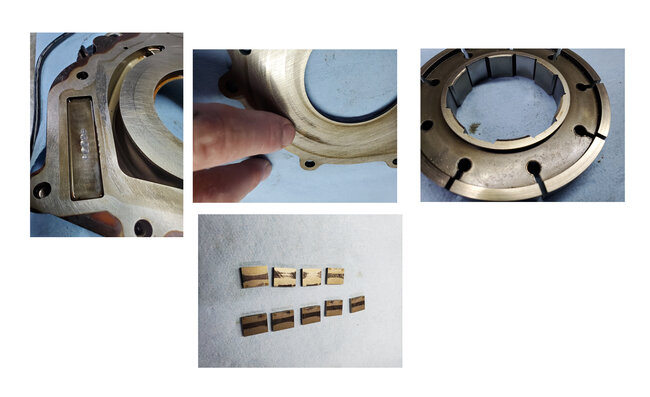

I do have the oil pump and all timing gears out. Here is a link to a google drive with photos and videos of the pump, tensioner, chain, crank sprocket and actuator. I found no wear on the crank sprocket spline or oil pump spline receiver that I could detect with a fingernail. There is a video "crank sprocket to oil pump rotor 2" which shows the fit between two two parts. I would guess a machinist would say "sliding clearance fit" about 1 thou over.
For the various pump wear marks, I could not catch my fingernail on any of them. The wear in the picture "oil pump pressure adjust spring" is interesting to note. I could not find any broken parts in the pump.
Here is the link to all the pics and videos: https://drive.google.com/drive/folders/1ziIZ0si_uYwt1Vn9obM7NbBE-gamIoCR

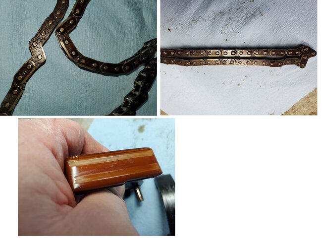

Also there are two videos showing the timing chain slack on the actuator and crank sprockets. "actuator chain slack" and "crank sprocket chain slack 2"
The pictures "timing chain wear" and "timing chain wear 2" show some wear on one side of the chain that corresponds to the guide of the tensioner "tensioner guide"

Picture of timing chain wear.
Jan 5, 2025 at 6:04 AM
SHADOWMECH23
  • 17 POSTS
Crank sprocket to oil pump rotor fitment.
Jan 5, 2025 at 6:06 AM
SHADOWMECH23
  • 17 POSTS
The oil pump.

Video showing chain slack on actuator.
Jan 5, 2025 at 6:13 AM

I did not see any broken parts in the pump. Anything special I should look for?
Jan 5, 2025 at 6:14 AM
  • 55,846 POSTS
I think you found it with the loose gear on the crank sprocket to oil pump rotor fitment. Nice work. Also, change the oil and filter that should fix it.
