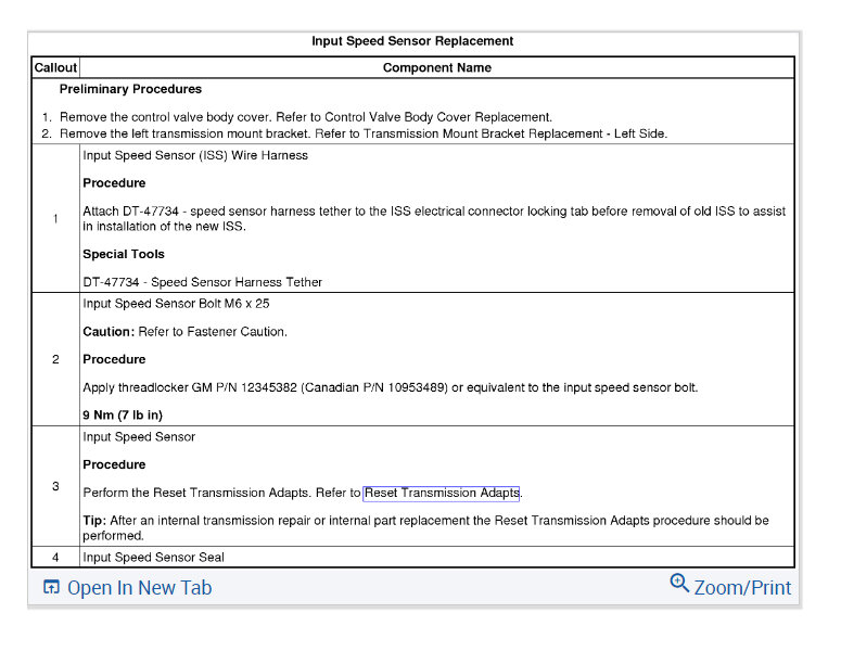

While driving at a constant speed the car pulses?
152,000 MILES • 2WD • AUTOMATIC
ANNA CUMMINS
It feels like the transmission is slipping, but I recently had it rebuilt. the tachometer does move slightly when it does this. It does not do this when accelerating or coasting, just when going as a constant speed.
Car has been serviced regularly.

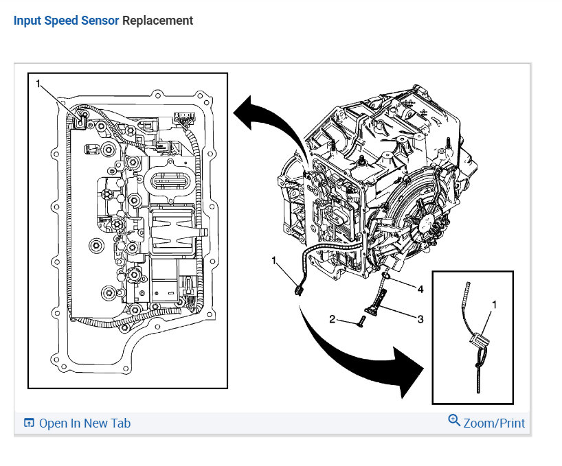

It sounds like the input shaft speed sensor inside the transmission is not working correctly. We should run the codes though to see what comes up.
Here is the location of the sensor so you can see what I am talking about. Check out the images (below). Let us know what happens and please upload pictures or videos of the problem.
