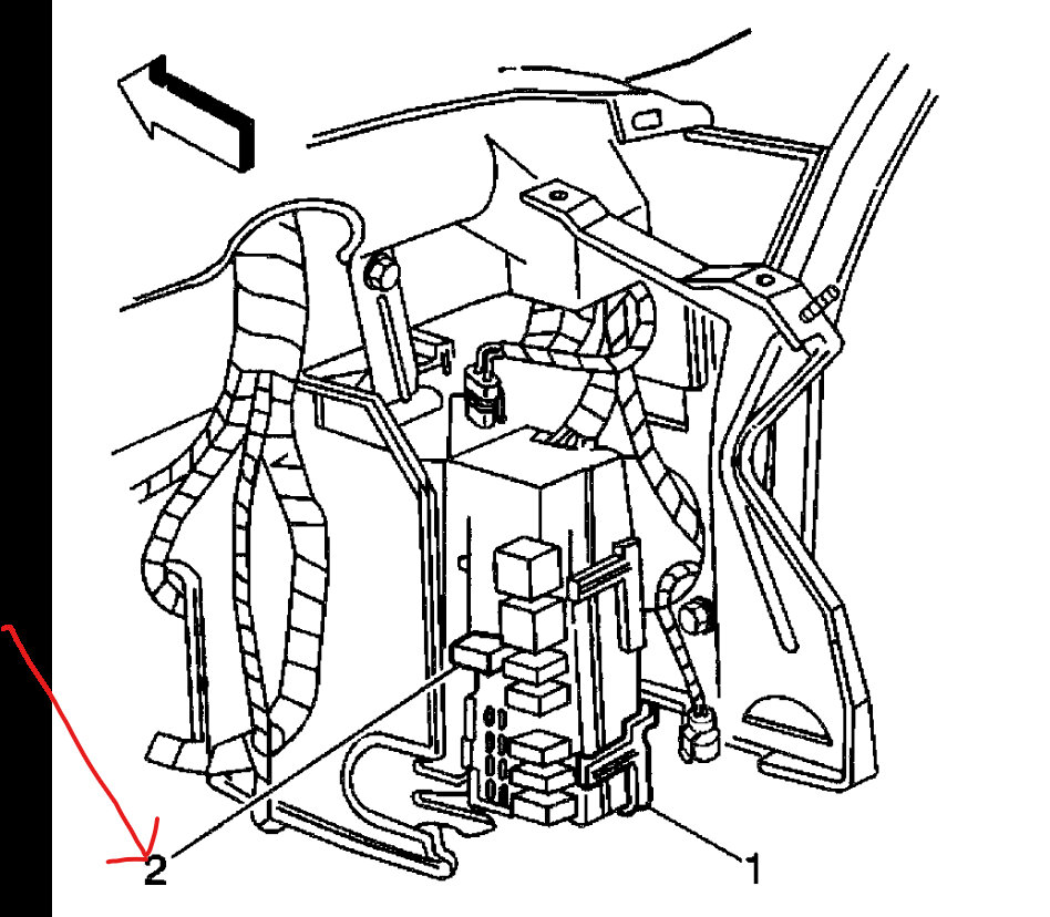

Which relay is the fuel pump relay?
1999 PONTIAC BONNEVILLE
255,300 MILES • V6 • AUTOMATIC
LSELBY1026
Going in the direction from passenger side to driver side. I can't find a diagram of my under-hood fuse and relay for my car listed aboe. Please help.
Aug 3, 2023 at 9:57 AM
  • 54,840 POSTS
The fuel pump relay is under the dash on the passenger's side. Here is a guide to help you test it with the location of the relay in the images below:
Check out the images (below). Please let us know if you need anything else to get the problem fixed.
