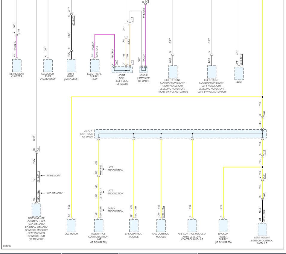

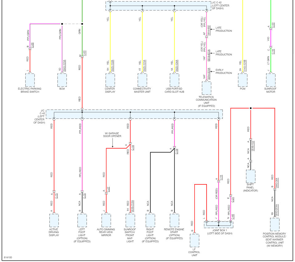

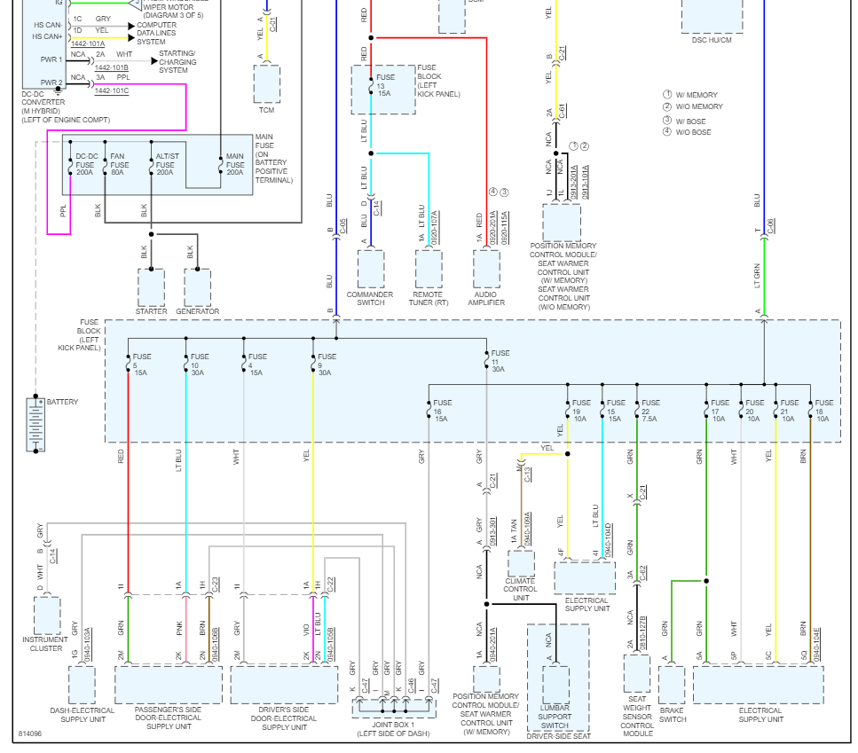

I was looking at hardwiring a dashcam, but I want to make sure I pick the right fuses. I have to first check which ones have constant power (parking mode) but first wanted to check if I can even use any of these near the passenger side or am I forced to use the ones in engine bay (safety wise). https://www.mazdausa.com/static/manuals/2023/mazda3/contents/07031600.html?kw=FUSE%20BOX&hw=FUSE%E3%80%80BOX
Thanks for any advice.
May 28, 2023 at 5:49 AM
  • 55,433 POSTS

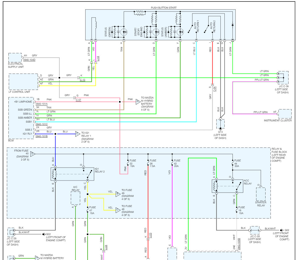

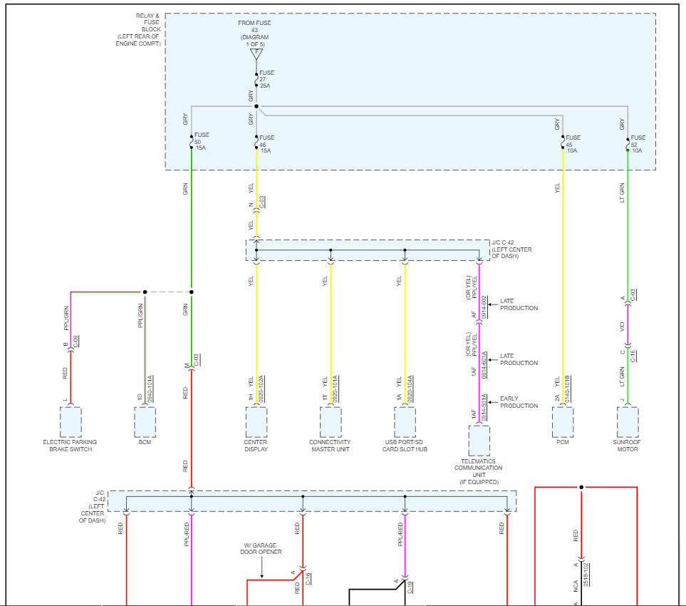

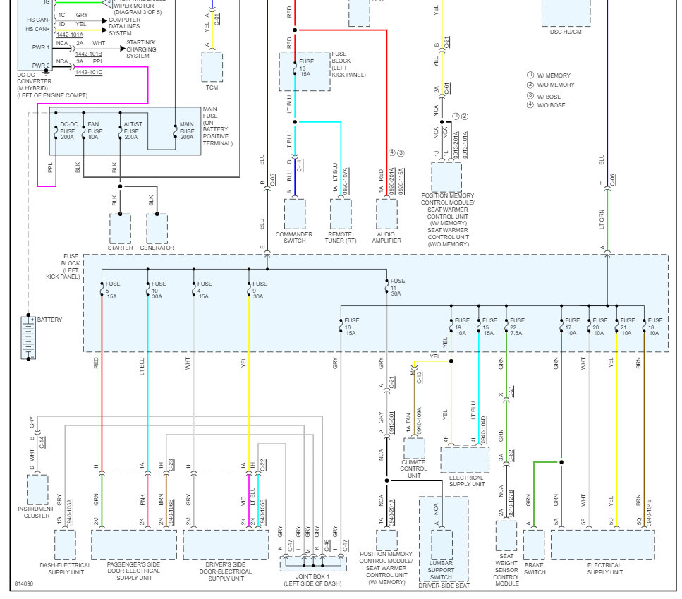

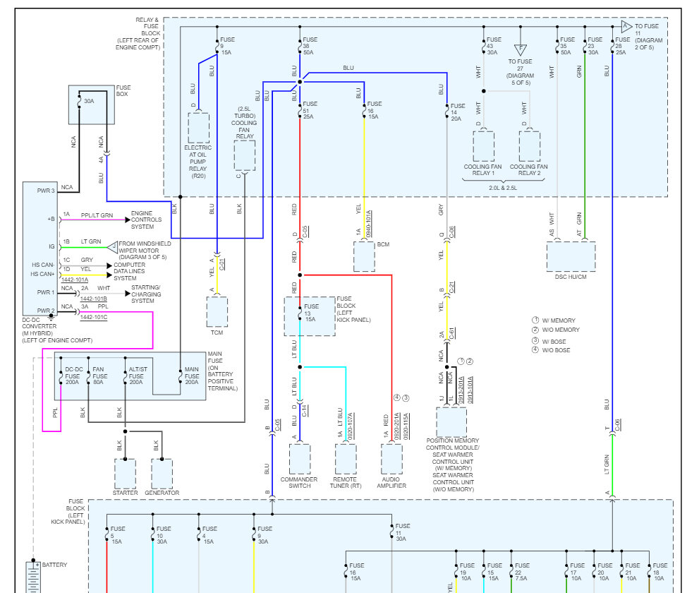

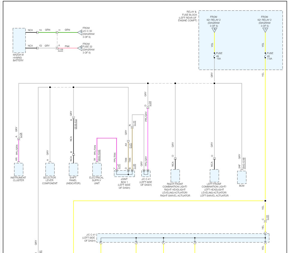

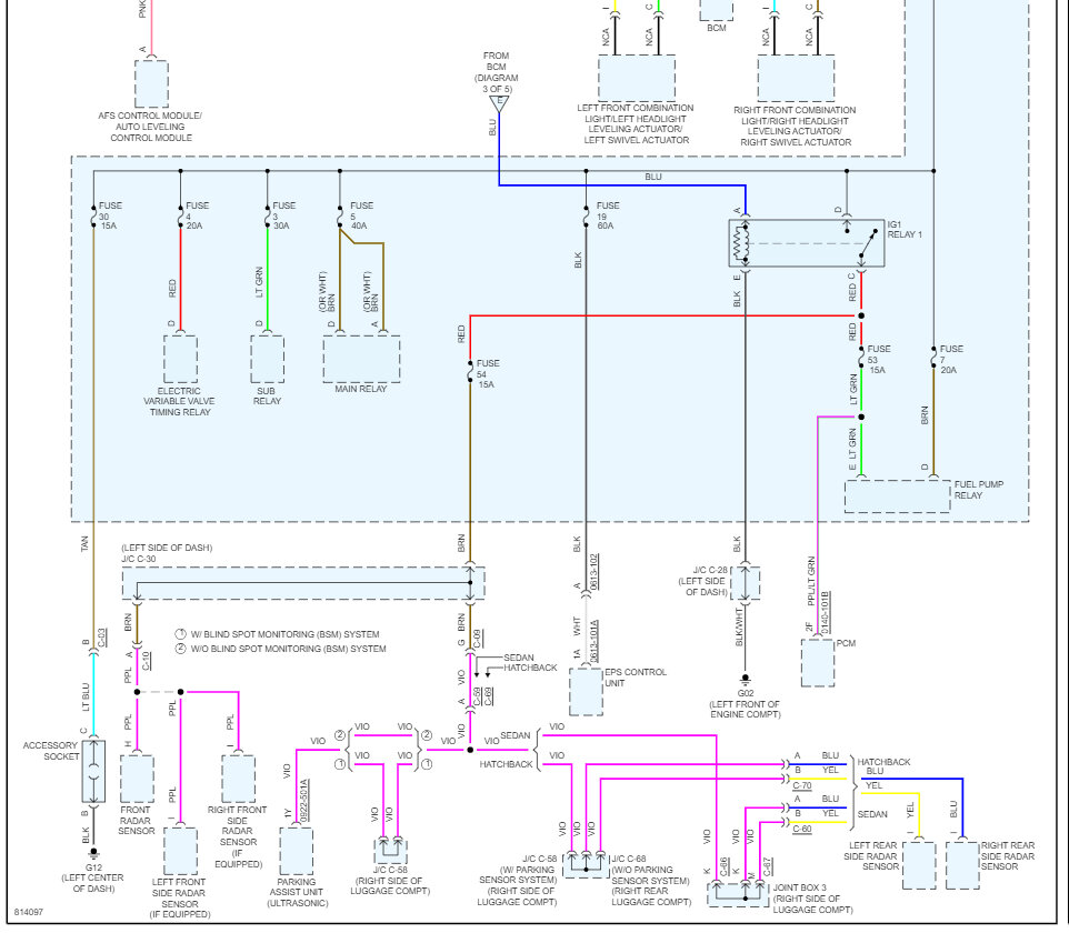

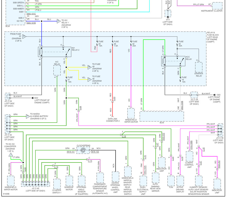

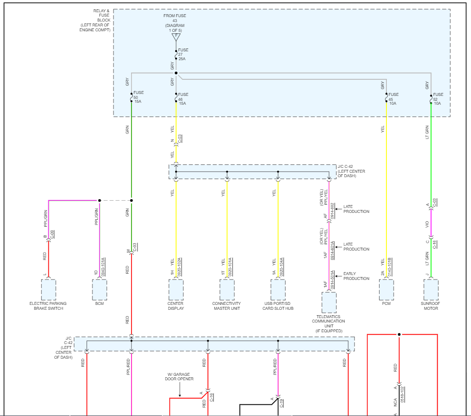

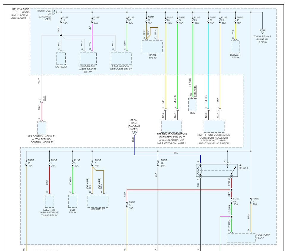

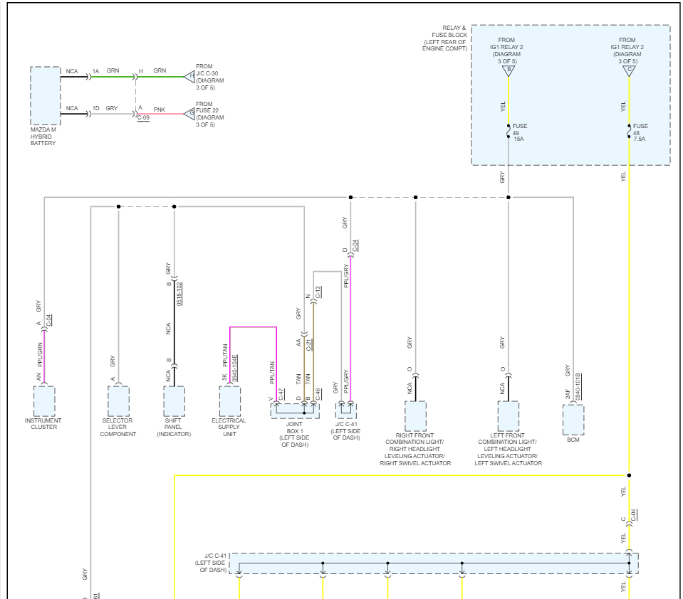

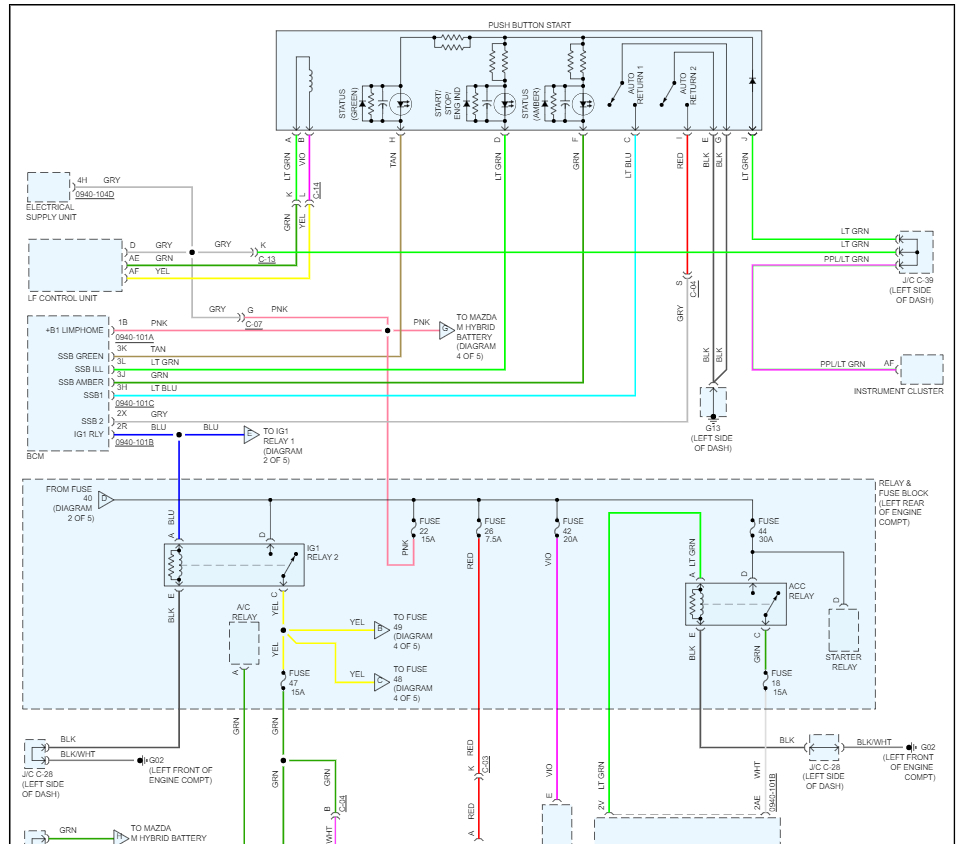

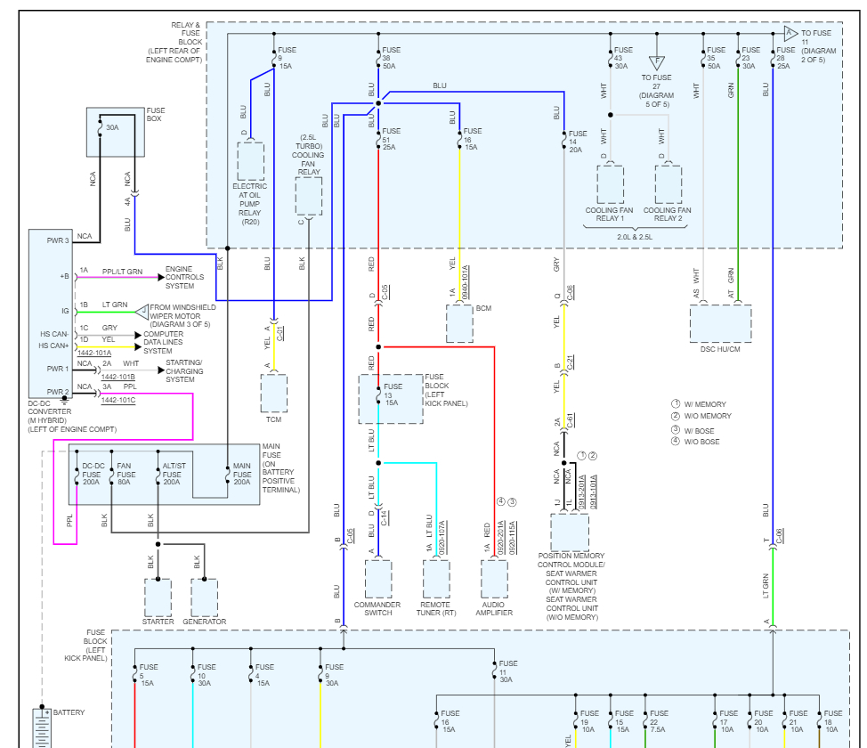

Here are the power distribution wiring diagrams so you can see which fuses have constant power and which ones are switched. This guide can help as well:
