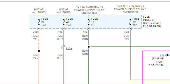

Both fans work and blow air and the refrigerant is topped off, but the air doesn't get cool.
I'd like to check the fuse(s) but VW doesn't release their fuse box diagrams.

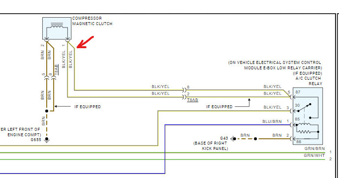

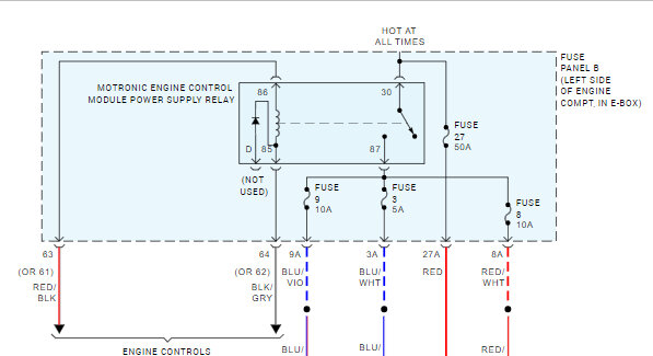

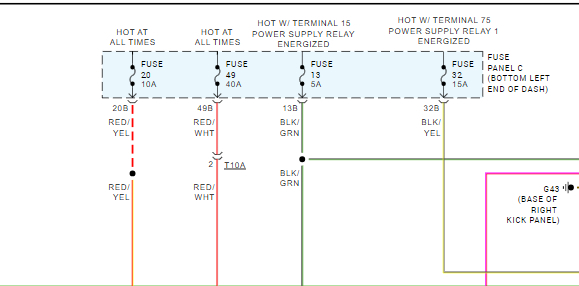

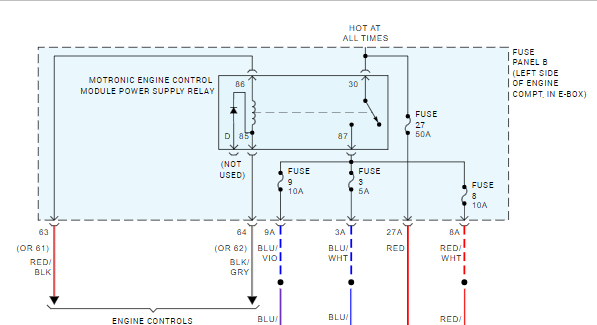

Sure, here are the fuses that run the system and a guide to help test them for power.
Also, I would check for power at the compressor wire when the system is on blk/yel wire. Please check the fuses in the images below. Please let us know what happens.
