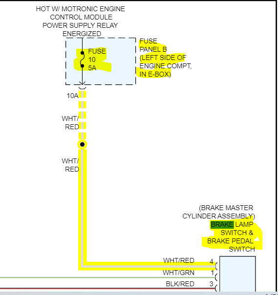

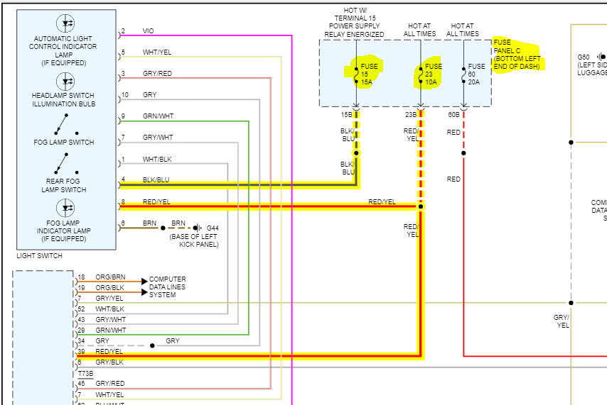

I have an image of my internal fuse box, but I’ve looked at every list possible and no lists show me which fuse is responsible for turn signals and brake lights specifically!! Please help.
Oct 8, 2022 at 3:14 PM
  • 110,244 POSTS
I attached the wiring schematics below showing the fuses. In pic 1, see fuse 10 in fuse panel B. In pic 2, fuses 15 and 23 are for the signals and fog lights. Note that power from these fuses is sent to the electrical control module behind fuse panel C. From there, it is sent to the component. Let me know if this helps.
