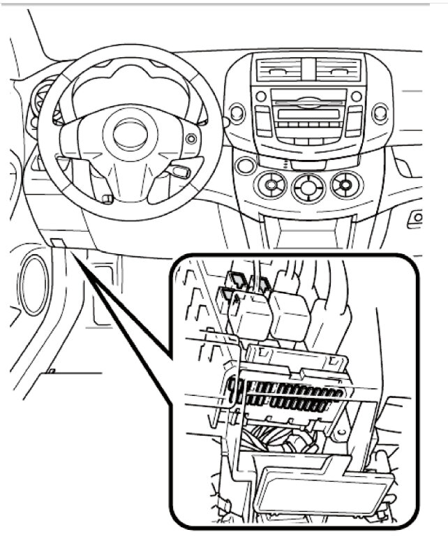

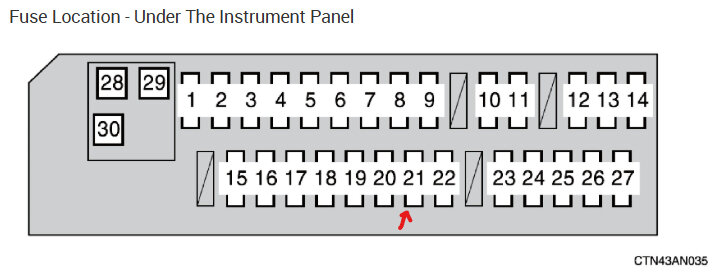

which fuse for the OBD2 data port?
150,000 MILES • 3.5L • 6 CYL • 4WD • AUTOMATIC
BRUTOO61
Vehicle OBD system is unresponsive. ECU fuse powers OBD system. The fuse is good and everything is working. Which port on the OBD plug is supposed to be hot?
Dec 10, 2024 at 10:24 PM
  • 55,647 POSTS
The two brown wires on the connector are ground so I would check those along with the power source. This guide can help you check the power and ground connections. Also, check for power at the OBD fuse 7.5 amp. The blue wire in the connector is power.
Also, check the code reader on another car to make sure it works. Check out the images (below). Let us know how it goes.

Everything checked out okay after cleaning the connector with an electrical cleaner.
