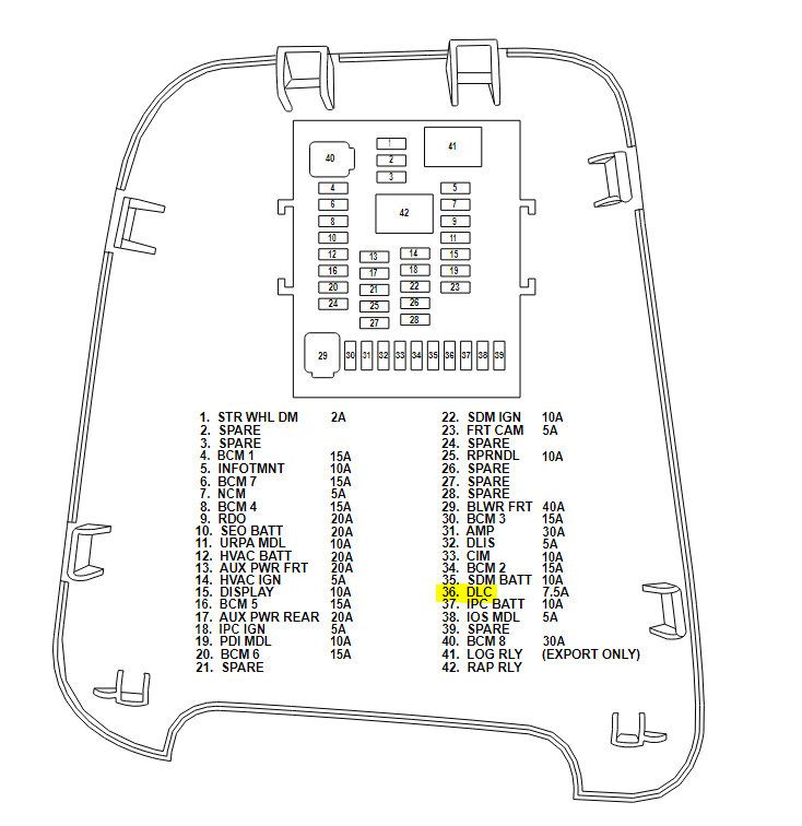

Engine light on but no power at the port.

Check the fuse box under the dash on the passenger side left kick panel/side of the center console.
It is a number 36 fuse; it should be a 7.5A.
See diagram below.
Let me know of any questions.
