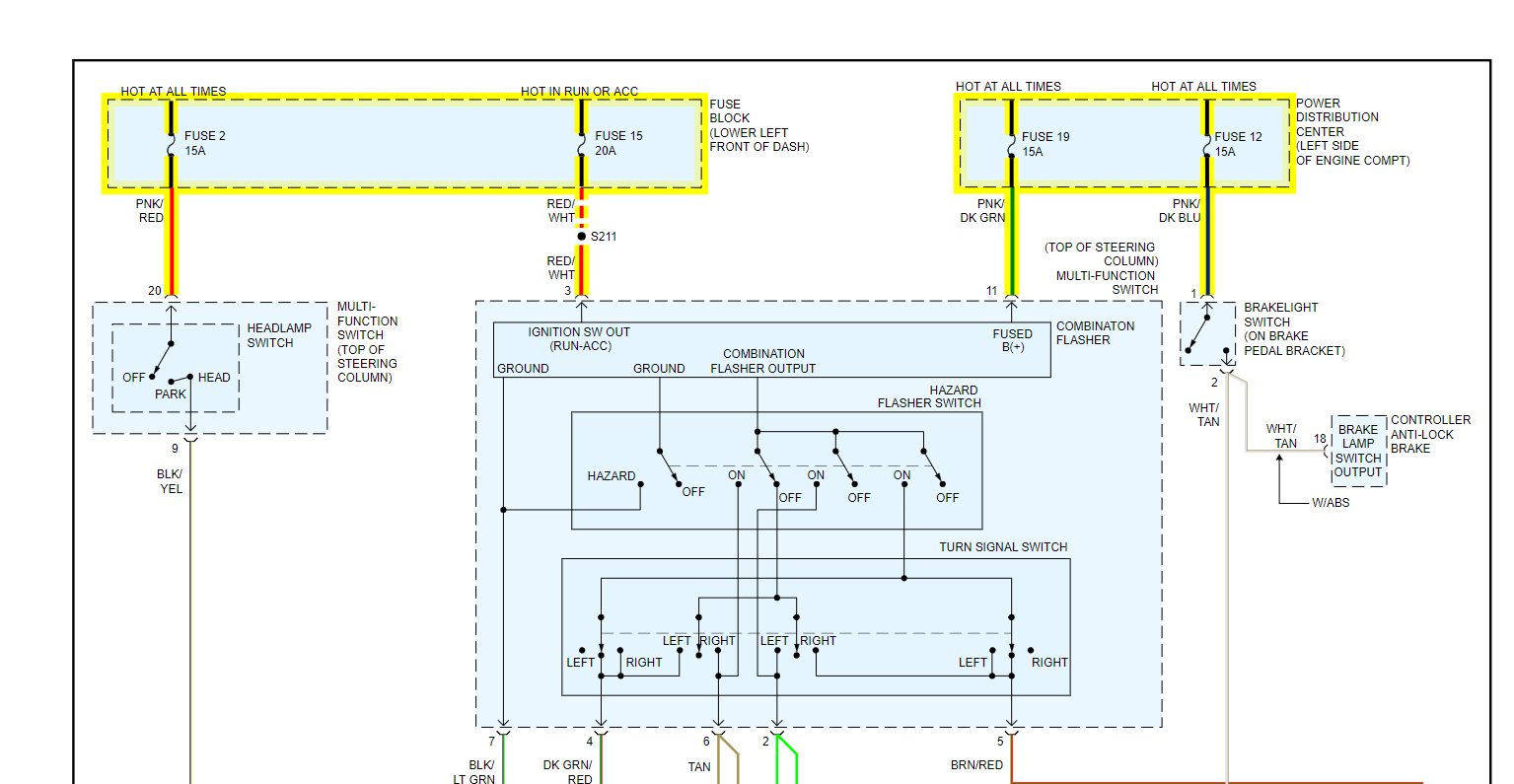

Both taillights and the instrument lights went out suddenly and not working. I can't seem to figure out which fuses are not working.
Sep 2, 2020 at 1:35 PM
Good evening,
I attached the diagram for the fuses for you to test. They are marked by number for you to match in the fuse blocks.
