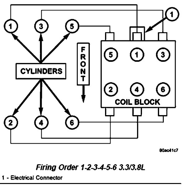

Which cylinder is cylinder number 2?
2005 CHRYSLER TOWN AND COUNTRY
300,000 MILES • 3.3L • V6
CURTIS MARTINEK
I'm wondering if I could get the schematic with the cylinders numbered in reference to their firing order?
Jan 21, 2023 at 3:22 PM
CARADIODOC
  • 34,321 POSTS
This is the same for the 3.3L and 3.8L engines.
