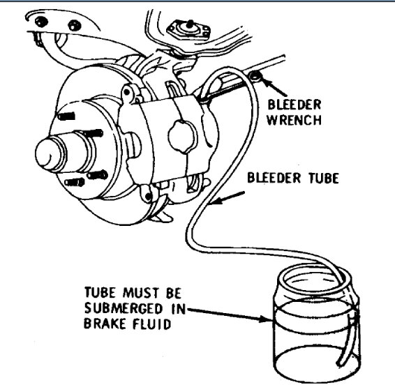

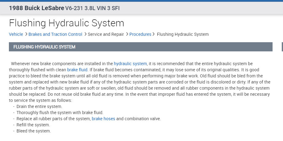

How dirty is the transmission fluid? If it is dark and has a burnt odor, leave it alone. On the other hand, if it still has a redish color and no smell, you will be fine changing it.
I'm still old school. I prefer removing the pan so I can also replace the filter and gasket. Many people have gone to a total flush for the transmission. However, that doesn't replace the filter or gasket.
As far as the brakes are concerned, it certainly won't hurt to flush the fluid. Here again, that has become a new selling idea over the past 20 years. My 1978 C10 has never been touched and it still works fine. LOL
If you want to flush the brakes, we don't have a link for it. However, I attached the manufacturer's directions below.

The OEM method described above is what I usually have done with other cars, but I was not sure it cleared all the old fluid from the system.
Apparently, it does.

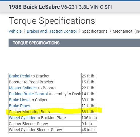

Here is a question from watching videos from a variety of sources about changing the front brake rotors and pads. The mechanics involved in the videos gave different torque specs on securing the two front brake pad frame bolts.
One mechanic said to use 75 FtLbs, but the other said 50 FtLbs. How could that happen, when the OEM spec does not vary ?

Are you referring to the caliper to the caliper mount or the caliper mount to the steering knuckle?

This video specifies a torque value of 75 FtLb:
https://www.1aauto.com/how-to-replace-front-brakes-1997-2005-buick-century/video/45543
The mechanic refers to the mount secured by the bolts as a "pad bracket" (at 3:08), and at 4:36, says he will torque its bolts to 75 FtLb.

  • 110,240 POSTS
The caliper itself mounts on the caliper mount. That is the only torque specification I have. See below. As far as the caliper mount to the steering knuckle, 75 ft/lbs sounds right.
See pic below.

Thanks for clarifying the correct values on this operation, Joe.

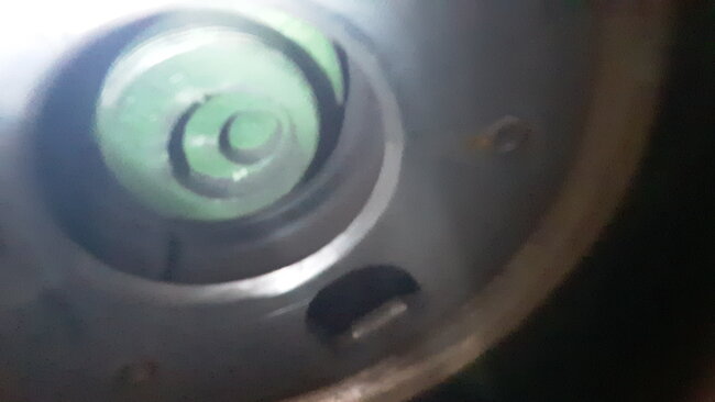

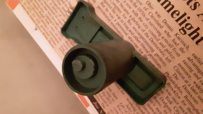

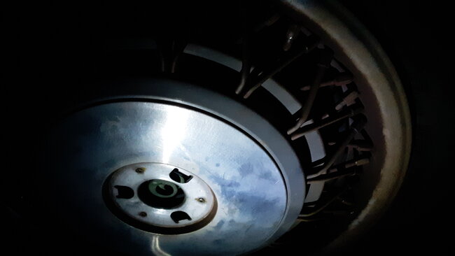

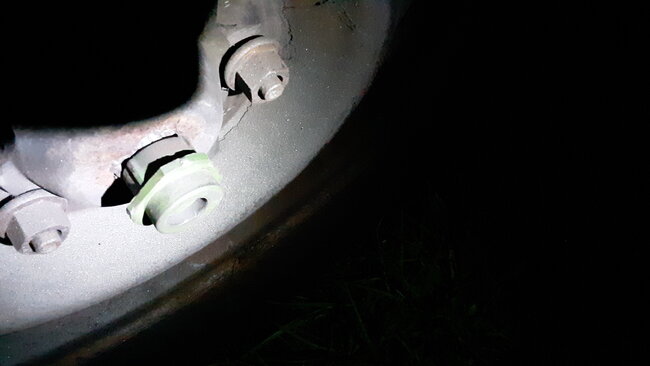

Joe,
I hesitated to ask you another question, because I already have posted the question for general pickup (not wanting to overburden you). But after two days, no one has picked up the question below--
Working with the car listed above, I was all set to remove the wire wheel cover from both front wheels and begin the operation.
Using the special Buick tool to remove the cover, I had no problem with the passenger side wheel. But when I moved to the driver's side, the tool did not seat itself properly, and the does not move all the way inside the tool channel, for some reason. (see photo, below, of Buick OEM removal tool)
Of course, I made sure the raised post on the tool was exactly positioned over the cover's tool channel pilot hole before attempting to un-thread the plastic nut.
Because the tool kept slipping out of the hole, I halted operations until I had a better way to remove the driver side wheel cover's plastic nut.
Any suggestions on how to use the GM tool on a wheel cover whose tool channel does not permit me to seat the tool properly?
(To loosen the plastic cover assembly nut, I have sprayed the area with isopropyl alcohol, hoping it would penetrate the plastic nut threads. Liquid Wrench may work, but both the wheel nut and its threaded hub are of nylon, so I am not sure that would help.)
Photos are attached (from left to right)--
Photo 1-- shows plastic wheel cover unlocking tool. Note raised post on off-center/eccentric tool shaft.
Photo 2-- shows overall wheel cover assembly
Photo 3-- shows wheel cover assembly, with shaft for insertion of wheel cover tool. Note the shaft has the same off-center/eccentric shape to match the tool.
Photo 4-- shows nylon/plastic nut to fasten the plastic wheel cover assembly. This nut was removed successfully from the passenger front side but was re-threaded to show nut dimensions.
Removal of the driver side nut is the current problem, because the removal tool does not enter fully into the tool hole and slips out. I risk tool deformation if I continue to apply greater force to the tool.
Sep 21, 2023 at 2:55 AM

I finally un-threaded the plastic nut fastening the wheel cover. The green plastic security tool (photo 1, above) is designed supposedly to prevent theft of Buick / GM "wire" wheel covers, but effectively prevents the owner from tire maintenance / repair, and access to the front brakes.
The plastic wrench is not particularly sturdy, and stripping its tiny plastic post could prevent roadside tire replacement. Do you know of a sturdy metal equivalent to the GM wheel cover wrench?

LOL no problem whatsoever. Normally, we try to keep the threads specific to one topic. That way, they are more helpful to others.
So, since you already reposted, here is what I can tell you. The probability of finding a steel one is slim. Check to see if there is a part number on the original one and Google search it. If you are unable to find one, do this. When reinstalling the hubcap, first clean the threaded area on the bolt and the hubcap. Then, use anti-seize on the bolt's threads. Snug the hubcap enough to prevent it from coming loose, but don't overtighten it.
If you do this, the plastic one should do the job for a long time. If, on the other hand, it becomes corroded, it may break.
