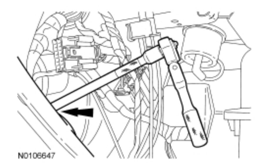

Try changing modes and temperature. when you do those commands, the actuator should change pitch or stop until the actuator has settled.

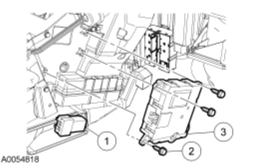

the blend door actuator for the right side is right there. I attached the procedure for you to view.
412-01 Climate Control 2010 Explorer, Mountaineer, Explorer Sport Trac
REMOVAL AND INSTALLATION
Temperature Blend Door Actuator — RH, EATC
Item Part Number Description
1 RH temperature blend door actuator electrical connector (part of 14401)
2 W701696 RH temperature blend door actuator screw (3 required)
3 19E616 RH temperature blend door actuator
Removal and Installation
Remove the RH floor console finish panel.
Lower the glove compartment.
Disconnect the RH temperature blend door actuator electrical connector.
NOTE: The upper RH temperature blend door actuator screw can be removed using a shallow 1/4-inch drive swivel-type socket and extension.
Working through the glove compartment opening, remove the upper RH temperature blend door actuator screw.
Remove the 2 remaining RH temperature blend door actuator screws.
Remove the RH temperature blend door actuator.
To install, reverse the removal procedure.

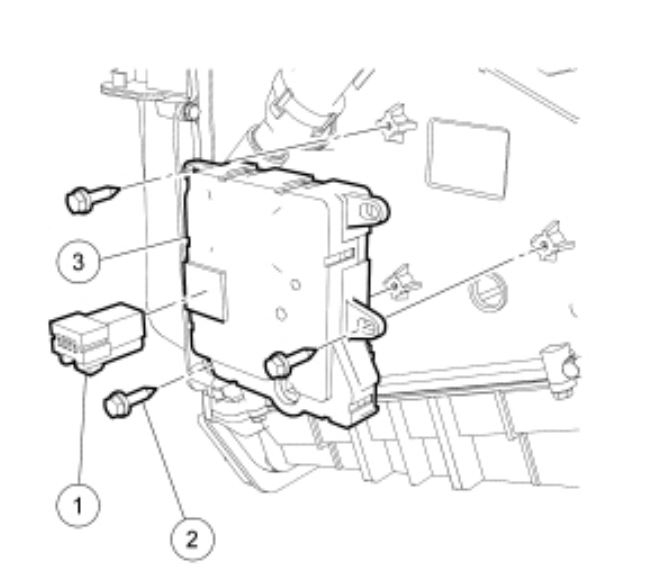

Do you have pictures on how to change the LH side as well? I tested temperature on dual and definitely the right one is making a lot of noise. But, there was another noise higher in the dash on the LH side as well. Might as well change that one at the same time.
Apr 20, 2020 at 7:26 AM

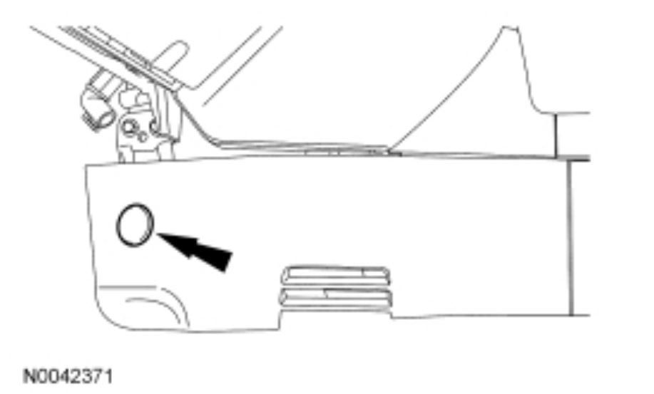

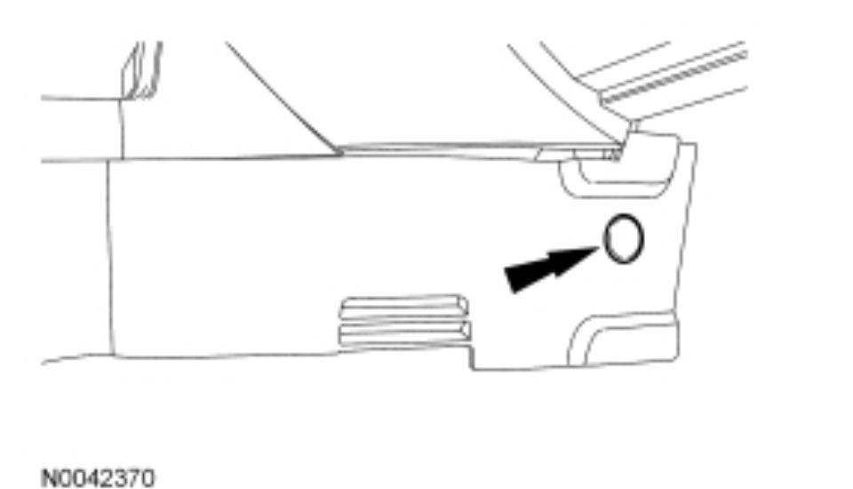

The procedure and pictures are below.
Remove the LH floor console finish panel.
Position the in-vehicle temperature sensor aspirator hose away from the LH temperature blend door actuator.
Remove the 3 LH temperature blend door actuator screws.
Disconnect the LH temperature blend door actuator electrical connector.
Remove the LH temperature blend door actuator.
