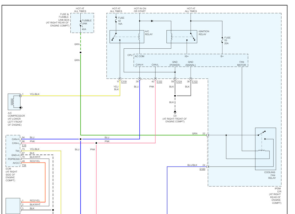

Where is the fuse for the A/C compressor clutch located?
2007 NISSAN TITAN
1,000,000 MILES
JOSEPH PAPPAGALLO
Can't find A/C clutch fuse?
Jun 23, 2023 at 12:10 AM
  • 55,433 POSTS

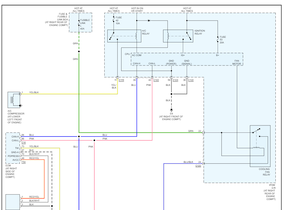

It is fuse# 42 in the IPDM which is located in the engine compartment at the right rear. Here is a guide to help check it for power and the wiring diagrams so you can see how the system works. There is a relay as well. If the fuse and relay are okay check for power at the clutch because the clutch coil may be bad.
Check out the images (below). Please let us know if you need anything else to get the problem fixed.
