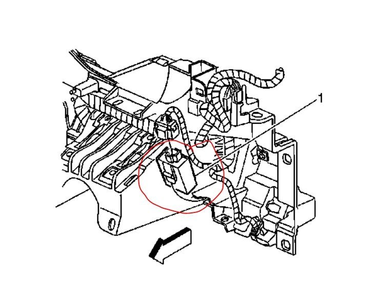

Where is the flasher relay located on my car?
2006 BUICK LUCERNE
200,000 MILES • 3.8L • V6 • 2WD • AUTOMATIC
GHOSTIE2477
Car listed above is the CXL model. Can't find flasher relay.

Good morning,
At the end of the instrument panel, there is a closeout panel you can open. Open the panel and relay is there.
I attached a picture for you of the location.
HAZARD AND TURN SIGNAL FLASHER REPLACEMENT
REMOVAL PROCEDURE
1. Remove the left closeout/insulator panel.
2. Remove the turn/hazard flasher module (1).
3. Disconnect the electrical connector.
