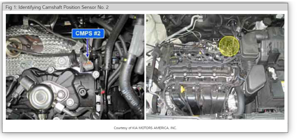

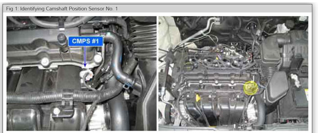

Where is the camshaft bank 1 and bank 2 located in my vehicle listed above LX model?
Apr 20, 2023 at 11:58 AM
  • 110,194 POSTS
The idea of the term bank only indicates different sides of the engine. As far as a 4-cylinder engine is concerned, there is only one bank. With that in mind, I suspect you are referring to the camshaft position sensors.
If that is the case, I attached two pics below showing the locations. Take a look through them and let me know if they help.
If it is something different, let me know.
