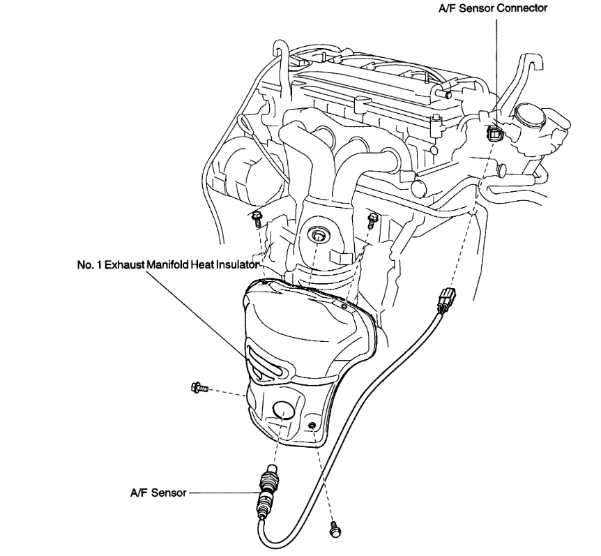

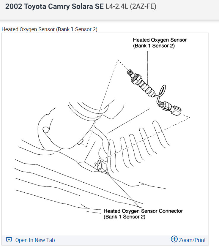

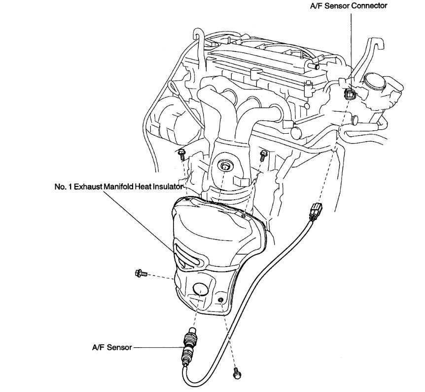

Where is the bank 1 sensor 2 o2 location? I want to replace.
May 29, 2017 at 4:37 AM
  • 55,433 POSTS
The bank 1 sensor 2 is the oxygen sensor just behind the catalytic converter. Here is a guide to help you step by step and the oxygen sensor locations in the images below.
https://www.2carpros.com/articles/how-to-replace-an-oxygen-sensor
Check out the images (below). Let us know if you need anything else.

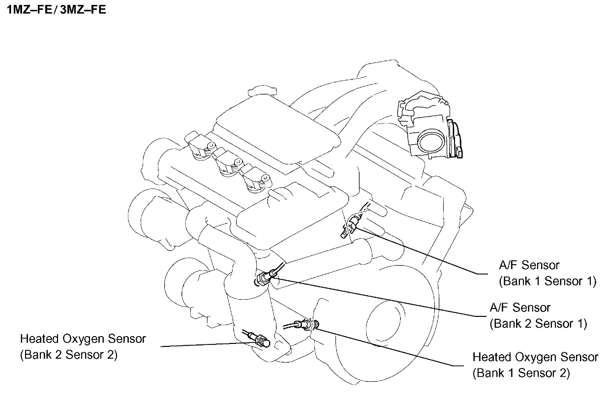

Some Toyotas have 6 cylinders... That means there are two O2 sensors under the car.
Aug 29, 2024 at 5:04 AM
  • 55,433 POSTS
Correct, here are the sensor locations for the v6 engine, they are not quite under the car. Check out the images (below).
