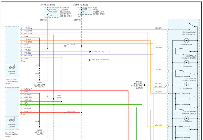

There is a 30A circuit breaker and a 15A fuse for the power window operations.
They are located in the fuse box on the left side of the dash. Should be number 37 and 38.
